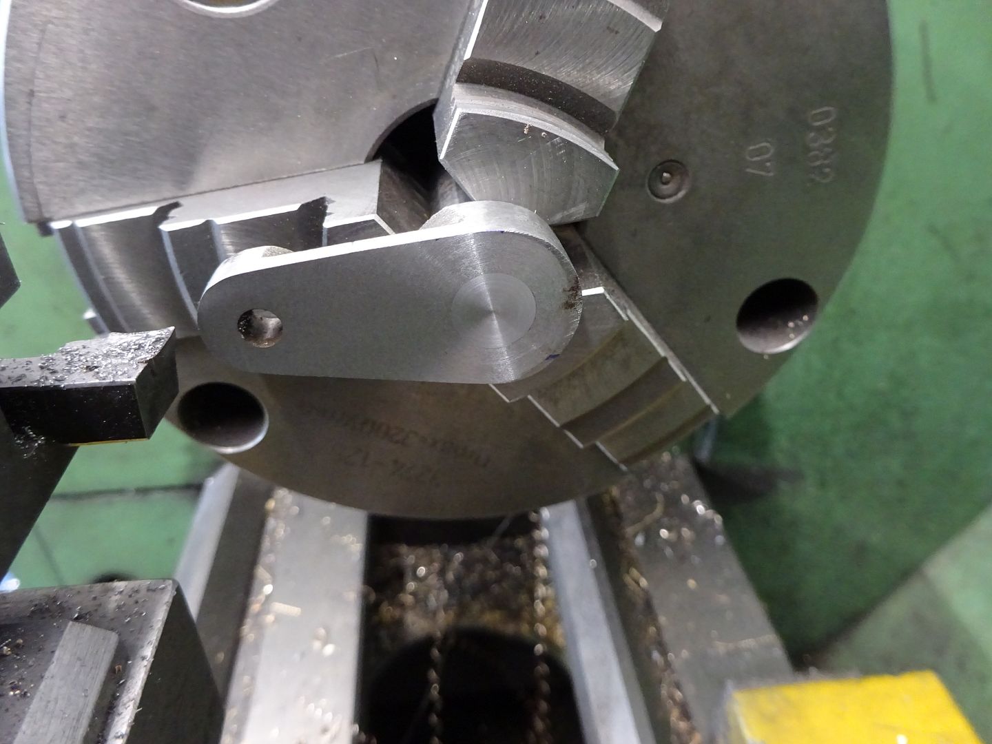

I think Ramon's advice about ensuring parallelism between the crankshaft pin and cross head pin is spot on and is probably the cause of a small knock I have on my Corliss which instinctively makes you think is bearing clearances somewhere but I cannot find any. I need to think of a way to check the alignment with my limited equipment.

Without pulling the engine apart too much you could slip the cross head pin out and move the cross head by hand so the small end is not in the slot. compare where the little end is at TDC and BDC to see if there is any sideways difference.
With that type of crankshaft the fit of the crank onto the shaft can make a lot of difference as if the flat face of the crank is off then the pin's axis will be too so I always like to make the crank a bit thicker and then assemble onto the shaft before taking a final skim to get the face true to the shaft's axis.
The MEM plans just call for a 3/8" hole and 3/8" MS shaft. any slop in this will affect how true the web is to the shaft, really needs the hole boring to fit the actual not nominal size of the shaft. Also relieve the base of the thread or hole so the pin screws right in and sits flat, true thread goes without saying.
The Victoria that I made recently was a good example, it was part made when I got it with crank fitted and pinned to shaft but the crank was at an angle, this picture shows it with 12thou already taken off and you can just see there is still a little more to go so that is something like 15thou over 1.5". As the pin is screwed down to that surface the rod will therefor also be running at a similar angle so that's more like 0.060" over the rods 6" length which equates to a lot of sideways movement at the little end. If your chuck is not good use a collet or split bush so shaft is as true as possible.

Thank you Jason, good advice about machining the crank and pin, I will follow your sequence for my new build and I will take a lot more care with the alignments.
