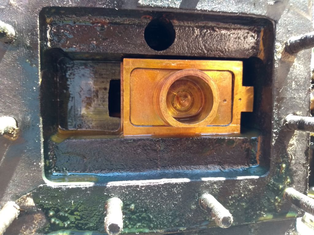

I try to explain what you want to know. I made a picture of Juergens valve gear and there is to see that the valve steam channels are casted. The blue side movement from chimney to gear or the rhs in the diagram is not very accurate. The shape is not with straight cut as it is achieveable if it is milled. img_20210611_145236087.jpg
For my opinion is this the reason in combination with some marks on the valve running surface that there is in this area the valve is not perfect steam thight.
The steam channel on the gear side is more accurate and straight. But in the picture it is not very good to see.
And there are many marks on the surface too.

When I look in old books i found that from 90 to 100 mm piston displacement the blue curve comes up and the reason is that the steam port to the chimney is closed and there is some compression. Therefore at about 100 mm there is then steam comming in and this cause in a slope, because steam pressure is lower then the compression pressure at this moment of opening the valve. To make this perfect the valve have to be a litlle bit machined in the inside to allow the steam to come earlier to the chimney. If green where mirrored as a blue curve this will be better.
If we look to the curve in the old book there is an example which is discribed with too late admission.
Juergen made the excenter settings with not very good explanations in the plan, as he told me. He had to interpretate some dimensions. And it was clear he had to decide to screw down the excenter after his measured dimensions. I think the result, after this possibility of possible mistakes, is very good.
Juergen want not to change anything in the beginning, he was satisfied with what he had achieved. As I show him which i achieved with my little loco Plettenberg with the first tests of the electronic cylinder indication setup, he gave me a try. I made then some attachements for the rope displacement sensor and the electronic.
