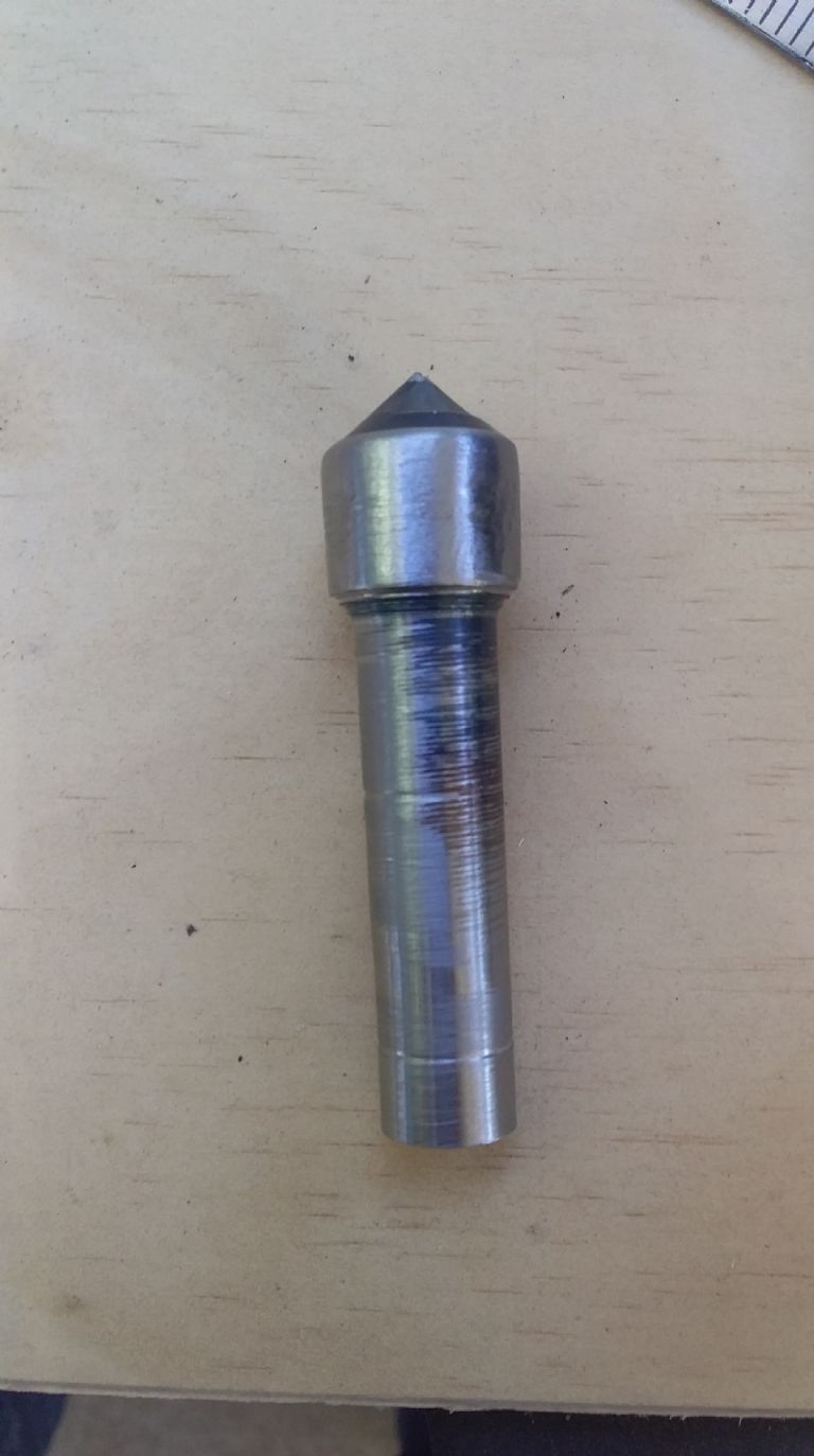

Hey all,
Im a complete beginner from Australia who out of shear luck and fortune managed to find a Optimum TU-1503v Bench Lathe on a rubbish pile at a Skip Bin yard behind my place of work. So long story short needed a new square nut for the tool holder and still need to get/make a dead center for it as well.
Had a try at making a dead center for the machine today, didn't do too badly, although a little thinner (1mm) than needing to be, but will try again with some better steel instead of turning a Galv bolt to size. I learnt a valuable thing and that is that I will need to purchase some better tools as the cheap 11x piece set I have is not the best to work with. But hard to find 8mmx8mm shaft tools in Australia though.
I have always wanted a lathe as I do leather work, and want to make my own tools etc. And maybe once I have a little more skill make a mini steam engine or parts / extras for my little one I already have.
I have no other tools equipment and not a lot of money to buy them either, so my question is.... what would be the bare minimum workshop tools to look at getting. I already have a bench vice and drill press on the list of things to get.
Thanks.
Howard Lewis10/06/2021 14:56:34
7227 forum posts
21 photos
Welcome!
If you want dead centres, try to find some old Mores Taperr drills, that bhave been discarded because of being, redundant, too short or wrong size.
The important thing is that the Mores Taper is not damaged. (This is your location! )
You hacksaw off the flutes.
Then mount in the Mandrel.
Set the Topslide over to 30 degrees.
With a sharp tool, set to centre height, start taking small cuts. As you take more cuts the taper will begine to take shape.
How do you know when the tool is set on centre height? If, when you face across the end of a bar in the chuck, there is a "pip" in the middle the tool is NOT on centre height, nor will it cut properly.
When you have finally produced a sharp point; you have your first dead centre.
Repeat and you have one for the Headstock and the Tailstock
If the Tailstock barrel is a smaller Morse Taper, (Say 2 MT where the Headstock is 3 MT) you need to find a drill with that taper, and buy a 3 - 2 MT sleeve., so that it can be machined in the Headstock.,
You might, eventually, find a need for a third!

Thanks Howard that's the info I was after for sure, you did have me lost on a few terms and terminology in that though, had to use professor google for a few references lol. I have a good set of calipers already, didn't think of the bench grinder though, They are not expensive to pick up, and can use it for work stuff as well.
I was given a Zeus Chart (had to look up what that was as well lol) when I purchased the tool set by Hares & Forbes. Awesome service at that shop, Sales rep went out of his way to give me some advice and the chart etc.
The machine is a MT1 in the tail stock, the dead center that comes with it is only 45mm long total. I have asked a couple of shops that sell the machine if they can get one separately, but looks like they cant unfortunately.
I will for sure look into HSS tools etc. Anything has to be better than the set I am using. This is the set I am using if this site allows links: https://www.machineryhouse.com.au/L0085

Damien Fisher 110/06/2021 23:46:34
8 forum posts
2 photos
My first attempt at at Dead Center. Didn't get a MT on it, but was more trying for the basic shape, and getting used to the tools first. As you can see... it's not that great, but has a shape to it atleast193746407_789515915057260_4907904497763870571_n.jpg
Damien Fisher 110/06/2021 23:48:35
8 forum posts
2 photos
The groove at the bottom of the shank is where the headstock hit the jaw, and twisted the tool a bit out of the holder causing it to dig in. (Whoops) learnt not to do that again, and to set up the limits on the head stock a bit better

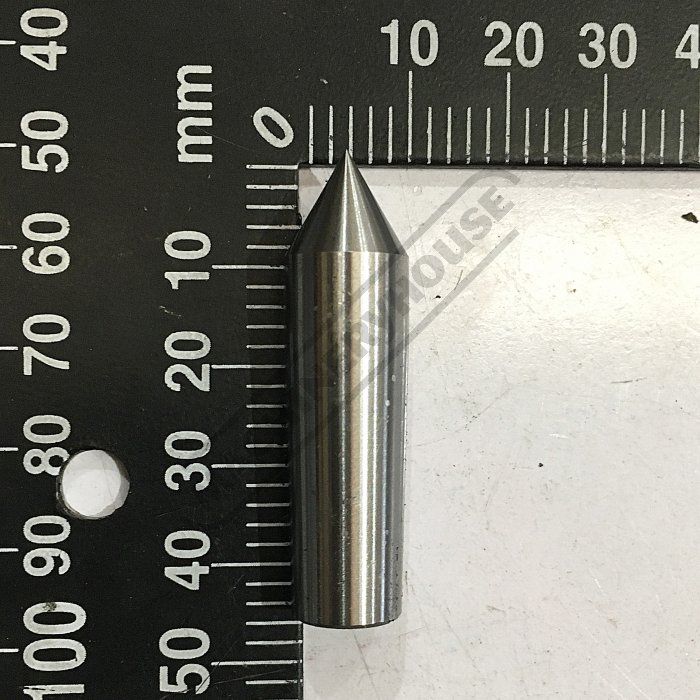

It's quite expensive for tools here in Oz. Its getting harder to get anything from China here with all the Covid Politics happening currently between Australia and China, Even the price of Chinese stuff has risen because of it in my opinion. Would a standard MT1 dead Center fit in though? this machine having a shortened tailstock?
This is the only picture I could find of the original dead center that comes with the machine:

Andy Carlson11/06/2021 08:56:59
440 forum posts
132 photos
Posted by Damien Fisher 1 on 11/06/2021 00:18:05:
I dont know that machine but if they have shortened the thick end then a standard one will stick out too far.
If they have shortened the thin end then the chances are that the bore wont have enough room for it to fit in.
From your pic the I cant quite work out if the thick end is the standard size (should be a little over 12mm) but it is close so likely the thin end is shorter.
It might be possible to cut the thin end off a centre but if it is hardened (which it probably is) then you will need to use a thin grinding wheel (with appropriate precautions).
Do you have a tailstock chuck that fits the lathe?
