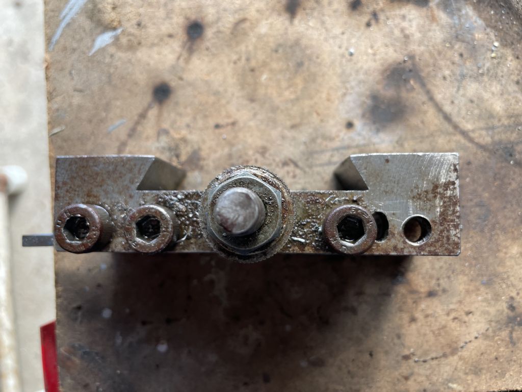

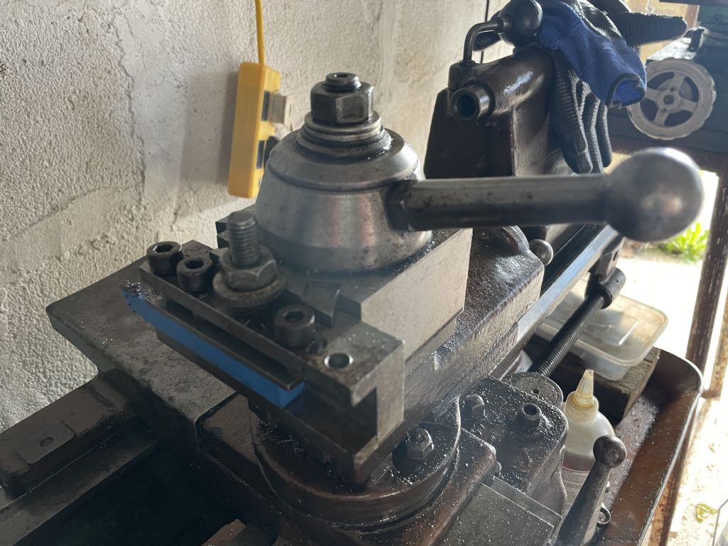

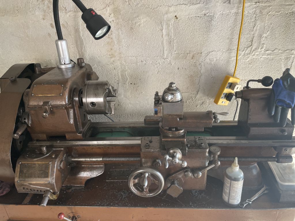

Mark Hollis08/06/2021 18:35:28
13 forum posts
5 photos
054236a0-8355-42b8-82bb-b6cb86fe843f.jpegce093cc9-6b55-4482-8d84-03a070fac714.jpeg8ba701c1-6b5d-4292-bc36-a47acd47d4a8.jpegThank you for the help so far. As requested here are some photos of the setup I have
Emgee08/06/2021 18:50:02
2610 forum posts
312 photos
If you can't find that type for sale anywhere then with access to a milling machine they would not be too difficult to make, just made some for an Emco 5 cnc QCTP as none available for sale of the type needed.
