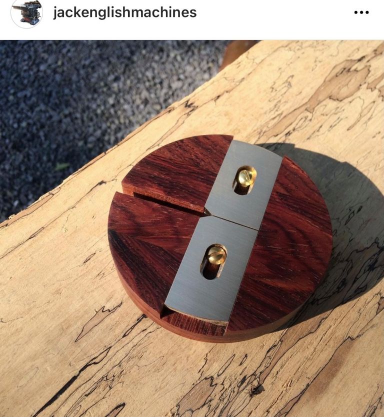

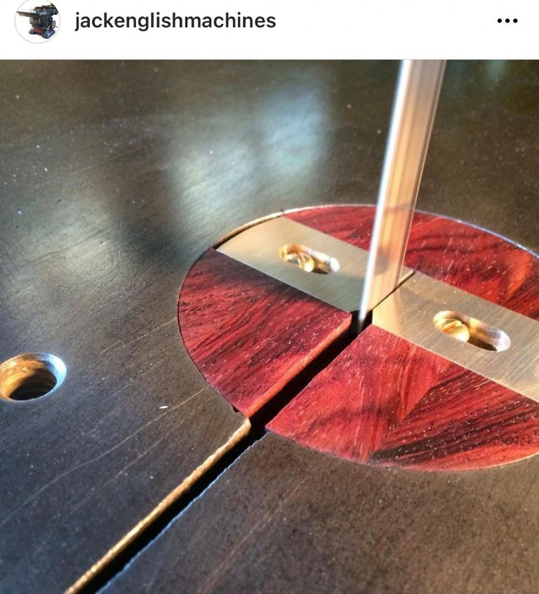

throat guide2.jpgI'm hoping to make something like this. For scale the blade would be a maximum of throat guide.jpg30mm.
Grindstone Cowboy24/05/2021 12:52:41
1160 forum posts
73 photos
Looks nice, but I suspect there may be a tendency for it to rotate?

pgrbff24/05/2021 12:57:29
261 forum posts
31 photos
The hole in my saw is square so shouldn't be a problem. I'm not a metalworker, that could be the problem!
