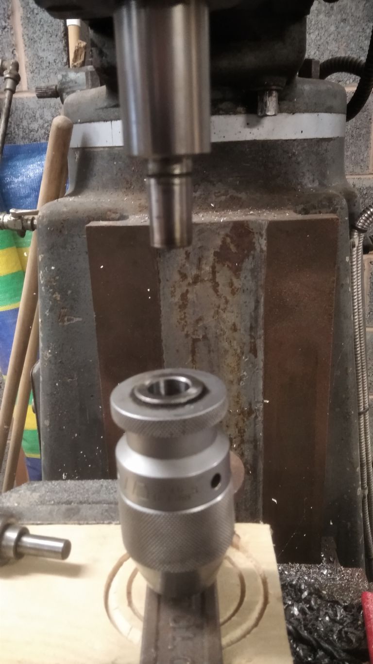

How do you reliably reattach a keyless chuck to its adaptor taper?
It came apart and doesn't firm up using pressure from the quill on a millting machine. I could use a fly-press but wondering if I'm missing something?
Any ideas?

Warm the chuck up with an electric hot air gun, until it's uncomfortable to hold, make sure both surfaces on properly clean, put a block of wood on the drill table, with the Jaws wound all the way back out the way, do this before you start, use the quill handle to press it together, not excessively.

First check the tapers mate fully, no burrs or dirt. To fit I always separate the adaptor, place it in the female part and strike it on the wood bench so that the mass of the chuck travels down onto the taper.

The best thing I can do is clean the tapers with IPA or acetone and heat the chuck up in the oven to 50-90C. Then bring the two together again.
If that doesn't work it's the freezer for the adaptor too!

Its worth checking the relative lengths of the taper and socket. If they are very close and the end of the socket is closed you can have problems with air entrapment.
Especially if simply pushing the taper in. The socket to taper jion become essentially airtight before things are fully home so the final push compresses the air inside acting against the push not only reducing the holding force but also inducing a sort of thermal pumping effect as the air expands and contracts with temperature changes.
Had one ordinary jacobs chuck & arbor pair that came unshipped on a fairly regular basis. IMy then boss advised drilling through from the socket into the chuck so the air could vent. Its been on there 30 odd years and counting.
Dunno if you can drill a keyless chuck like that.
In my experience rap the taper on the bench so the mass of the chuck pushes it on advocated by Howard works better than an improvised press like a mill or drill feed. But I just bank the end of the tang on a solid block of metal to maximise vibrational forces during seating. Tangs have to be are pretty hard to withstand extractor drifts so burring over is unlikely. Threaded ones j on the end just get banged as is. There is always a clearance above the thread and a steep taper section above the taper so damage is unlikely. It is, or should be a one time job anyway.

I first gave everything a good clean. I left the chuck in an oven ~100C and the adaptor (a combination of a MT30 to Morse taper to the chuck taper) in a freezer for a couple of hours.
Held them in pace with a flypress and allowed the temperature to normalise.
I can't see them coming apart very quickly and have just used it successfully.
