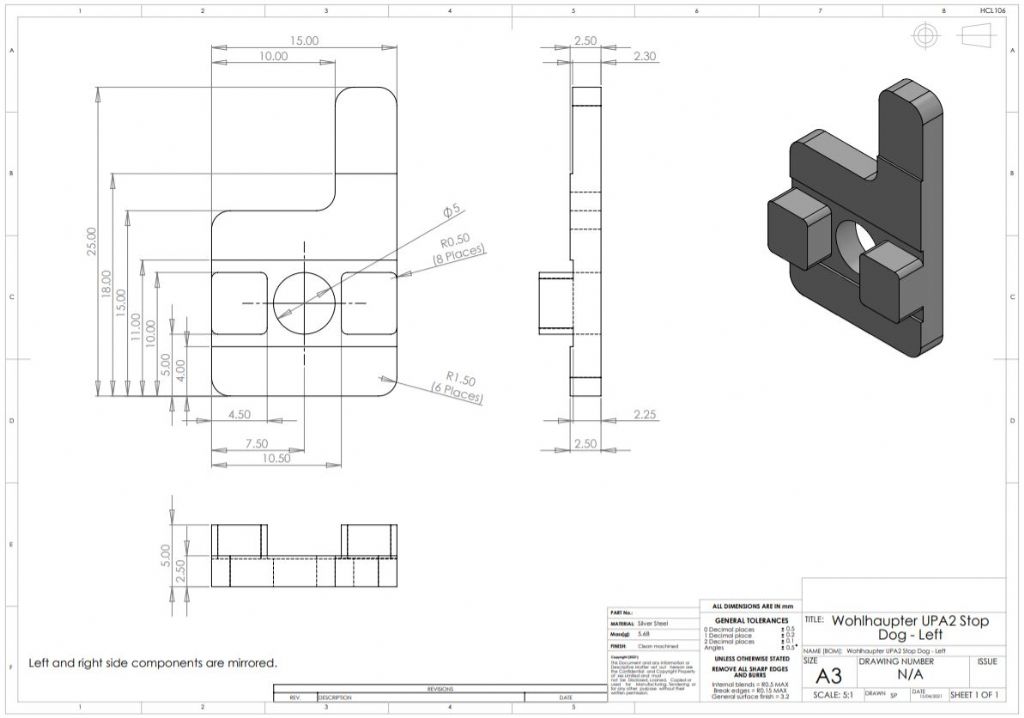

It just so happens I made a replacement pair of stop-dogs for my UPA2 last week. Happy to send you over the drawings if they're any use?

Thank you Stuart,
Earlier today John Hinkley kindly sent me his collection of Wohlhaupter documents and now Stuart even supplies a ready made drawing for the missing stop dogs. What a brilliant Forum - thanks again everyone.
