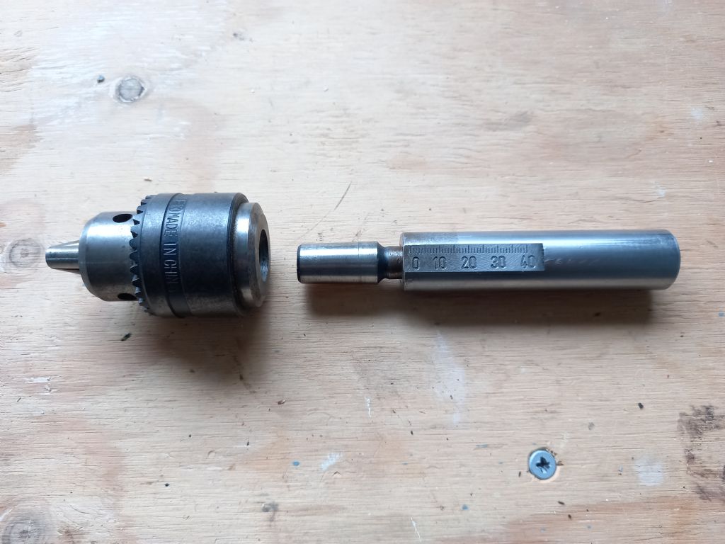

Hi,
Dave here, I need a little bit of help on my late fathers Hobbymat MD 65 Lathe.
I am trying to swap the Tailstock Chuck for the Centre Spindle.
(not sure if the terminology is correct here)
The Chuck appears to be stuck in the bit that goes into the Tailstock.
I was advised to lever it apart but all I've manged to do is remove the Chuck Head from it's own shaft and it's still attached to the piece that goes in the Tailstock.
I am of course assuming that these parts are interchangeable and one simply wedges/levers or applies brute force to change the mover.
Just kidding on the brute force bit.
Any advice would be greatly appreciated.

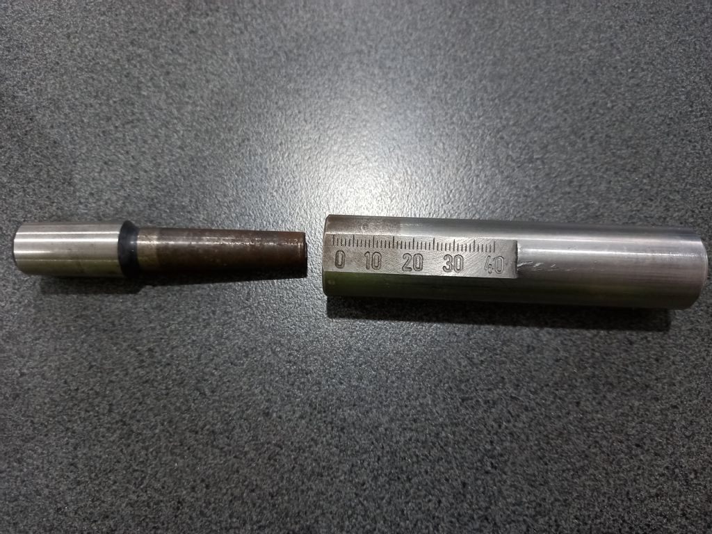

MD65 Chuck Shaft
Hi All,
Thanks for the tips. Handed the Spindle to the workshop & 5 mins later it was returned separated.
Sometime in the past someone thought it a good idea to cut a bit of the Taper off. No idea how, why, when or where but this explains why I couldn't just wind it out of the Tailstock.
Now I can get back to tinkering with my new (old) toy.
Appreciate all the advice given.
I will be getting me hands on some Plusgas ... just in case
Kind Regards ... DaveT

Good that it is now separated! It looks like it needs a little bit of careful cleaning on the inside of the taper as there seems to be some corrosion as well. Maybe your machine shop has an MT2 taper reamer that they could give it a very light scrape with?

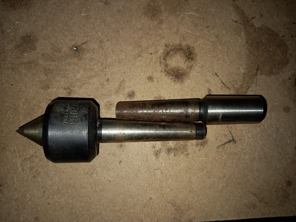

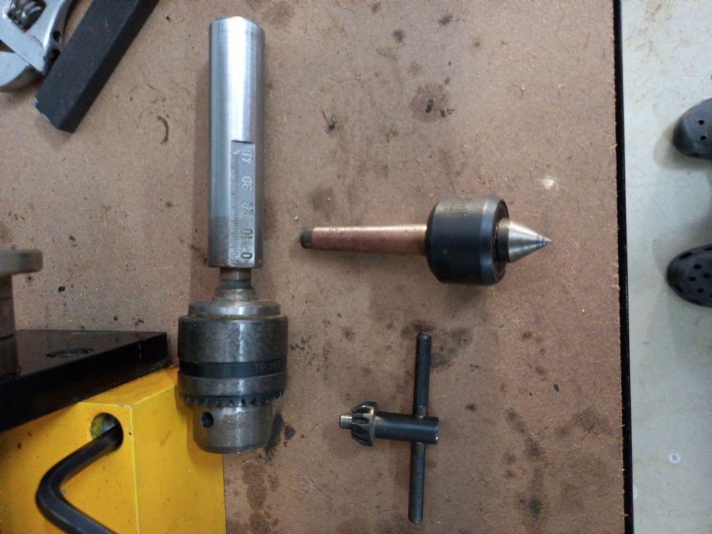

Chuck n Centre
Hobbyat MD65
There is a bit of surface rust inside the taper of the quill, so yes all three pieces will need a little tlc.
The chuck shaft is quite a bit shorter than the centre so I will have to keep a piece of rod handy for when I swap the over but that's no biggy. Just happy to be able to start the final cleanup prior to using it.

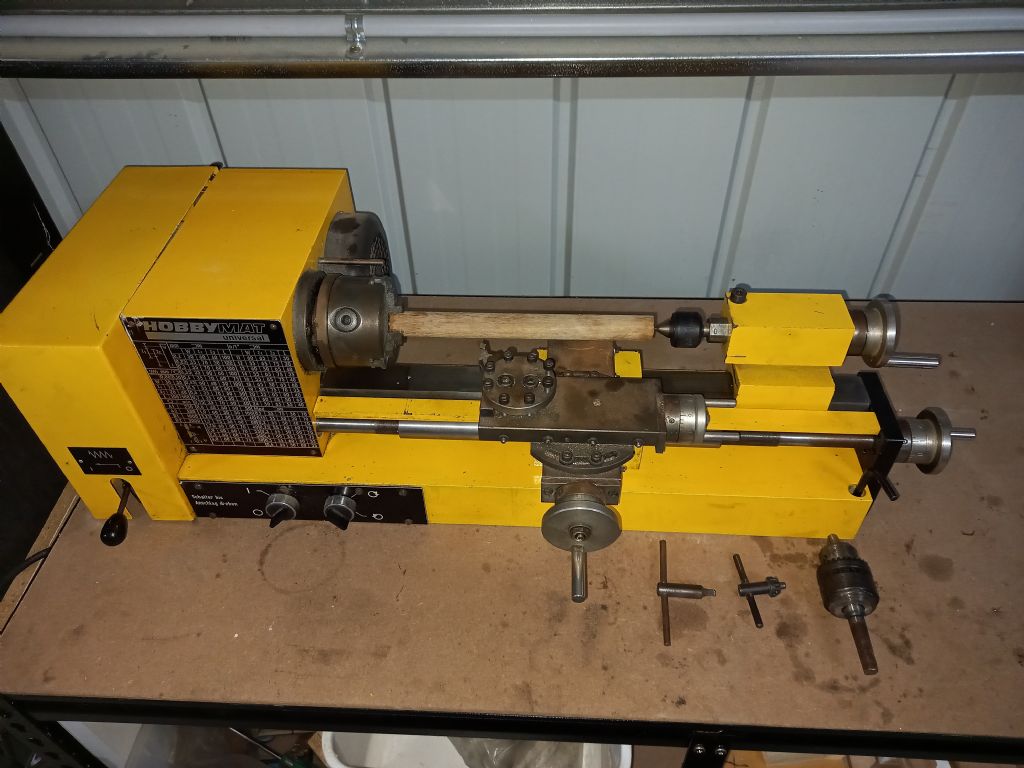

The Lathe pic attached is just a dummy setup, it will give me an idea where to bolt it down with clearances and accessability to the belts etc ..

People shorten the taper because they get annoyed by the item ejcting before the tailstock barrel retracts back to zero graduation. But it can backfire as you found. Use a ball bearing to make up the difference - it just rolls out after use.
