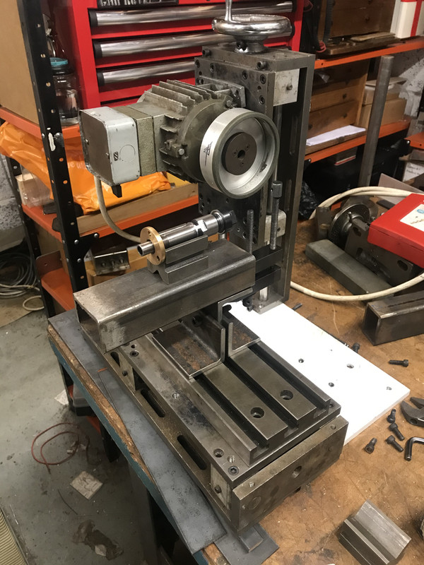

Evening all,
I am building a tool grinder from bits and bobs I have. I need something like the capabilities of a Deckel S0 Single lip grinder. I did try to buy a Chinese one, but it appeared broken and with the wrong plug, so it was returned.
Given I’m making this from “stuff” it’s going to have ER16 spindle for tools, and I’ll knock up the positioning fixture from some weldments.
Which leaves the actual motion ways. On the Deckel and Quorn the cut is put on by sliding a bar and then that bar is pivoted to move the tool against the wheel.
I happen to have a slide way for putting the cut on, which I can fit a micrometer head to for controlling the depth of cut.
Im wondering about the easiest way to do the cutting motion. I have a cast iron t slotted table I was thinking would give me a good start, but it’s designed to attach to a lathe cross slide, so the back is plain.
I was wondering about attaching hex cross section bars to it and the other slide to form “sitting” ways to slide along and guide the motion. I don’t have any dovetail cutters to make traditional ways, and I can see some advantages to being able to “just” lift the table off.
Or should I make a trunnion pivot on the sliding table ?
Thoughts welcomed

Dave S15/02/2021 17:16:15
433 forum posts
95 photos
This is where I have mocked upto:
so I have the “spindle” on a vertical, and I have a main feed slide into the wheel - it needs a feed screw but that’s quite straightforward I think.
On that table I have a t slotted lump, and it’s the ways across to do the cutting I am pondering. The spindle in the v block will be put into a housing to do rotation and indexing.and the angle iron tilt/swivel base needs some work clearly.
Given the low forces I was wondering if the table would just “sit” like the one on my surface grinder does. I don’t think it needs dovetails unless it’s going to fall over... That feed is on a Deckel a hand moving the head on a pivot. I could just build a trunnion on the big feed table and not have the t slotted piece at all. But the t slots seem more useful.
It occurred to me that 4 pieces of hex bar bolted 2 to the feed table and 2 to the bottom of the cross slide would form a set of ways, but I might have missed a reason not to do that.
The table would then just lift off for cleaning.
Thoughts solicited.
