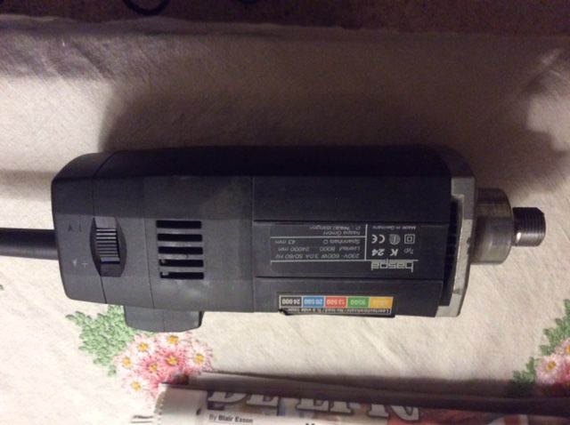

Does anyone know the correct Collett clamping nut size for a Haspa K24 Spindle motor.
Where can I buy one ??
Thanks
George

Have you tried asking Haspa for spares
George Pilch26/01/2021 15:45:43
6 forum posts
2 photos
Thanks James, yes I did. They are very very expensive, over £60 for 1 collet and 1 nut.
I just wonder what ER collets match ?

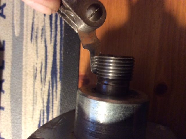

George Pilch26/01/2021 19:52:51
6 forum posts
2 photos
I measured the thread and it appears it's 1.5 whit thread diameter is 0.7", does this help ?
Thanks
George
George Pilch26/01/2021 19:57:53
6 forum posts
2 photos
img_2372.jpgThe spindle thread is 1.5 whit and diameter is 0.7" does this help ?
Thanks
George Pilch26/01/2021 19:57:56
6 forum posts
2 photos
Thanks

I doubt a German tool would have Whitworth threads, more likely Metric are you sure it's not M18 x 1.5
Also post a photo of the collet as that will determine whether the nut needs a tapered end or plain, any notch to retain collet etc.

Does the collet actually fit in the end you are measuring, thought the flexi shafts screwed onto the spindle.

https://www.buvac.nl/wp-content/uploads/2019/09/HASPA.pdf
Page 8.
If I read it correctly, it is a strange one at M18.5 x 1.5. And you are correct. There is no collet in the world to fit that opening.
George Pilch26/01/2021 21:02:14
6 forum posts
2 photos
Yep, I thought it strange too, It more likely is M18 x 1.5 to Quote, 'no collet in the world to fit that thing' Anyone fance making one.   It's not tapered, looks plain.
