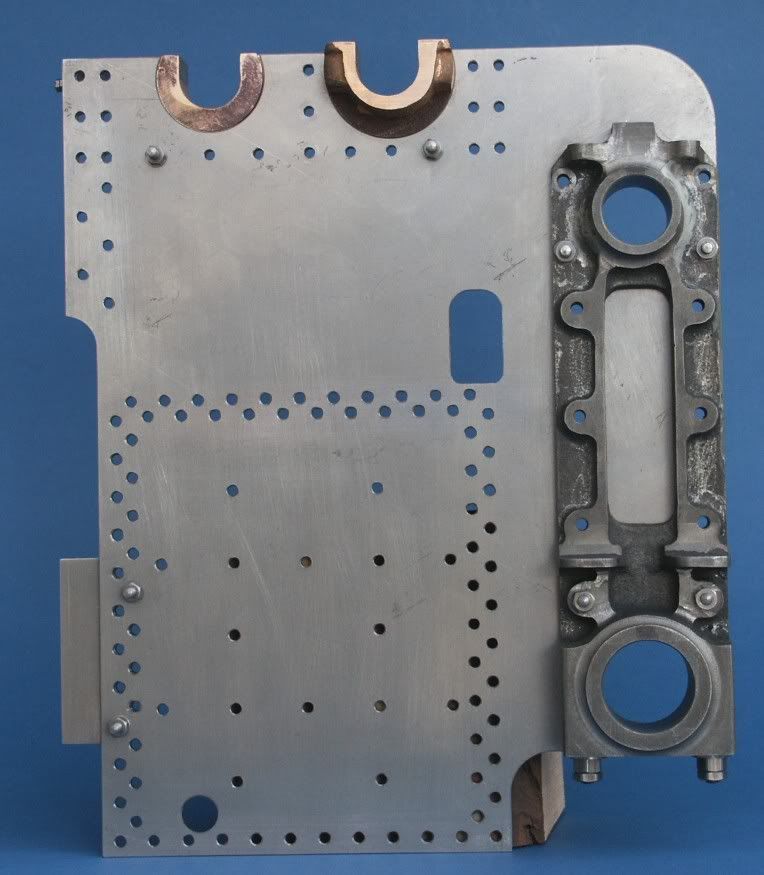

Mine were laser cut and can't see a reason why waterjet would really be worth paying extra for as finish was very good to 1 thou.

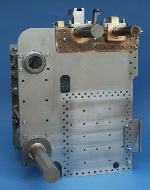

Well it was either that or the mating parts I made had matching errors to the platessmile p
The crank/2nd shaft bracket slipped into it's holes as did the 3rd/rear axle. As you can see these two castings have raised circular bosses that locate in holes laser cut into the horn plates, they fitted without any slop. Can't remember now if I even needed to drawfile the cut edges, may have just given them a quick lick with some emery around a file. All the small holes I drilled.
