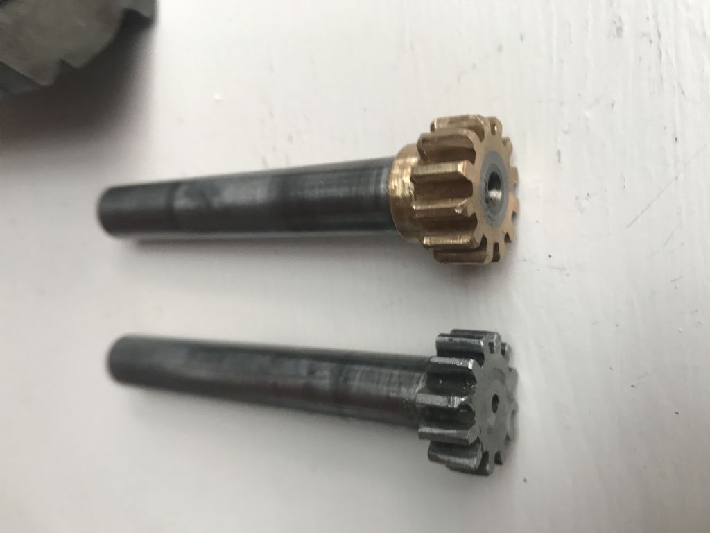

What surprised me was the wear in the 10 DP worm gear in the power engagement box, the bronze gear had shortened by about 0.15" . Here are some photos of the upgrade work:-

Saddle carriage rack pinion - upper unit repaired with a new bronze gear - pinned to the original shaft. Lower one showing teeth damage. I have a new rack to fit to the machine.
