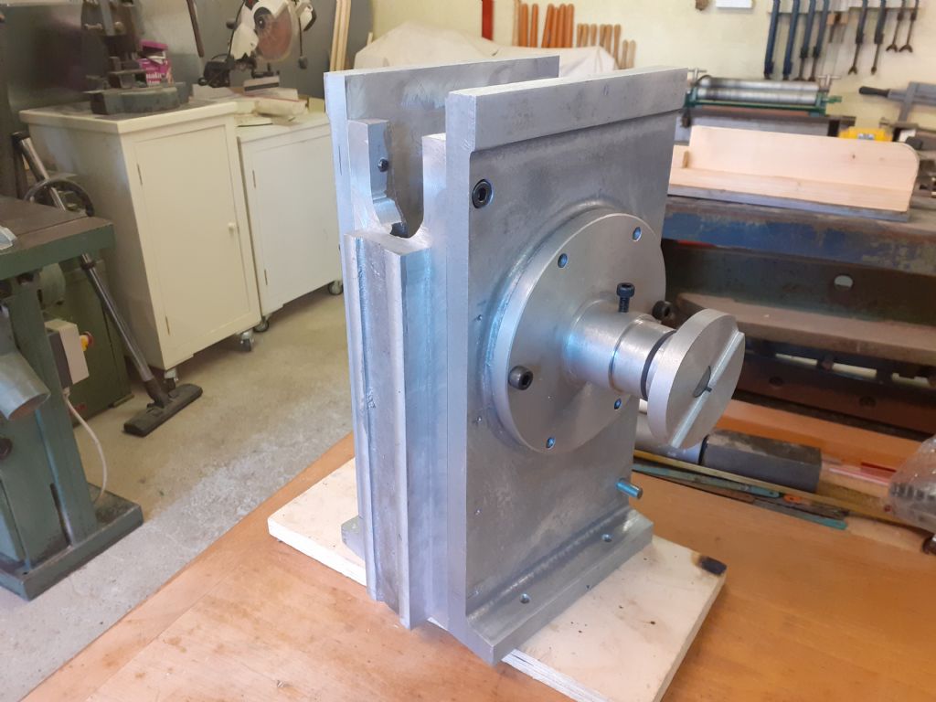

Hi, Some photos of castings for the Gingery Shaper, increased height and thickness on the uprights as per Rick Sparbers Website

Most impressive these castings that you have done for the shaper ,what size crucible will fit in your Myfordboy furnace .Hope you will post some more as the build progresses.

Hi John, The crucible size is A10 it needed a full one for the uprights! I will upload more photos as i progress.
Richard
