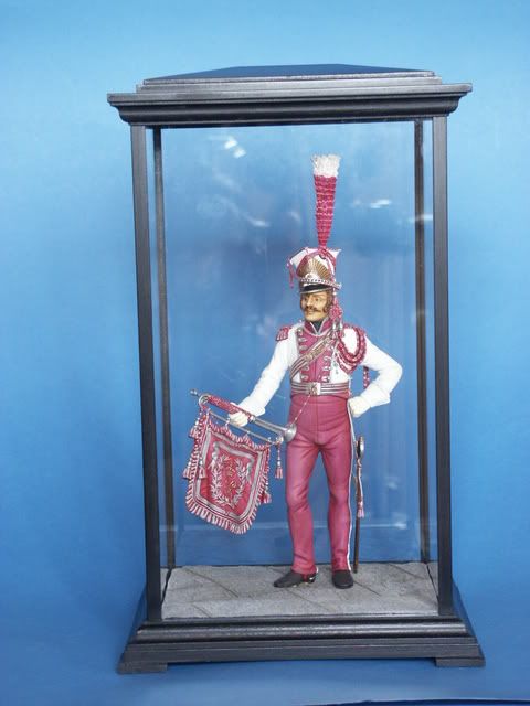

I've done it by using silicone to first form a glass box much like a fish tank and then applying a decorative "L" shaped moulding to the external corners, you you are neat with the silicon then the internal corners don't need covering if not a square bead can be added. The glass on this is about 300mm high, various woods that have been ebonized for the trim.
Bigger stuff like this 5ft wide case I route grooves into square columns to take the glass
Edited By JasonB on 27/08/2020 07:07:11
