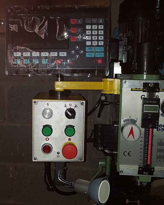

As nobody has come back with any horror stories, I decided to take the gamble.
An LCD display and 3 scales have arrived over the last few days.
All seem to work okay and look to be reasonable quality.
I have fitted the easy bit:20200812_162152.jpg

IRT06/02/2021 23:32:09
151 forum posts
44 photos
All went well fitting the scales, and all seems to be accurate and repeatable,
I have set the direction to what I think is conventional:
Y increases if the table is moved back, X increases if the table moves left.
i have been using the mill for a couple of months now without any issues.
I have seen something today that I do not think is right.
If I set up a line hole position right/up the line is actually right/down.
If I set up a bolt hole circle, the holes are mirrored in the Y direction.
I have found someone's video on YouTube that demonstrates this:
https://www.youtube.com/watch?v=x8tK8m-6vjA
(jump to 13 minutes into the video).
I think I have 2 options: Invert the Y direction so that Y increases if the table moves forward, or remember that the angle must be reversed when defining the pattern.
Has anyone else seen this, or am I doing something silly?

Steviegtr06/02/2021 23:42:20
avatar
2668 forum posts
352 photos
I have the MDRO fitted to my Mill. British supplied i believe. Also i see the supplied from overseas models fitted to most others because of the cost. I have not heard of any makes causing any problems at all. The way you describe the problem sounds like a mirror type error. I would think that in the settings there may be a way to correct the problem you have. If you are like me then you fit & switch on. After the Mushroom cloud clears , you decide to have a good read of the instruction manual. Hope you get it sorted. Sorry not to be of much help.
