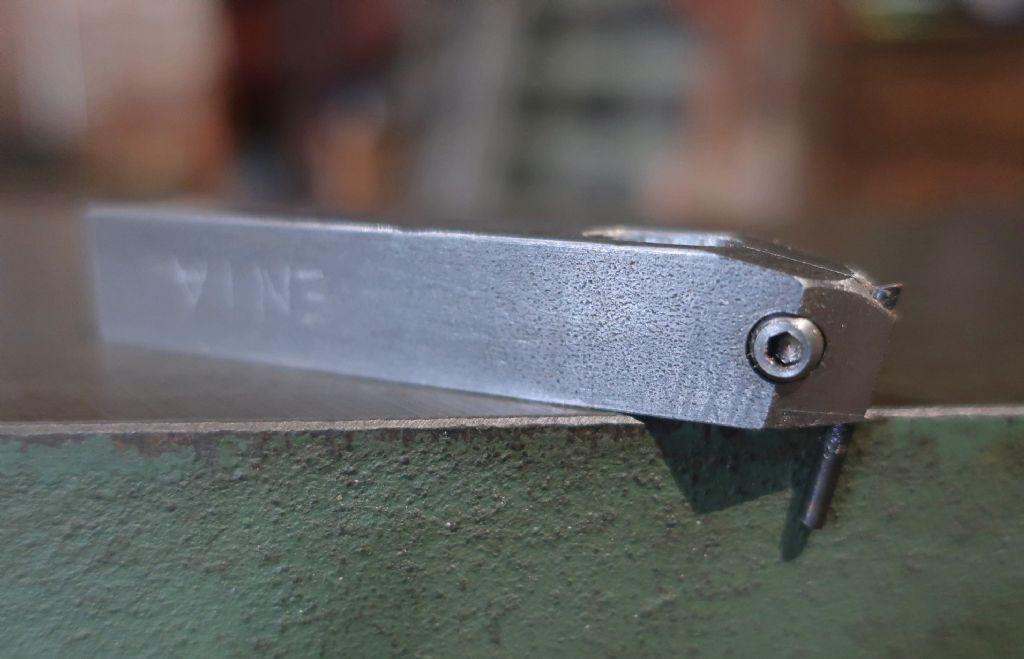

In a recent update to an ongoing thread (Lathe Improvements?), Niels Abildgaard included a photo of a machining setup which featured a short, stubby tangential toolholder which barely overhung the edge of the topslide - The design commended itself to me as a Hobbymat owner, as I've always regarded the standard toolholding provision to be, well, less than perfect, perhaps.. The Hobbymat does not respond well to excessive or uneven loads applied to the surface of the topslide, and the tools must be shimmed to centre height - the opportunity to try and alleviate some of these admittedly minor annoyances and to be able to employ a simple and easily set tool for the most commonly undertaken, facing and turning tasks seemed to be worth an experiment.
I quite shamelessly set out to produce a smaller but more-or-less identical version of this toolholder with the aim of trialling it, guessing at the angles (12 degrees for toolbit and back rake, 85 included at the nose) from extra photo's that Niels kindly posted.
The initial results are promising - the holder was relatively simple to make, cuts well (when arranged not to rub - see below) and sits firmly on the topslide without having to apply brutal levels of torque to the clamp. It's currently fitted with a 2mm round HSS toolbit.
The tool as it currently exists is very much a "first-off" and I throw it out here, naked in it's imperfections, for scrutiny or comment by anyone interested.
I'd welcome opinion on whether the 12 degree toolbit angle is in the right ballpark or whether it could usefully be increased to provide more clearance without increasing the risk of weakening the edge - and will I need to change it if I wished to use carbide?
There is a "To Do" list - I clearly need to reduce the height of the upper face/front chamfer to avoid the nose rubbing, reduce the included angle of the nose to provide more side clearance, and experiment with tool-grinding angles to find the optimum balance between cutting angle and edge-strength. And I may move the clamp screw rearward just a little..
Any comments and suggestions will be gratefully received

Make the Mk2 with a 45 degree slope and see if it is any better or worse. It would be possible to use the other end of the existing tool and remove the unused cutter, or even use the other end of the cutter. I am always thinking of ways to reduce overhang on a much bigger, heavier lathe. Should you wish to try carbide, small diameter blanks are easy to get on ebay. To cut them, you need to score around the diameter with a diamond file, put the carbide in soft jaws in a vice and snap of at the score. It quite often breaks just where you want it to. Wrap the end you are holding in some rag just in case it shatters.

There have been at least two Tangential tool holders published in the past few years, so you are in good company, and you now have a most useful turning tool.
One involves milling a slot in the holder at 12 degrees for the square toolbit, whilst the holder is inclined at 12 degrees also. It bis easy to get the compound angle set up wrong!
I have made two versions, one for 1/8 square toolbits and another for 5/16 square..
The easier one to make involves milling the slot for the toolbit at 12 degrees, and then milling the shank of the holder so that upper and lower surfaces are at 12 degrees to the sides of the holder.
To sharpen the toolbit. it is held with the corners vertical, on a jig which inclines the toolbit at 20 degrees, in one case, and 30 degrees in the other.
The commercial version uses a similar jig to hold the toolbit for grinding.
All the above allow the one tool to be used for sliding or facing cuts without altering the tool setting.
A necessary accessory has to be a centre height gauge, to facilitate setting the cutting edge to centre height.

Hi, thanks old mart, I hadn't considered making it a double ended, but that's a logical plan for a test bed.. It'll also be convenient 'cos as you can see in the second photo, it was the last end of the bar..

Howard - your information is a useful reality check, and confirms my thoughts on the necessary angles - the toolbit is ground at c. 24 degrees and inclined at 12, so I feel some reassurance there. For the current "testing of the principle", I've been using a "clog-heel" type clamp so that I can quickly swing the tool between the necessary orientations required for "turning" and "facing" - I do recall the "inclined-base" version, and will refresh my memory again, thank you for the prompt. I agree regarding the utility of a centre-height gauge, which I already have, and indeed, dovetails neatly into the observations of...
Niels - very canny, the holder will be going under the mill tomorrow and will emerge 2.2mm or so thinner along it's back.. I will not have to fish in oily swarf for the tiny hex key ever again..
Are you able to both side & face with it in one position? .."sharpening" the angle of the nose, without thinning down the clamp "jaws" is becoming the most head-scratchingest part of the job.
I'd like to see more of your build if possible..
