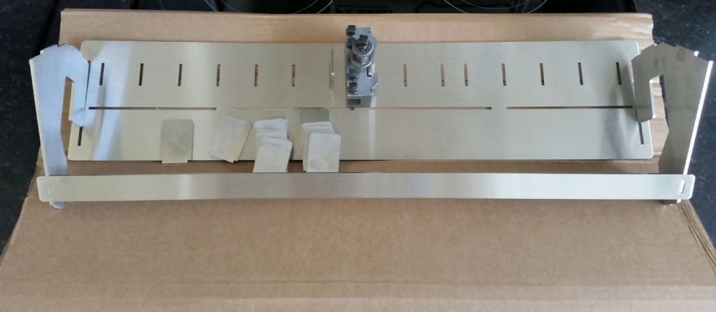

A week or two ago, I thought it was about time I drew up a rack for the tool holders for my Bantam. It fits neatly over the splashback. The bits were ordered in 304 stainless and TIG welded together. I have changed the design since making mine so it doesn't need bending. Holds 15 units - 5 set as internal and 10 set external. The only problem was buying some more holders to fill it.
Parts as received from laser cutting
A test fit on the lathe.
The holders fit better the other way round as you can see the business end of the tools.

very nice idea........
can I ask how much said parts cost to get made.........
thanks
Steve Addy22/05/2020 18:54:45
avatar
158 forum posts
107 photos
1 articles
No problem, £81 delivered in a week.  Would have been £54 in steel.
