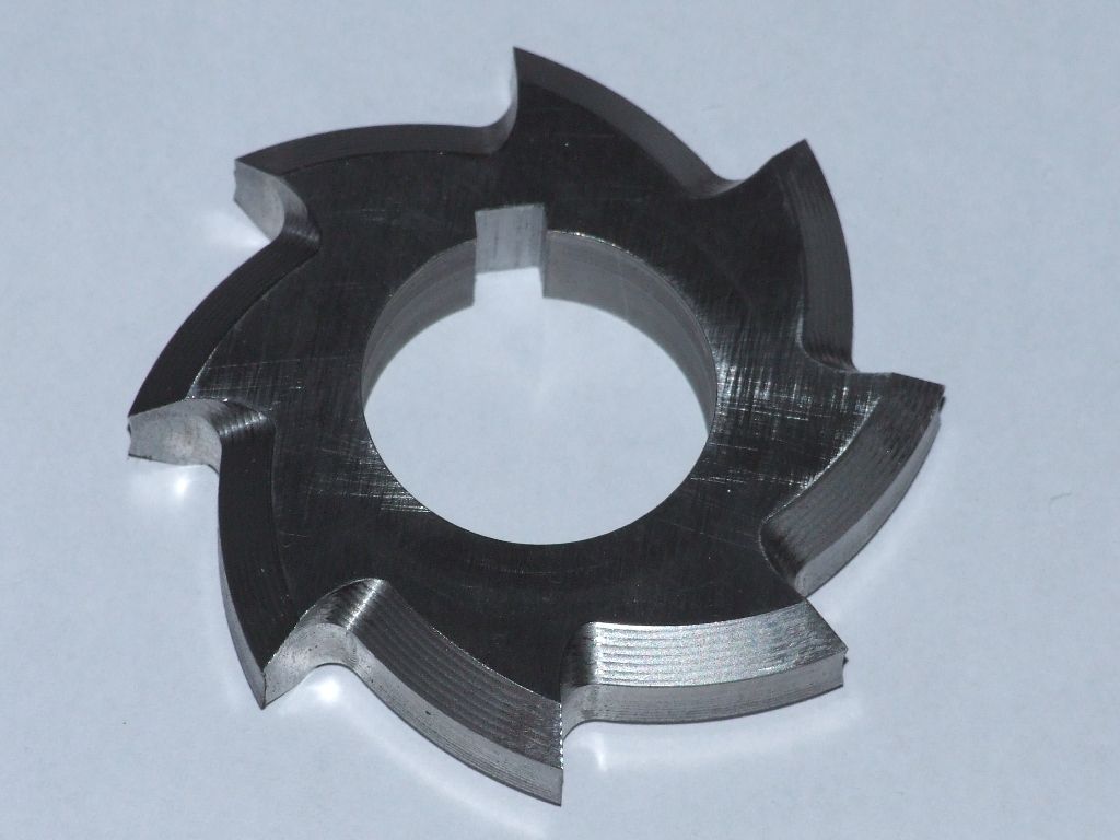

Andrew Johnston01/05/2020 12:14:26
avatar
7061 forum posts
719 photos
Posted by Michael Gilligan on 01/05/2020 09:26:06:
..........it is possible to machine the relevant profile of a “button” directly onto the end of a piece of HSS ...
Correct, it's possible to mill HSS with carbide tooling:
If I were doing this I'd make an involute cutter, like this cutter for splines, but smaller:
Andrew

Andrew Johnston01/05/2020 21:50:42
avatar
7061 forum posts
719 photos
Posted by Steve Crow on 01/05/2020 17:17:07:
How many flutes would you recommend for HSS? It looks like 3 in the photo. And cutting speeds? Doesn't carbide like a high speed. But with HSS
Indeed it is a 3-flute cutter, because that's what I had. As stated above fewer flutes are good for soft materials, not so much due to depth of cut but to higher chip loads so more metal removed per revolution. I use mostly 3 and 4 flute cutters as a compromise. For HSS it doesn't matter how many flutes, just adjust the feedrate to suit.
Carbide inserts for lathes often perform better at high surface speeds. The same is not true of carbide milling cutters. Professional grade carbide cutters are much sharper than the old HSS cutters. There are some coatings that require high temperatures, and hence high speeds, to work properly. But I suspect most of us don't have mills capable of making full use of some of the more estoteric coatings.
I was running the cutter at 3000rpm and 200mm/min and a stepdown of 0.5mm. The key to milling and turning hardened steel is to get the shear zone red hot and soft. So than means shallow depth of cut but high feedrates and reasonably fast speeds.
Andrew
