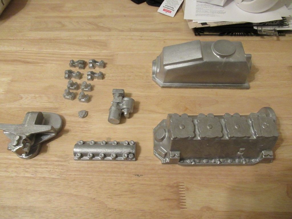

I was going to do a full build thread but time and forgetting to take pictures as I went along means it will be more of a quick build.
So i purchased these castings second hand complete with plans ,

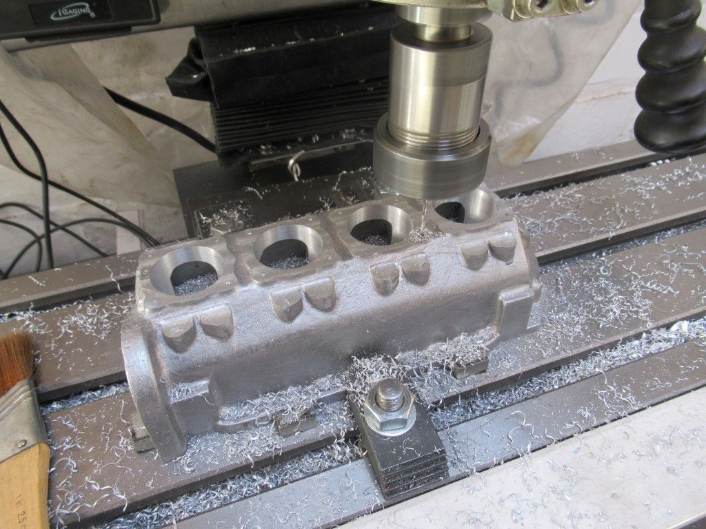

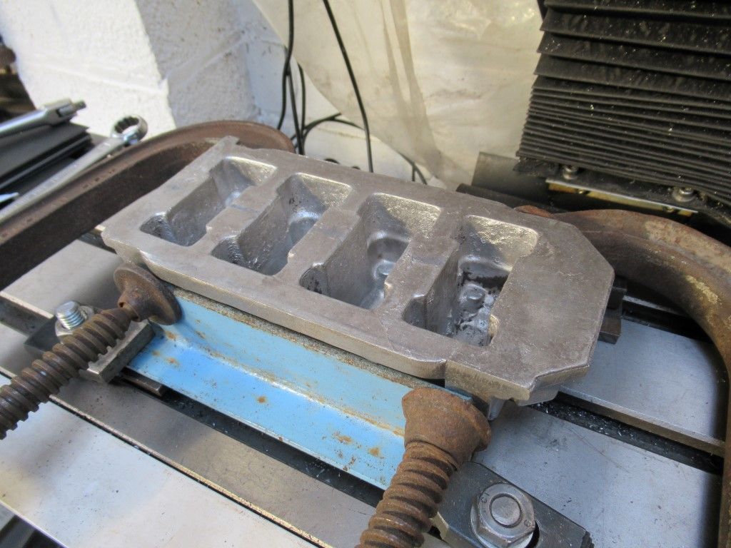

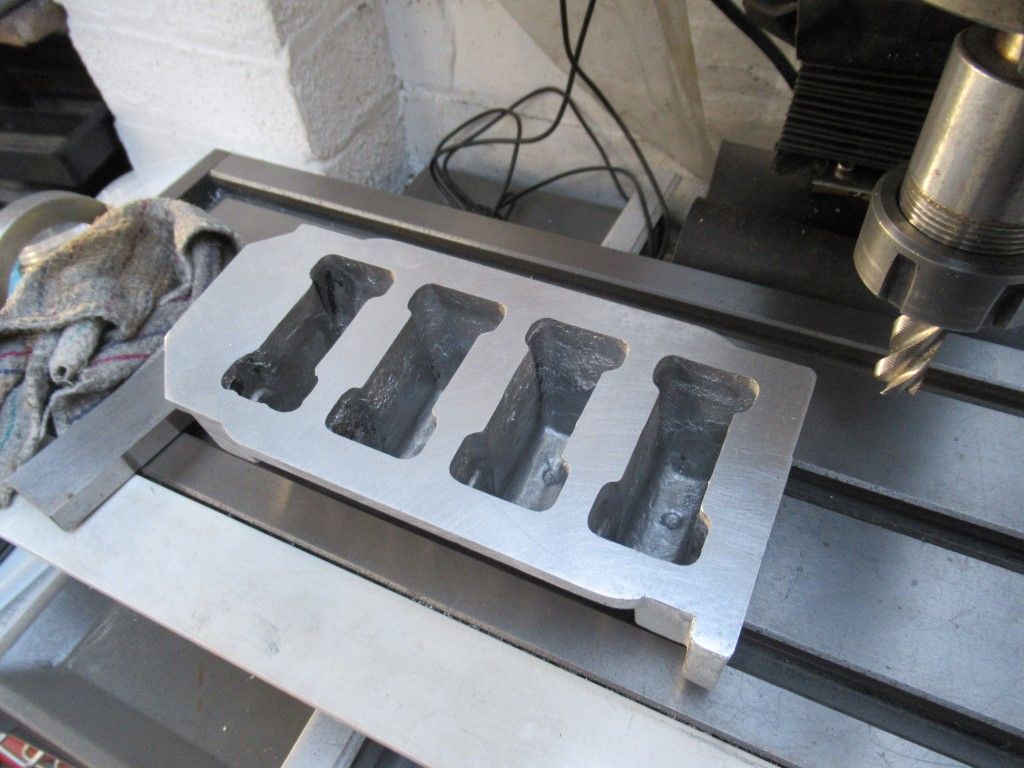

It took me a while to decide where to start but eventually took the plunge and started to machine .
Boring through for the cylinders

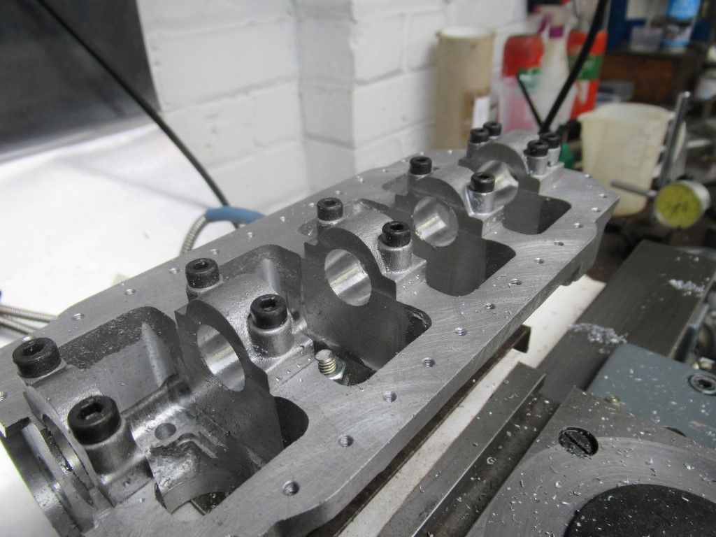

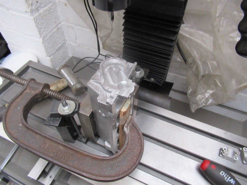

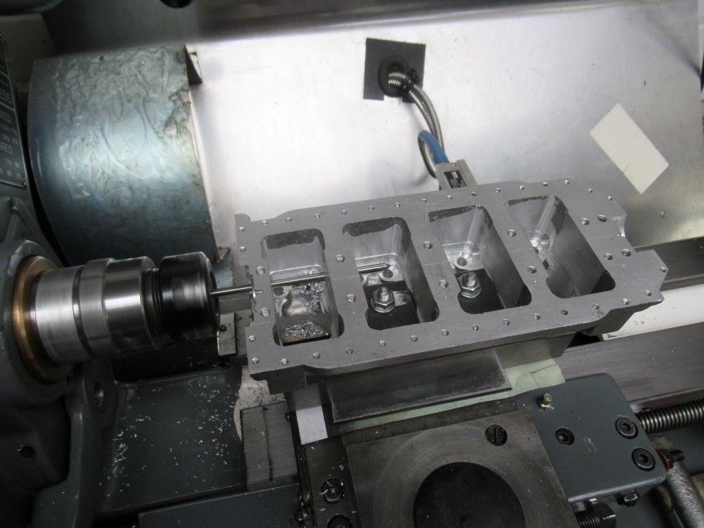

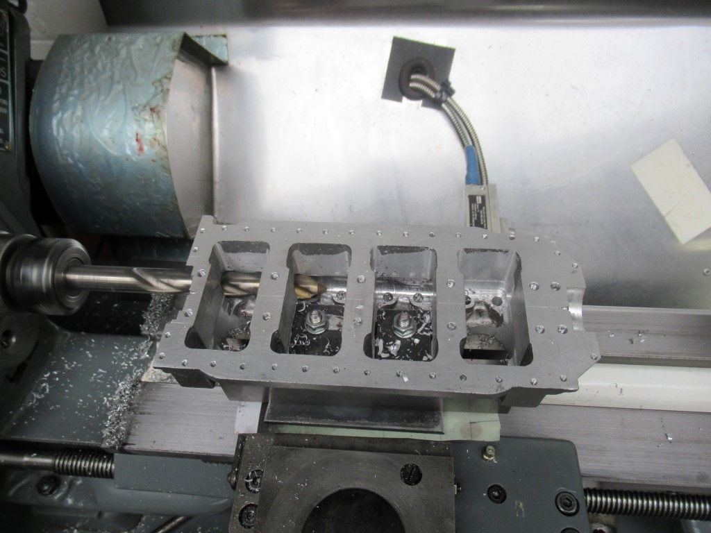

more machining of the end plate

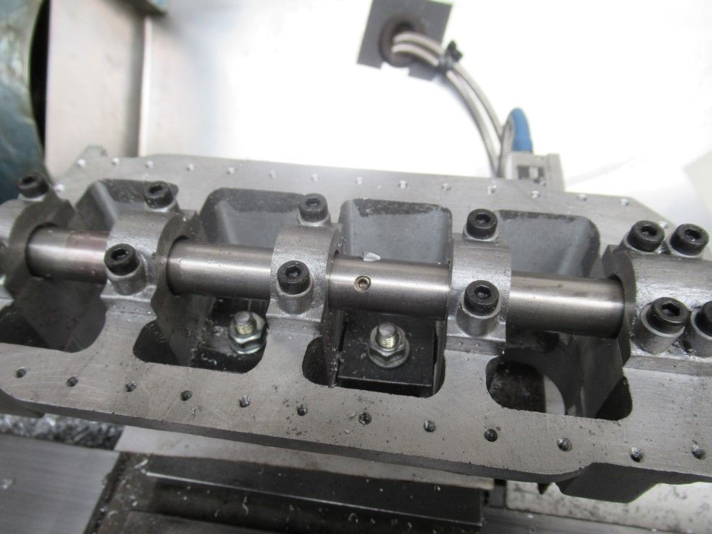

Using an extra long centre drill to mark through for the camshaft
Then open out using standard drill bits
David K01/03/2020 15:20:53
258 forum posts
259 photos

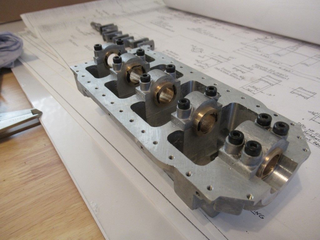

Then the same for the main bearings but finished off with a home made boring bar
David K01/03/2020 15:30:17
258 forum posts
259 photos

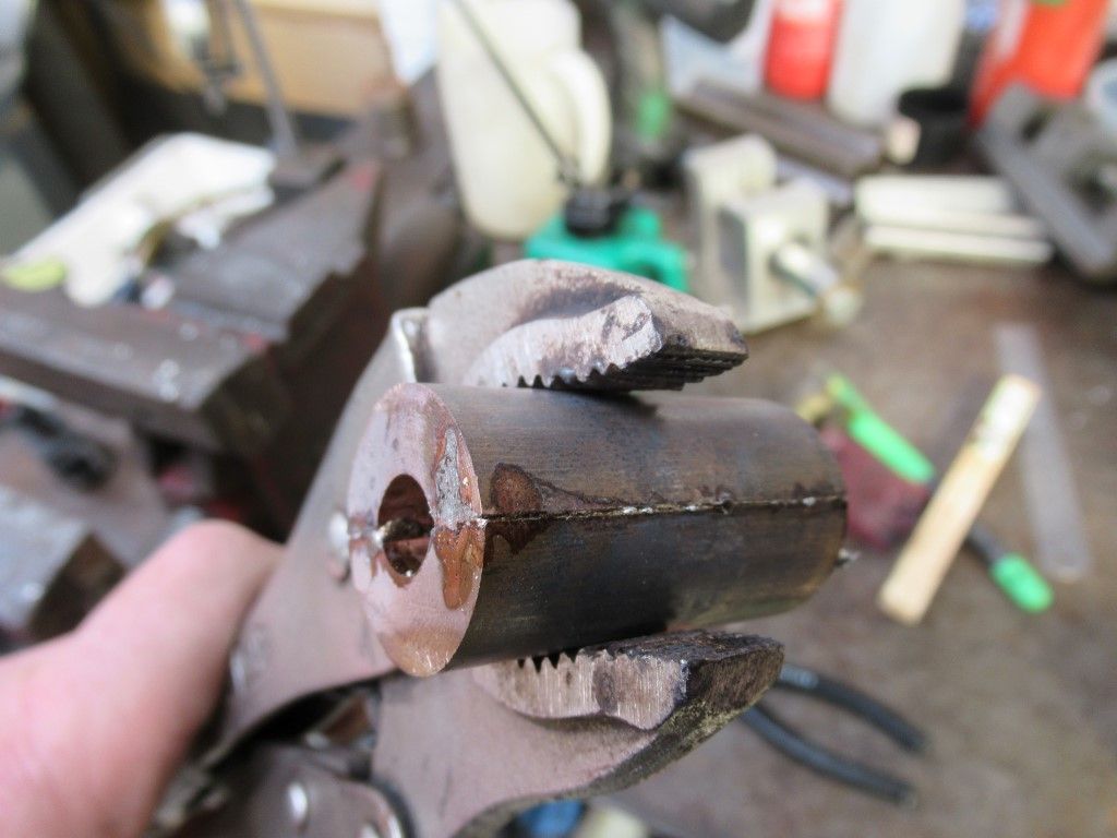

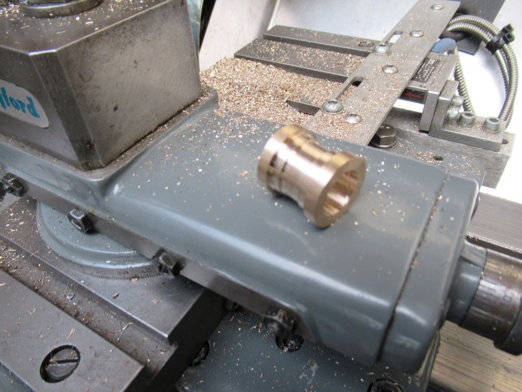

Sitting a piece of bronze for the main bearings
I soldered the two halves together before machining, if I was to do it again I think I would use super glue.
Machined then heated and split again
trial fit

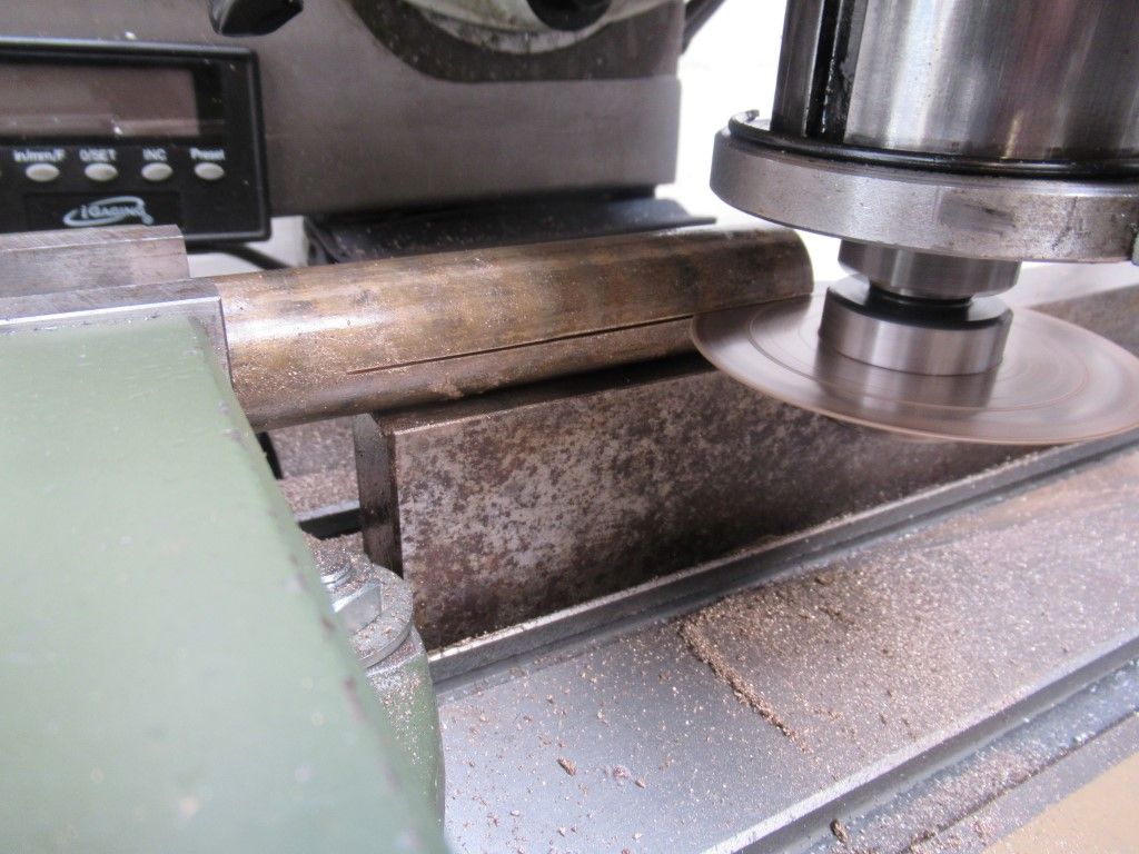

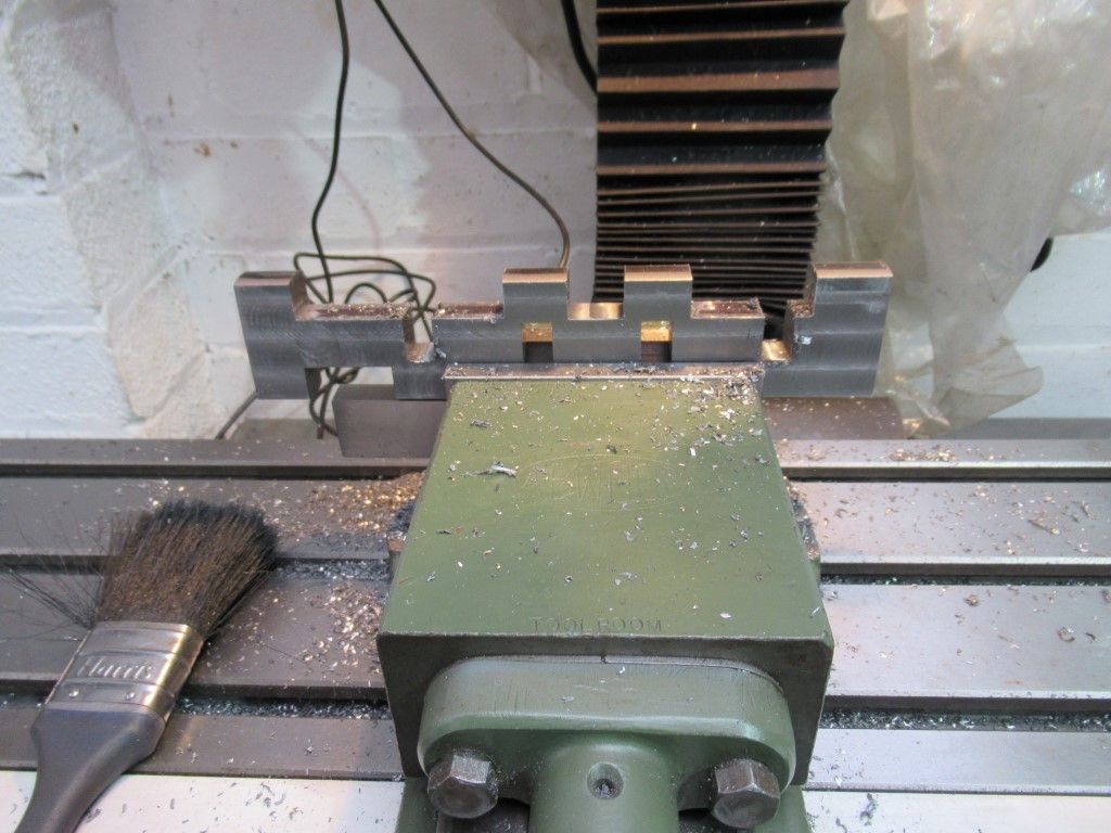

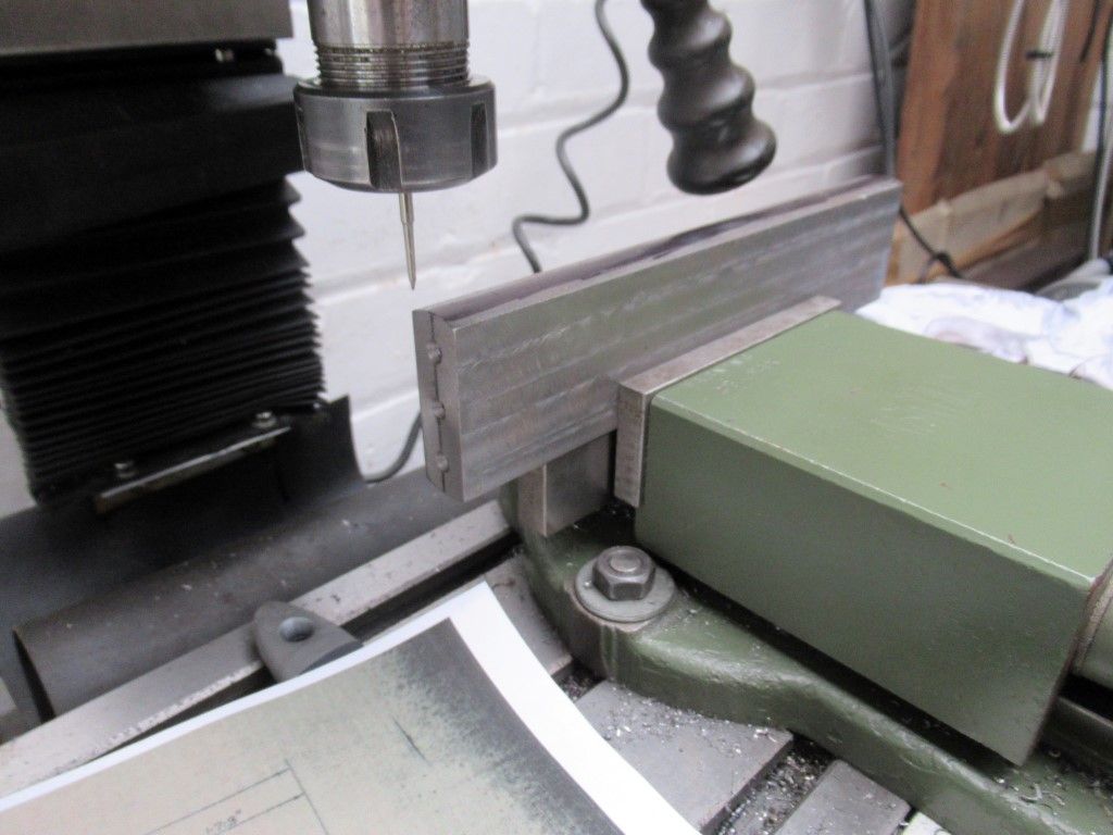

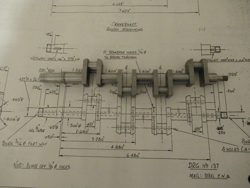

I couldn't find a reasonably priced piece of flat bar for my Crankshaft so I ended up machining
some round down to size
I milled out the basic shape
Then transferred to the lathe and machined the bearings. I made some spacers to fit into the gaps between the crank webs but they seem to have disappeared in this picture
Edited By David K on 01/03/2020 16:03:07

I bought some extra long drills to put in the oil ways
Finished crank needed minor alterations to fit into the main bearing caps

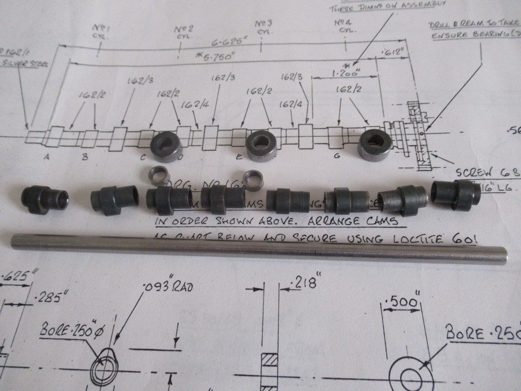

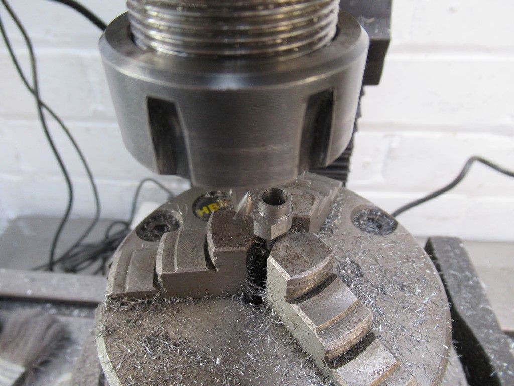

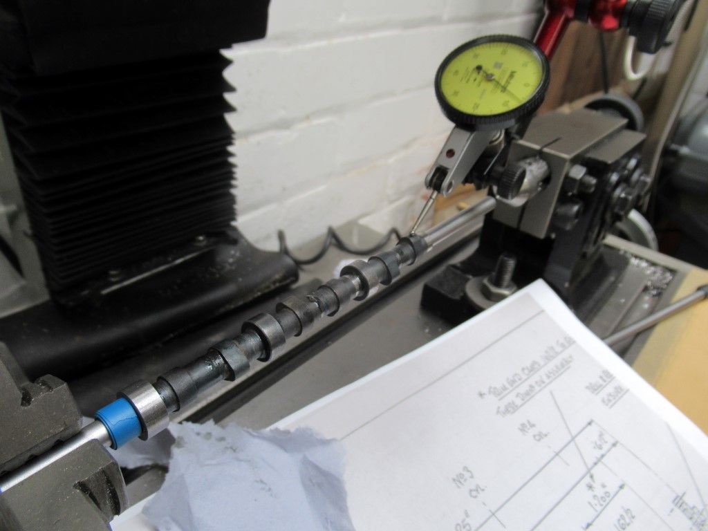

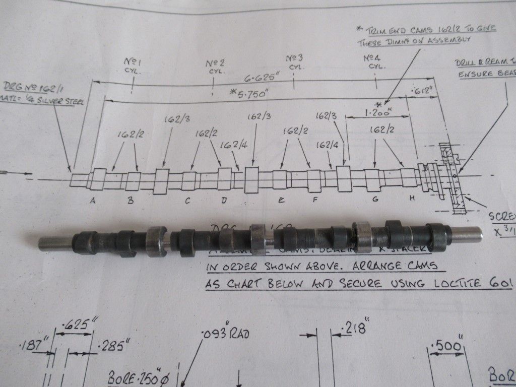

Camshaft lobes being formed on the mill and rotary table
Lobes , bearings , spacers and shaft
Loctite the camshaft parts using rotary table and Dial gauge to set lobes
Finished camshaft

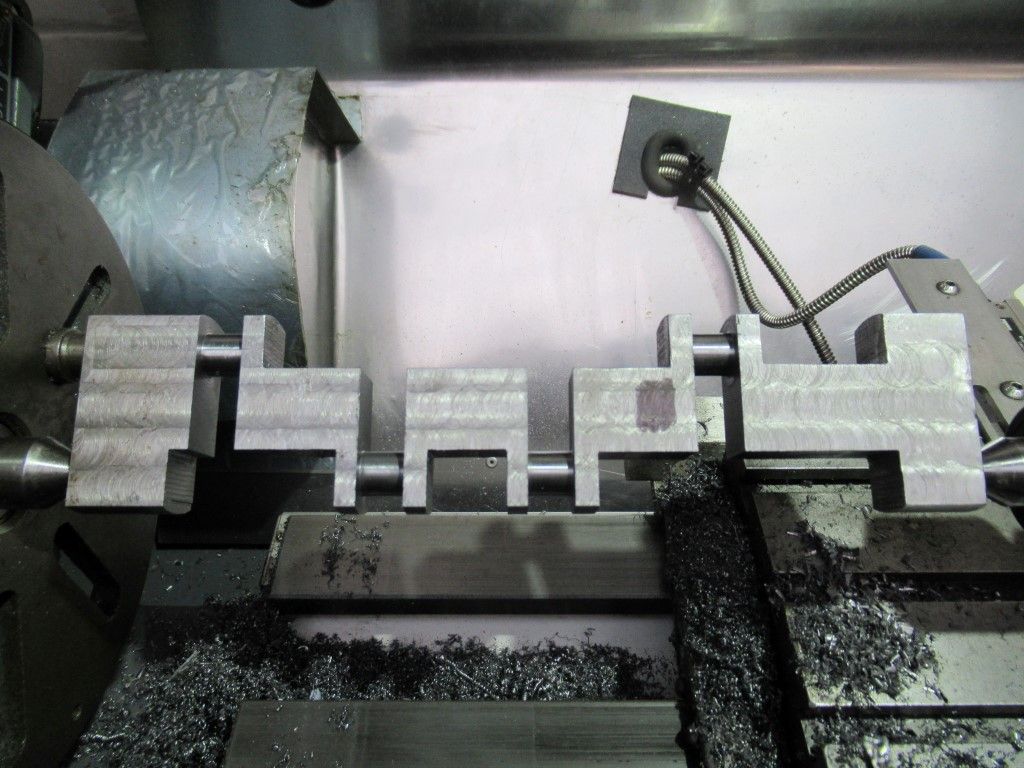

Machining shop supplied cam gear
Timing gears with idler gear

JC5401/03/2020 21:00:31
avatar
154 forum posts
14 photos
Enjoying your posts David. Could you please explain how the holder for the shop bought gear works please? I am still very much a beginner and have some gears to alter for a clayton steam wagon differential. Many thanks John
David K02/03/2020 08:57:09
258 forum posts
259 photos
Hi , that piece of Alloy I used was in fact an older jig I had lying around from a previous build.
I had cut the four slots so it compressed slightly on my four jaw chuck in my lathe.
As for the gear , all you need to do is turn a recess slightly smaller diameter than the gear and then tap the gear in with a soft mallet. The steel gear will slightly cut into the alloy as its tapped in and this is enough to hold it tight.
Remember to bore a hole through the centre of the jig so you can drift the gear out when finished.
