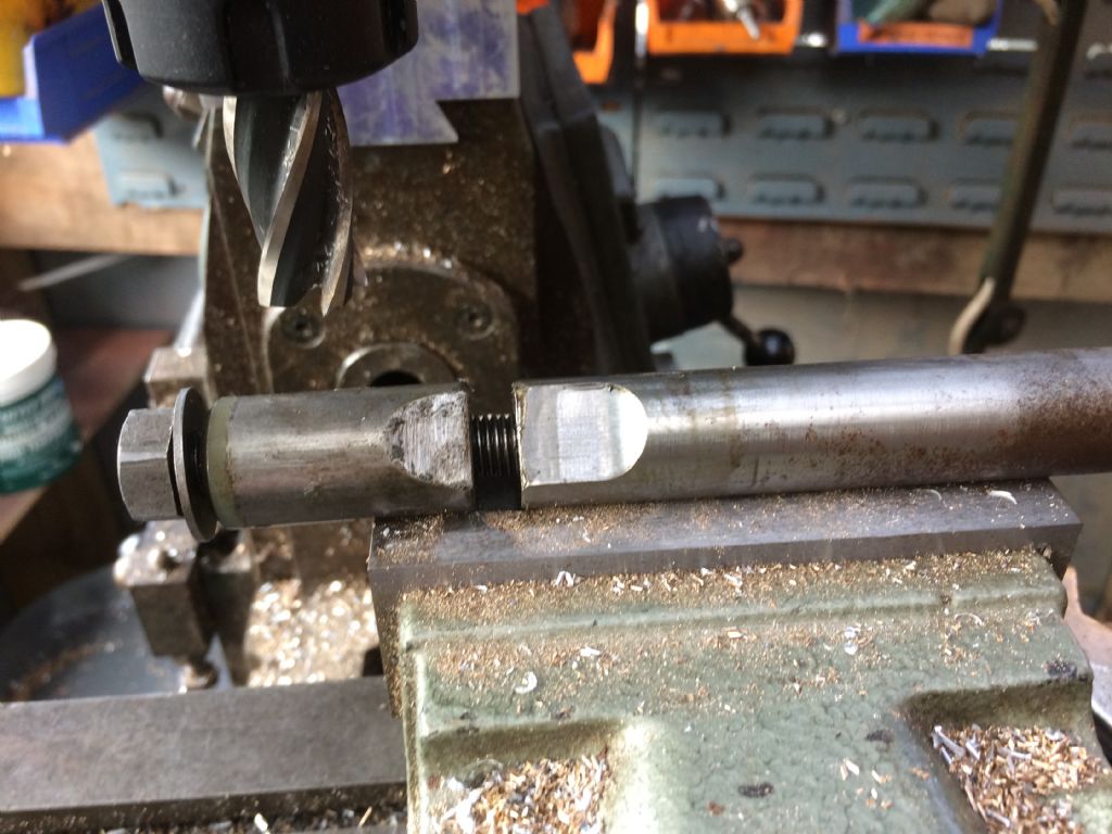

img_1005.jpgimg_1007.jpgimg_1006.jpgany centec owners that can help with the quill lock on my new mill, all the pics i have seen show a handle and not a bolt, the right hand side sticks out about 3" in the first photo you can see the whole assembley it looks home made the long shaft is threaded the short part is a clearance hole for the bolt. when the bolt is tightened it locks the quill but does not release the quill it needs to be tapped with a mallet this can not be right any help please

sorry it now the second photo for the assembley

vertical head 2.jpgThat's quite a bodge!
This is how it should look. If I get a chance I will remove mine and post a picture unless someone beats me to it!

thanks thats what i need is some pics of what it should look like then i can make a new one

We have two mills at the museum, a large Taiwanese drill mill and a Tom Senior light vertical. The both use the same style of quill lock as your Centec, the D M one works perfectly and the T S one tends to jam and need hitting lightly to free it. It must be the way the pinch clamps fit the quill. I must look at the way they fit the quill.

Geoff,
Just for you I have been out in the cold! wink
Body dia. 0.748; right clamp 'bit' 1.144 long; Total length 3.136; smaller threaded bit of right 'bit' 0.378; All one piece; left 'bit' of clamp; 1.438 long, same 0.748 but clean bored of course.
The diameter of the lock 'wedge' you can get from the quill of course.... Good choice of mill, BTW.

This is what I think would be the best profile for the locks. First get the diameter of the lock wedges the same as the quill. Then relieve the inboard ends a bit so the outside clamps first. The angle of contact is slightly greater and hopefully less likely to jam in place when the tension is removed. Touching at B would be preferred._igp2513.jpg

thanks for the info sorry you had to go out in the cold but much appreciated. I have made a sketch using your dims will make a new one later in the week. got to make some pulley wheels for a luthier i do work for today
