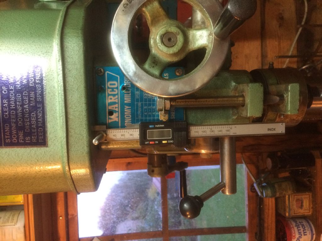

Speedy Builder518/10/2019 07:15:56
2878 forum posts
248 photos
Fitted an old digital calliper to mine. Will take a photo later.
Speedy Builder518/10/2019 07:23:05
2878 forum posts
248 photos
