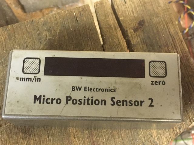

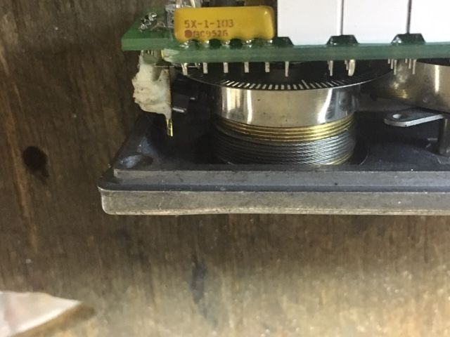

I have another DRO application but this time I would like to make a draw wire spring return linear encoder but using a rotary encoder in the style of one in the pics from BW Electronics which works well.
I know there are commercial units units available at suitable prices but before attempting I wondered if anyone had constructed one using an optical (ebay around £8.00) or magnetic rotary encoder?

I had thought of a retractable key ring but realised that I have a few scrap 3m tapes. Dismantled, this revealed a 0.12 thick, 9mm wide return spring easily long enough to try. This I was going to put in a spring barrel at one end. Have two plates with the wire drum in the middle and the encoder at the other end on a ball bearing spindle if you see what I mean.
Yes that was the encoder I was going to use. It hasn’t arrived yet but I also found this magnetic type which gives a genuine 256 ppr. Could do with a higher count but want to avoid gearing. The wire drum dia is something unknown at present but the BW Electronics version looks to be fairly coarse on the encoder and uses a drum about 0.8” dia. Any guidance on drum dia will be gratefully received!

If you want 1 thou resolution then an edge has to pass one of the sensors every thou (obvious). This means that (wheel circumference)/edges = 1/1000. You actually have to allow for wire diameter as its the wire pitch diameter that matters, but we can do that later. With a 1" wheel you have a circumference of 3.1416" so you need 3141.6 edges. Clearly you can't have that so settle for 3200 (it has to be divisible by 4) and increase the wheel diameter to suit (1.0186", then take off the wire diameter. 3200 edges is 800 slots, it isn't clear to me how many slots your encoder has.

So it looks like a 600ppr one is capable of 2400 pulses/rev quad? Assuming that, from a quick stab at a calc I make the drum dia around 0.75” to give 1 thou resolution with 0.5mm stainless wire? I’m sure someone will correct me but it seems a starting point to try when the encoder arrives and I can rig something up to try it on the mill with the leadscrew sensor as a standard as suggested.

Agree a draw wire sensor not ideal but its not terribly expensive to give it a bash and I used the BW electronics one successfully for years.
Peter
