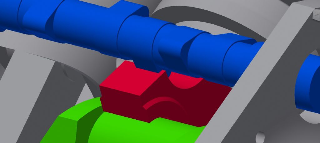

Hi Guys,
While sorting out my lathe I decided to draft the engine up in cad. I have assembled everything and turned it over, only to notice the conrod collides with the lobe on the camshaft.
I make the distance between crank and camshaft 0.5625in, which as far as I can tell is correct, so I am calling on anyone else who has made this engine to tell me where I have screwed up?!

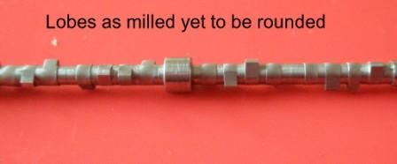

Emgee26/09/2018 21:36:51
2610 forum posts
312 photos
Posted by Emgee on 26/09/2018 20:58:57:
Hi Pete
I am in the process of building the same engine, work to date includes all ally bits and the camshaft,
now on the 4th attempt at the crankshaft !!!!
Are you certain the camshaft is built to the drawings, that is are all cams aligned as per drawing and timed for correct opening periods. ?
Emgee

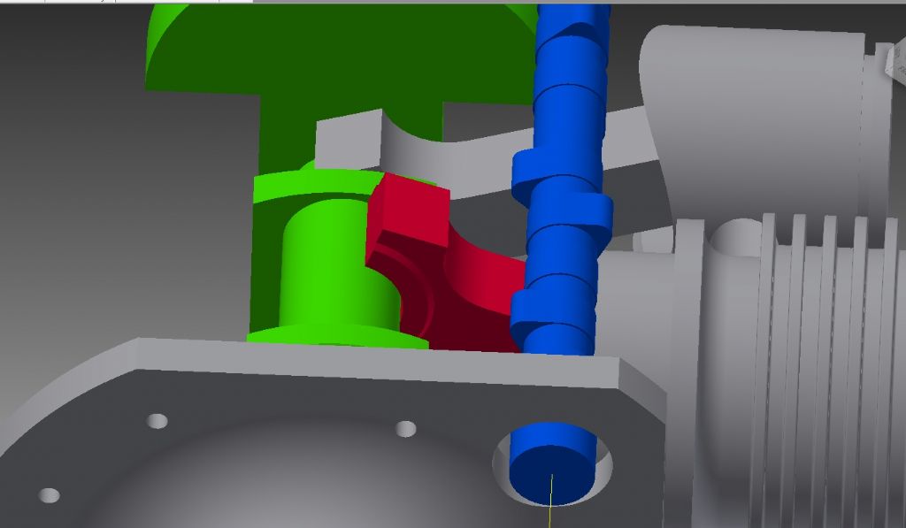

Pete Savage26/09/2018 22:27:46
25 forum posts
8 photos
Here only cylinder 2 is visible but cylinder 1 is at tdc where cams are in overlap area. When rotated around the edge of the conrod touches the cam lobe.
Edited By Pete Savage on 26/09/2018 22:34:28

JasonB27/09/2018 07:03:20
avatar
25215 forum posts
3105 photos
1 articles
CAD is only as good as the info you put in, have another look at the original drawings.
Edited By JasonB on 27/09/2018 07:03:51
Pete Savage27/09/2018 08:40:25
25 forum posts
8 photos
That's the ticket! Didn't notice that, I must have seen it at some point, but I go off and come back to this project quite a lot. Thanks for the help!

Emgee27/09/2018 15:01:10
2610 forum posts
312 photos
Hi Pete
My setup for milling the cams, see note on picture ref ends.

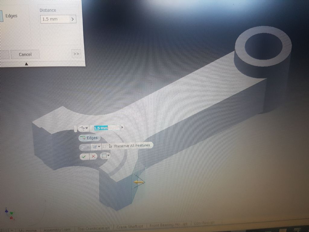

Pete Savage28/09/2018 15:20:21
25 forum posts
8 photos
I think a chamfer of 1.5-2mm on this edge is enough for clearance.
EDIT: It is on the opposite side to in the photo
Edited By Pete Savage on 28/09/2018 15:31:44

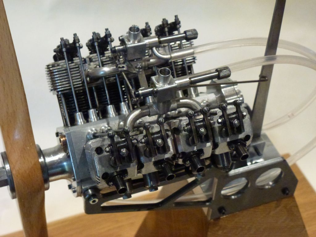

John Roberts 1011/10/2018 18:04:37
10 forum posts
1 photos
Yes I can clarify that relief on one side if the con rods is necessary. I attach photo of the finished engine. For me the biggest challenge is getting the engine to run. I have now a power supply which gives correct power to glow plugs and tried a high nitro fuel, but there is air leakage though the valves despite grinding/lapping valves in. The next option is to try more powerful springs and possibly remaking pistons which are taller. The hope of raising compression. I am confident that I have timed correctly. Any one in the process of making this engine take an extra effort to prevent air escaping other wise you will be in the same boat as me.
My attention has now moved on to making the Blackmore Bentley BR2 Rotary engine. I would be very interested in contacting anyone that has made one as I have some questions!!
