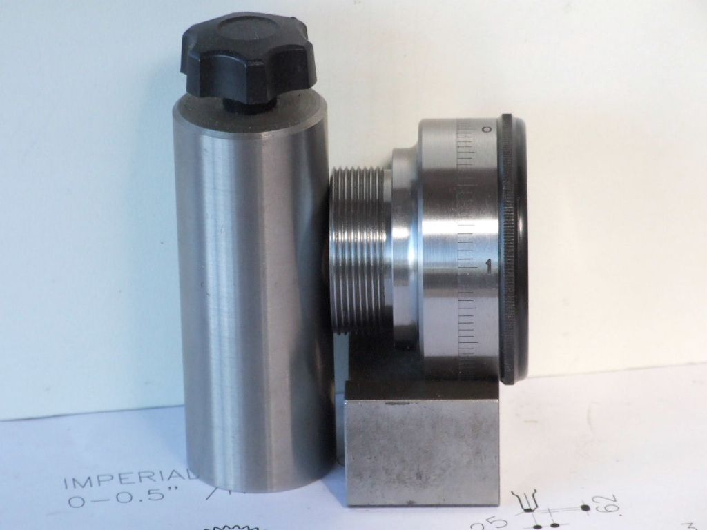

I was recently approached by a member of the Forum as regards had I done anything with the Tailstock dial on the Super 7. My initial answer was no, and that I did not foresee any prospect of doing such in the future. Not owning a Super 7 now would make the task harder.
George Thomas did an elegant solution to this problem some years back. A Tailstock Micrometer, chapter 14, page 160 of the first edition, "The Model Engineers Workshop Manual". While 0.300" per rev is fine for the Imperial user, although a little awkward as regards the tailstock barrel graduations, 1/8 th's. It was not so good when it came to a lathe with Metric units.
As is usual when a seed has been sown, an idea germinates. The initial problem with involving gearing in this dial is the need to keep the Dial small so as not to obstruct the handwheel in use. Normal reduction gearing would lead to an extra large dial.
The Eureka moment came when I was thinking about another problem. Speeding up the initial gear train then reducing it leads to a more compact Dial. Due to the reduction in bearing area on the face of the handwheel boss a needle roller thrust race has been added to make ejecting centres, arbors, etc easier. This is a worthwhile mod without the dial. An oilite bush has also been added to reduce the need to lubricate the bearing after assembly. An annual top-up should be more than adequate.
The metric dial is graduated 0-10 mm per revolution but has an inbuilt error of reading plus on the 10 mm dimension by 0.000127 mm. Over the entire barrel travel this would be nothing to worry about. The imperial version is graduated 0-0.500" and has no error, that is always assuming a theoretical pitch of 0.300" to start with.
Plans are however in hand to produce an article on these dials. Whether one of the ME suppliers takes up the manufacture of these dials then it is early days. For my part I want no part in this side of things.

Graham Meek10/10/2018 19:34:22
714 forum posts
414 photos
Just thought I would update the forum on the progress of the Prototypes. I have been lucky in that John Slater has produced some lovely 3D images of the Dial conversion. I could not have done this project without his help, KWIL's, and that of Michael M who initially asked if I had done anything about the S7 Tailstock Dial. Which in turn started me thinking about the problem and this attachment.
I have also been told from several sources that the difference between the tailstock Mk's is all down to the position of the Barrel Locking Lever. Horizontal means it is a MK1 and vertical being a MK2.
Regards
Gray,
Graham Meek26/10/2018 18:59:55
714 forum posts
414 photos
For those following the progress on this attachment. This week I have managed to cut all the gears for both versions of the dial. Today the dials were graduated, there are still 4 operations to complete them
The Imperial dial is shown after 5 turns and shows Zero, Although the photograph does not do it justice. The screw driver slot and the slit in the brass sleeve gear are in-line as they were before I started.
The Metric dial reads,30.50 after 4 complete turns, it should read 30.48, and it should read plus anyway because of the gear train.
Regards
Gray

Graham Meek28/10/2018 15:16:49
714 forum posts
414 photos
The dial are now finished and ready to fit to the tailstock, hope you like them. I shall have to wait for a final assembly photograph, but no doubt they will come.
