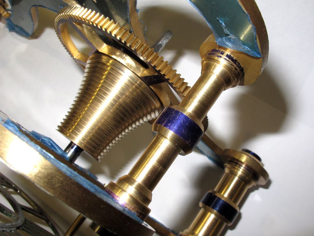

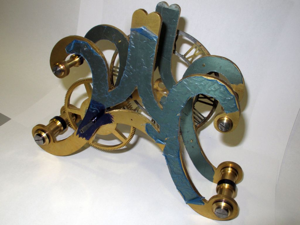

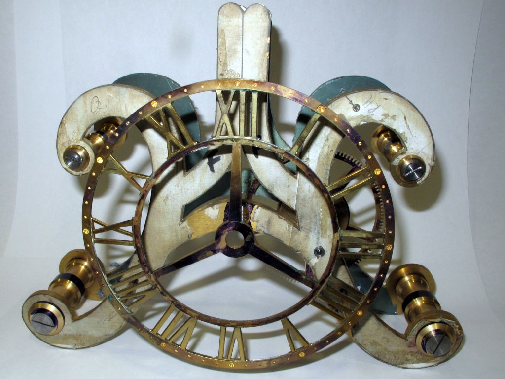

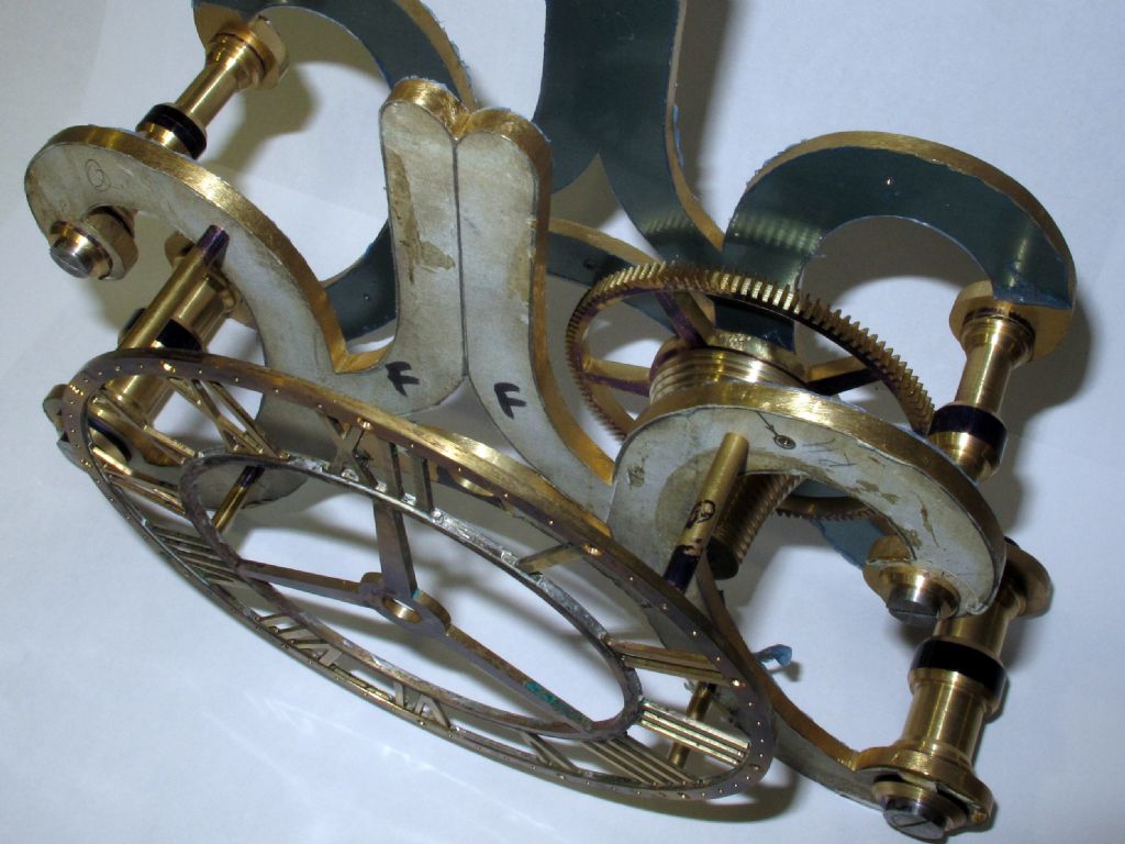

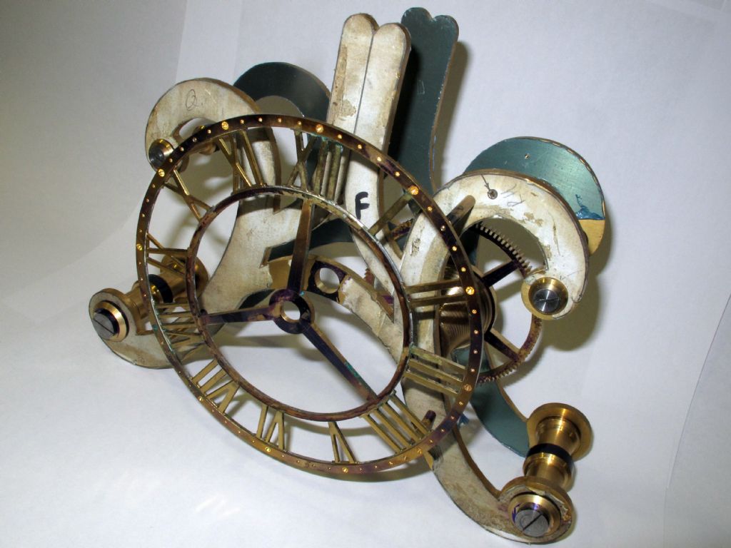

As promised please see current photos of the Strutt clock build to date, I've now also made the main barrel and have that ready to plant in the plates in the next week or so.....hopefully

Marcus Bowman13/08/2019 17:41:40
196 forum posts
2 photos
Andy,
That's good progress, and its nice to see the dial too, as that, together with the frames, gives a real sense of what the finished clock will look like.
I look forward to reading about, and seeing, progress.
Can I suggest you start a new thread for this clock? I think it would be very useful to have the posts accessible to anyone coming to the forum looking for info on the Strutt, or even just inspiration for a project. That post with the photos would be a good start, perhaps even with a sentence or two about the source of the design. I don't know how you would transfer that post to a new thread, but just starting a new one and re-posting the photos there would do, I think.
