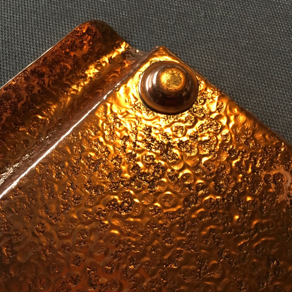

I recently purchased a pretty little tray, in beaten Copper
The majority of it is very shiny, suggesting that it has been polished and laquered ... there may, conceivably, be a plated top-coat.
As you will see from the photo, there are some patches where the surface finish is damaged/missing and the copper has a dull patina in those areas.
Does anyone know how these items were finished ?
... and how I might restore it ?
Note: There is no maker's mark
The tray is of no great value, but I would like to understand the processs.

Martin King 222/08/2018 17:52:51
avatar
1129 forum posts
1 photos
Hi Michael, Have you looked REALLY carefully all over it for a minute 'N' ?
Another pic would be nice..
DO NOT clean it.... IMHO
Martin
Michael Gilligan22/08/2018 18:24:41
avatar
23121 forum posts
1360 photos
Thanks for the reply, Martin
I can find no 'N' ... but there are a couple of interesting design features that you may recognise.
Photos to follow, either tonight or tomorrow.
Michael Gilligan22/08/2018 19:20:50
avatar
23121 forum posts
1360 photos
Colour balance is a bit different for these two !
Distinctive features are
  1. the upper and lower surface patterns are very different, and
  2. the feet are soft soldered onto the underside
Dalboy22/08/2018 19:54:02
avatar
1009 forum posts
305 photos
When i did an copper insert into some of my work i polished it and applied an sander sealer followed by an Acrylic satin finish it still looks as good today as the day I made it. I have cropped a picture hoping it came out OK. The dark patches are from where I heated the copper before beating it and polishing the high spots so it was intentional
