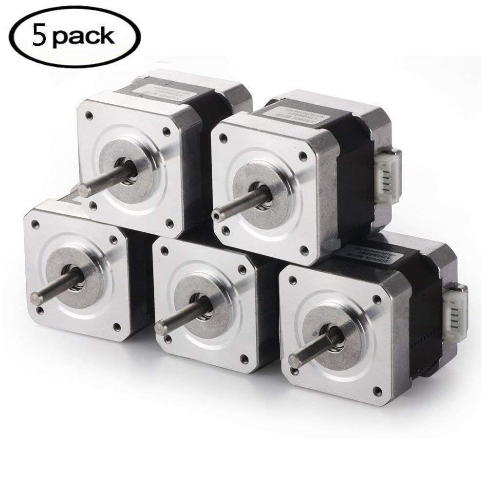

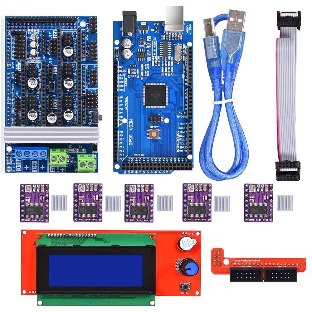

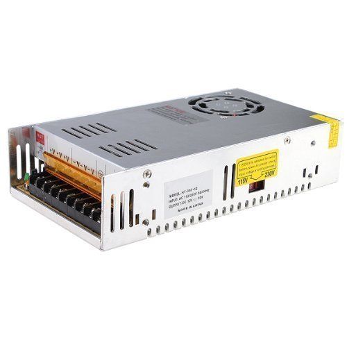

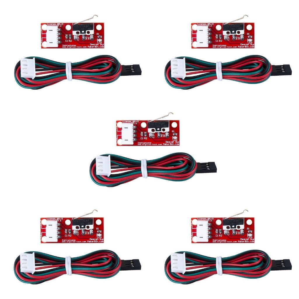

So, after loads of helpful advice I've settled on the following for my project. Its a small tabletop light duty helical turning lathe. Any comments welcome.

Looks like a good way to start John. It already understands G-code (grbl). It also solves the user interface design issues I was wittering about in the other thread because all that is done on a PC. The Arduino gets its instructions off an SD-Card, which keeps that side simple.
My only tiny worry would be unwanted side-effects because it's a 3D printer driver. For instance the firmware might make a fuss if the bed & extrusion heating stuff is left disconnected - the motors might wait forever until a non-existent printing part was up to temperature. Shouldn't be a showstopper - I think it's all open source and hackable.

is that going to be the same with most of these kits?

It shouldn't be too hard to spoof a few signals to use it as is, my biggest worry would be the torque available from the motors. 3D printing doesn't put much load on a motor so small holding torques don't cause a problem. You may need to up the holding torque by either replacing some of the motors with something beefier or by fitting a planetary gearbox on some of the stepper motors. You will only find out if you need more torque when you have got it all set up and start to cut something. I would work on the basis that as the spindle will not need high rpm for your application there would be no problem putting a 10:1 ratio gearbox on the spindle motor from the off. It may be cheaper than a bigger stepper with its own power supply and driver unit. These motors are 40 N.cm which is the same as 0.4Nm. Since people converting mills and lathes to CNC will be looking at steppers or servos with holding torque up to something like 20Nm you can se where my concern is coming from.

Thanks Martin. My machine is scratch built rather than converting something heavier and the capacity is small i.e. maximum 2" x 10" wooden spindle. Nothing needs to whizz around too fast either as the tool movement will be slow like thread cutting on a lathe rather than a gantry router.
So, hopefully nema 17s will be fine....

I don't know, yours is the first kit I've looked at in any detail. (Most people doing mills and lathes seem to either source the parts individually or buy a commercial solution. ) In terms of controlling your lathe it may not matter:
  • Could 'just work'
  • Might need some inputs faked as Martin suggests
  • Might need to hack the software slightly so unwanted printer inputs are ignored
I'd suggest wiring the motors up on a bench and trying it. If you can make them start, stop and reverse with simple g-code, you're OK. If they don't work it's time to find out why and fix it.
Martin may be right about motor torque. I hadn't spotted they're small motors. It's not speed that matters, it's the motor's ability to hold work in position when the tool bites. Embarrassing if applying the tool jams the lathe or pushes a motor in reverse. As Martin says gearboxes will help although they also slow the machine down.
Sending individual lines of g-code to the Arduino could probably be easily done with a terminal emulator. I'm not sure controlling a machine directly is a good idea though. Mistakes are punished immediately! If you mistype and tell the lathe to smash the tool into the work, it will.
I don't have CNC myself, but believe the approach is to either generate g-code from a computer model or write it by hand. Once the g-code exists it can be tested with a simulator, and/or by stepping though the program line by line on a real machine with no cutters. The purpose is to ensure there aren't any collisions, misses, excessive cuts, or inefficient movements. Once satisfied all is well, cutters are fitted and the program run at full speed.

OK - interesting. My strategy to get a kit was that all the components are already selected to work together and as I'm still green that's one less bunch of things to go wrong. However, if I was more confident I would prefer to get them individually.
Sounds like one step and emulation are a safer way to go. I'll look for an emulator so I can start to learn g-code while i'm still building the lathe.
So, is there a way to send your complete G-code to the arduino from the pc without using the sd card?

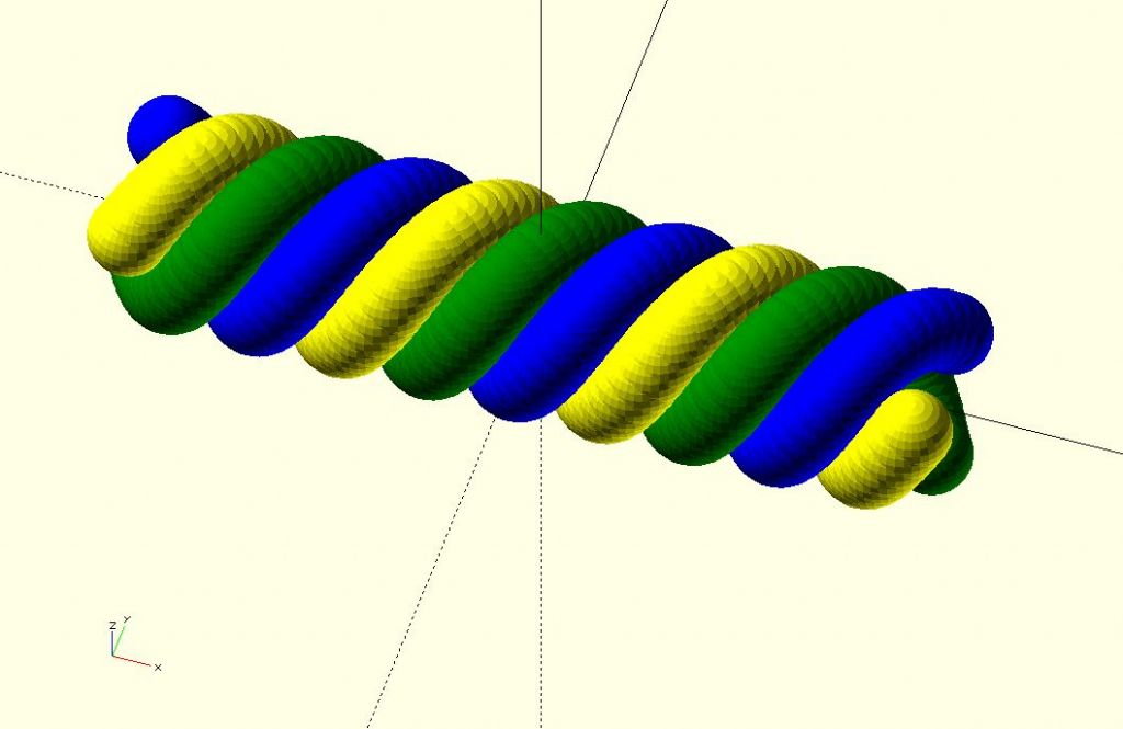

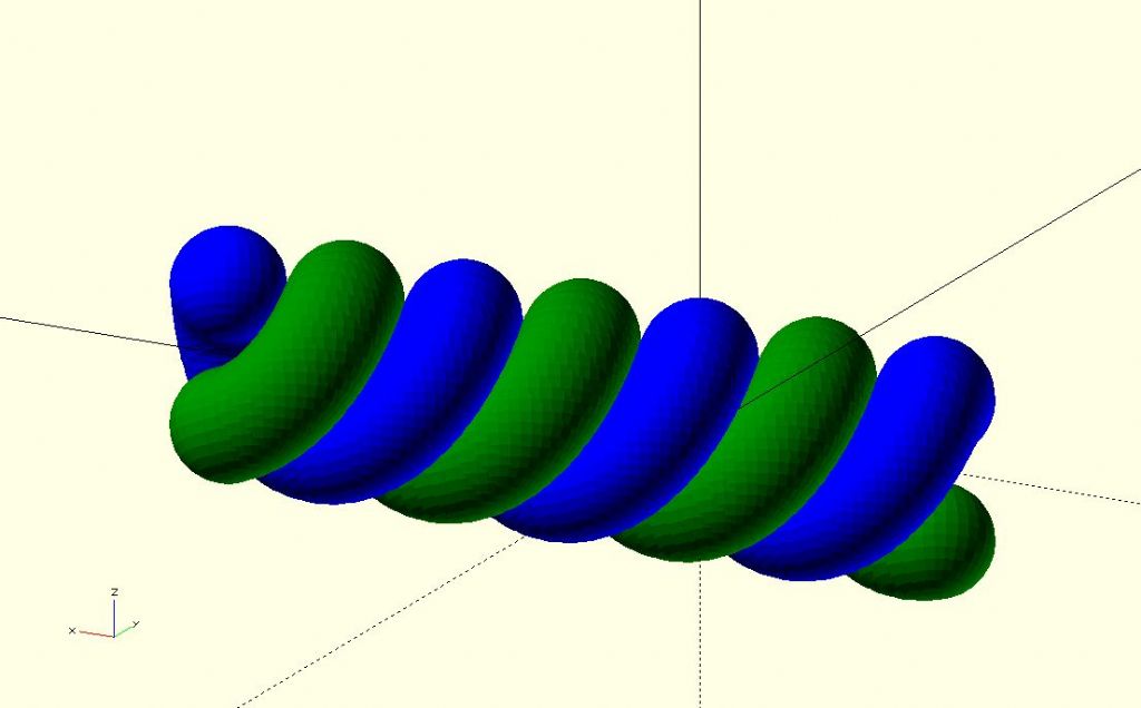

It's just too elaborate for what I need. I just need to move the tool about a bit to guide it to cut turned rope twists. I'm just not going to be doing anything sophisticated enough to justify a complex cad image. I'd like to model it in 3d so I can understand the effect of speeds on pitch types and number of spirals on one spindle etc and just get an idea of what it'll look like.
I did these last night in OpenSCAD in less than hour including installation and learning the basics of the software.

The problem of low torque stepper motors is if they get a small kick when a tool cuts a shaving or bit of swarf they can miss steps. Once out of position they keep on merrily moving things around in the wrong position until there is human intervention or the program stops having produced something that is not quite right. You don't get these types of force with 3D printers, there is no high speed tool spinning around.The other thing is you may be underestimating the amount of force needed to push a work piece and tool together for the cutting action to take place. These motors when used with 3D printers are often driving fine threaded studding which gives some mechanical advantage. Is this what you were thinking of using instead of ball screws? They are not used to push a cutting tool into a work piece either. The Gcode for what you want is trivial don't sweat over it but do get suitable equipment for what you propose otherwise you could be wasting money.
Gcode for a barley twist
G01 X0 Y0 Z0 A0 F50 (Move to starting position. Tool over the centre of the work piece at one end and just touching the work piece. Use A=180 for a second start 180° around from the first and add 180 to the A value below ie 360+180=540)
G01 Z-1 F25 (Move the tool down 1mm into the work piece)
G01 X250 A360 F50 (Move the tool 250mm along the work piece whilst rotating the work piece 360°. Change 250mm and 360° to suit your requirements.
G01 Z2 (Lift the tool away from the work piece)
G0 X0 A0 (Rapid move back to X=0
G01 Z-2 F25 (Lower the tool 1mm more than before to do a second cut)
Repeat with decreasing Z until you have got to the depth you want.

OK, I've listened to all the advice regarding 17s vs 23s. I still think my machine's motors will need very little torque - I can't see a router spindle binding when taking a shallow cut in wood for instance. However I came here for the benefit of your advice so I'd be mad to ignore it. I might also be underestimating the torque needed for my xy table which is quite cheap and, my MKII will probably need 23s and I can move them across.
So, can any suggest a driver/controller board kit that will cope with 23s? And can I mix 17s (where I know there is a low torque requirement) or does that get complicated for a novice?
