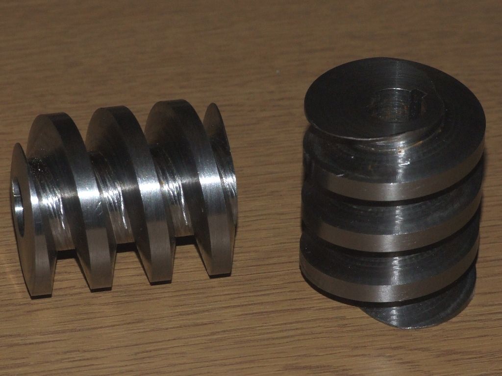

After lots of advice from this forum and cnc zone, I thought I'd update you and invite comments. I decided to build a small prototype to test the principle and 'learn the ropes' and see where all the critical areas are before commiting to a 'MarkII' final version.>>
I'm at the stage now where I'm trying to make sense of driver boards, controllers and arduinos and so on.>>
s a relatively simple thing for turning wooden spindle spindles with barley twists, rope twists, hollow spirals and so on - left hand and right hand. Work size max 2" diameter by 10". It's similar in function to a small metalworking lathe with the ability to cut threads. I'm not using a metal lathe partly because of the cost, partly because i don't need the extra functionality and partly because the changes needed (to the spindle drive and gearing) are proving impractical for me.>>
It's basically a 3-axis machine. X axis for moving the tool (a dremel-type tool) along the length of the spindle in the chuck, a Y axis to advance the tool into the wooden spindle and a z axis which is the rotation of the chuck (slow speeds for positioning not fast for cutting). There will be a 4 th axis for minor adjustments to the height of the cutting tool.
The x and y axes are a small x-y milling table,the rotation z axis is a small rotary table, mounted vertically, and 4-jaw chuck. The 4th tool-height adjustment axis will be a small scissor lift lab table.
.All axes will be stepper-motor driven, probably nema 17 bipolar. I'm still learning about driver boards so I haven't decided on them yet.
So for the front end software, I don't need anything too sophisticated. I'm not sculpting in 3D. I just need to:
rotate the spindle slowly and continuously
move the tool along the spindle at a specific speed
sync those two movement to cut a helix
advance the tool into the work slightly on each pass
I will also need to:
take into account end stops
rotate the spindle c/w and cc/w for right and left hand threads
vary the speed of the x movement during a cut to vary the pitch of the helix in a spindle.(excited about that one.)
A preview of the result would be good bit I think I basically need to enter an x to z ratio (where x might be variable and z might be negative, a depth, a start and end position and an overall cutting speed.
As you can probably tell i'm new to all this so any advice or observation offered will be gratefully received....>>

I still don't think you are going to get a twist profile by moving the tool once along the helix. It will only work that way if the diameter of the toolbit is equal to the pitch of the twist. With a Dremel you won't be able to use a cutter much over 1/4" dia so will need to make multiple passes with the tool moved in X & Y.
Try drawing it in a 3D CAD program and use helical cut to see what shape you can get with a max 1/4" dia cutter following a helical path and you will see how restricted that will be. With a Dremel you really can't use much more than say a 1/8" ball nose cutter with 1mm stepover which on a 50mm dia 2 start barley twist would need several hundred passes all at slightly different X-Y settings which a good controller and CAm package wil sort out..

I hear you Jason. I'm not necessarily expecting to do it in a single pass. Material removal amount shouldn't be an issue as I am using a 550w cutter and on smaller spindles of half an inch I only need to cut down 1/4".
If it's achieving the shape you are referring to, i'll be using bits like the point cutting roundover bit which gives me the right shape profile and they are available in 1/4". Pen wizard do a rope twist bit which is 1/8".

Yep fine for small dia work but not for your 2" dia stuff unless you want more of a spiral than a twist.
It's not so much the power that is the issue it is the chatter you will get trying to take a large cut with a Dremel that can only hole 1/8" dia shank tooling.

One other feature you will want to include is for multi-start "threads" as being limited to smaller cutters you can get a longer helix by using several of them.
Using your 1/4" dia cutter as an example shown as the red profile on the right on 1" dia stock these are the results using 1, 2, 4 and 12 starts. The lower numbers end up looking like a rounded screw thread but as the number goes up so does the pitch until you get a spiral and eventually a twist.

Those look really good, Jason. What software did you use to model them with?
I will be doing multi-start threads and hollow threads and also variable pitch threads. All your models seem to use the same width tool for the same thickness of helix. I'll need to model with different widths.

I'd consider a subtly different approach.
Consider moving the tool in and out to create a 'cross section' of the twist, then step along, changing the start point by an appropriate amount of twist and repeat, and repeat and repeat...

That is what I have been talking about with a 1mm or so step over. Not sure which would be best either running along the length or round and round with teh tool going in/out.
Woud be nice if one of the CNC boffins could model a spiral like I drew and then put it into CAM and simulate the toolpath to see what way the machine prefers to cut the shape.
John, I drew it in Alibre but you should be able to do the same with Fusion 360 which is free.
This is the file for F360 if anyone is upto it

I think you'd need a pretty expensive CAM package to get it to generate sensible code, at least for what is effectively a 4th axis mill. My expensive CAM package only goes up and down and round in steps, or round and round and down in steps in 4th axis mode. Neither of which is ideal for generating helices. When I needed to machine a helix:
I wrote the G-code by hand. The basic helix code is simple:
G01 Xxx.xxx Axxx.xx Fxxxx
Slight offsets for individual passes were worked out on graph paper. I had all sorts of issues with feedrates, and ended up using inverse time feedrate, G93. The final finish is dictated by the tool rather than the code:
Andrew
