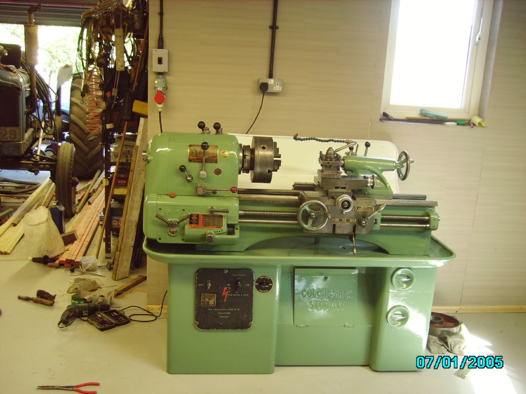

I am afraid I am in east Yorkshire, but if you have any questions, just ask! I have just rebuilt mine, and slid it into its new home, post a picture of your lathe up. Do you have a manual, and is it a Mk1 or Mk1.5?

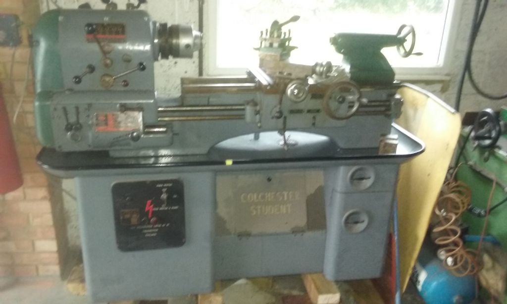

Thanks for responding, that's lovely. Mine is a MK1.5, I have a PDF version of the manual. My primary problems are , How to check the headstock bearing, and how to replace the main operating lever spring as it falls under gravity so has to held in place whilst working. The manual show a spring but I cant work out whether its buried in the head stock or some where behind the reserving switch can on the back. Once found where can I find a spring as spares availability seems hit and miss and in some case very expensive.
Nick Taylor 228/05/2018 10:52:37
102 forum posts
Hi simon, that looks like a Mk1 to me. What makes you think you need to check the headstock bearings? I would just change the oils, fix the lever spring and get making things on it - I’m sure you’ll discover any problems as you go!

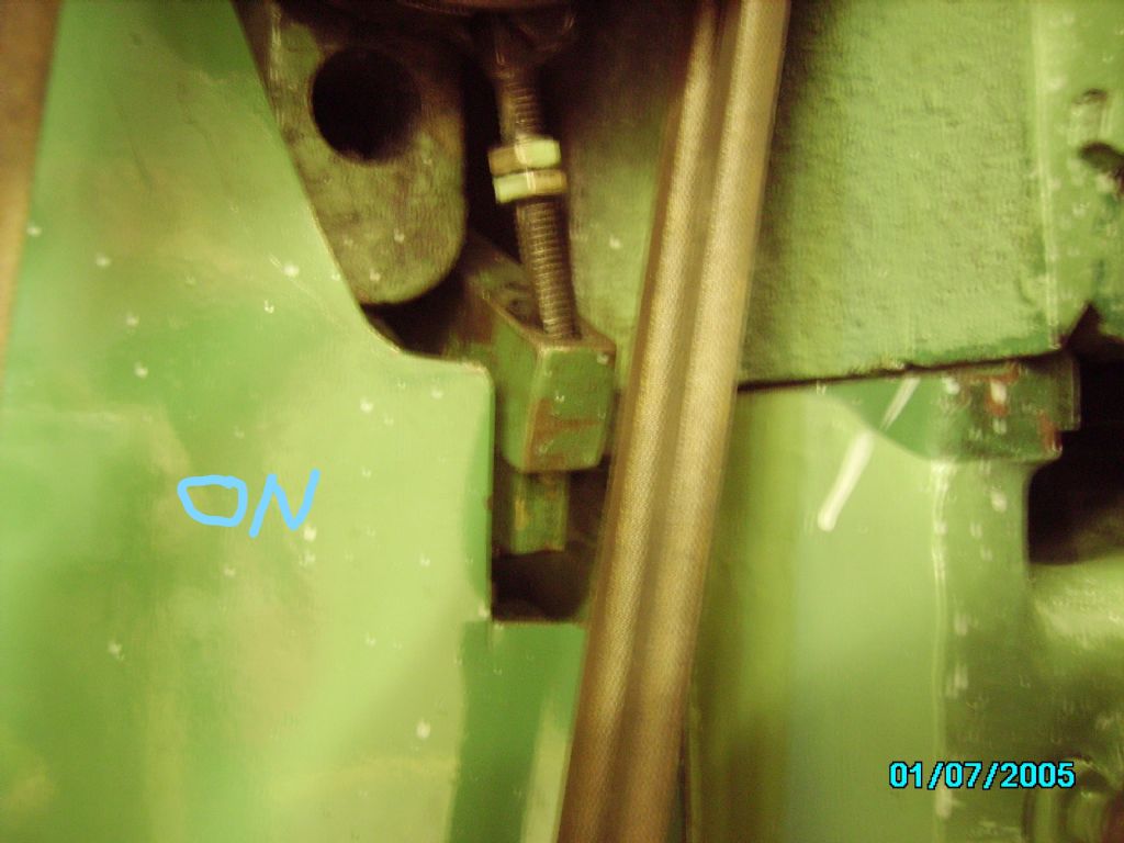

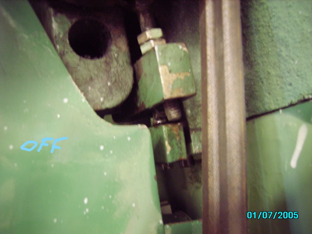

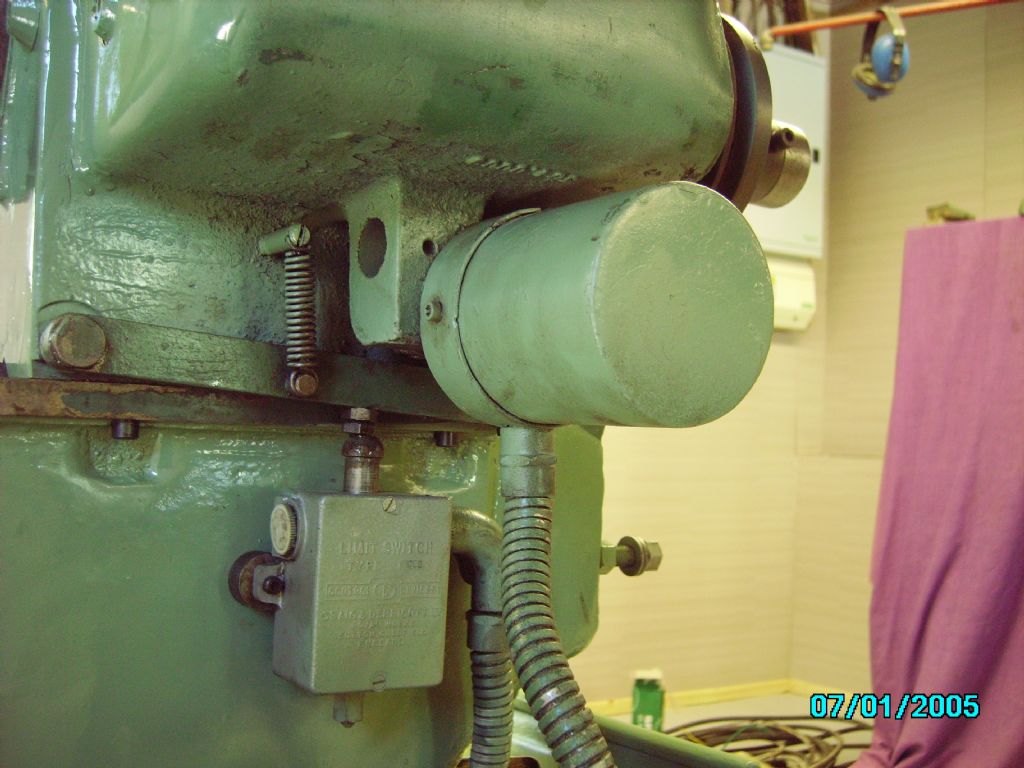

Hi Simon, You mean the lever with the reversing lever in the centre of it? I assume you do. when lifted up, it turns on the lathe motor, when pushed down, turns the motor off, and when pushed further down, it applies the spindle brake. It is not buried in the headstock, it is all on display at the back of the lathe. The round enclosure contains the reversing switch, and the square one is the on off switch. the lever with the spring on it operates the on/off switch mechanism, and at the other end is a second lever which has a slot with a threaded shaft running through it, with two locknuts on which is the adjustment for the brake. where the two levers contact is a pair of teeth, which is the locking mechanism which holds the control in the up position. I do not have a pic of this, but I will take one tomorrow when I am back at the shop. I think there is another spring there, which actually does the holding up function, but can't remember ( even though I put it all back together only just over a week ago!) on the bearing front, provided the bearings are not totally shot, you can adjust them. place a bar in the chuck with about 18" sticking out, put a dial indicator on to the top of the chuck(if you have one) and then try to lift the bar, can you feel ANY play, if you can, the bearings need adjusting. Colchester headstocks are noisy, and the tool riding up over the work sounds like it is not set on the centre height of the lathe. The point of the tool must be set as near as possible to the centre line of the work. If you put a centre in the tailstock, and move it up to the tool point, you can set it quite accurately by eyeball. That is a very nice looking Mk1 gap bed, the mk1.5 has the later apron control for sliding and surfacing feeds. you can get lots of info from www.lathes.co.uk/colchester Any more questions, just ask, I will be back on tomorrow night with a pic of the other end of this mechanism If you take the end cover off, there is a triangular plate which is held in position by an allen screw into the neadstock, and two allenscrews at the other side of it, which attach it to the cabinet near where the vee belts come through. if you take this off the spring locking mechanism is behind it.

it is not actually behind the switch, it is at the other side of it. Best way in is to remove the two knurled nuts holding the end cover, then the blanking plate, you may be able to do it without moving the lathe, you may even find the spring is there, but has come off! good luck with it. I found on mine that the on/off lever was fouling the reverse mechanism, so that the reverse lever moved when you operated it. I loosened the clanps on the on off lever, and pushed it a bit further on to the splines, which increased the clearance, and cured the problem.

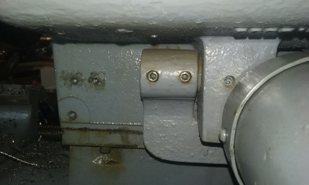

Thanks for all the interest, The good news( I think) is the issue that I thought was the head bearing was actually the 6 bolts the hold the headstock to the bed were loose. I have checked the head bearings with a long piece of steel and no play was found. Please see picture which shows marked differences from Phils. Mine lathe has a Matrix clutch so doesn't have the brake so I am still no nearer in where any spring to hold the control leave goes. Anybody? Simon20180529_113236.jpg

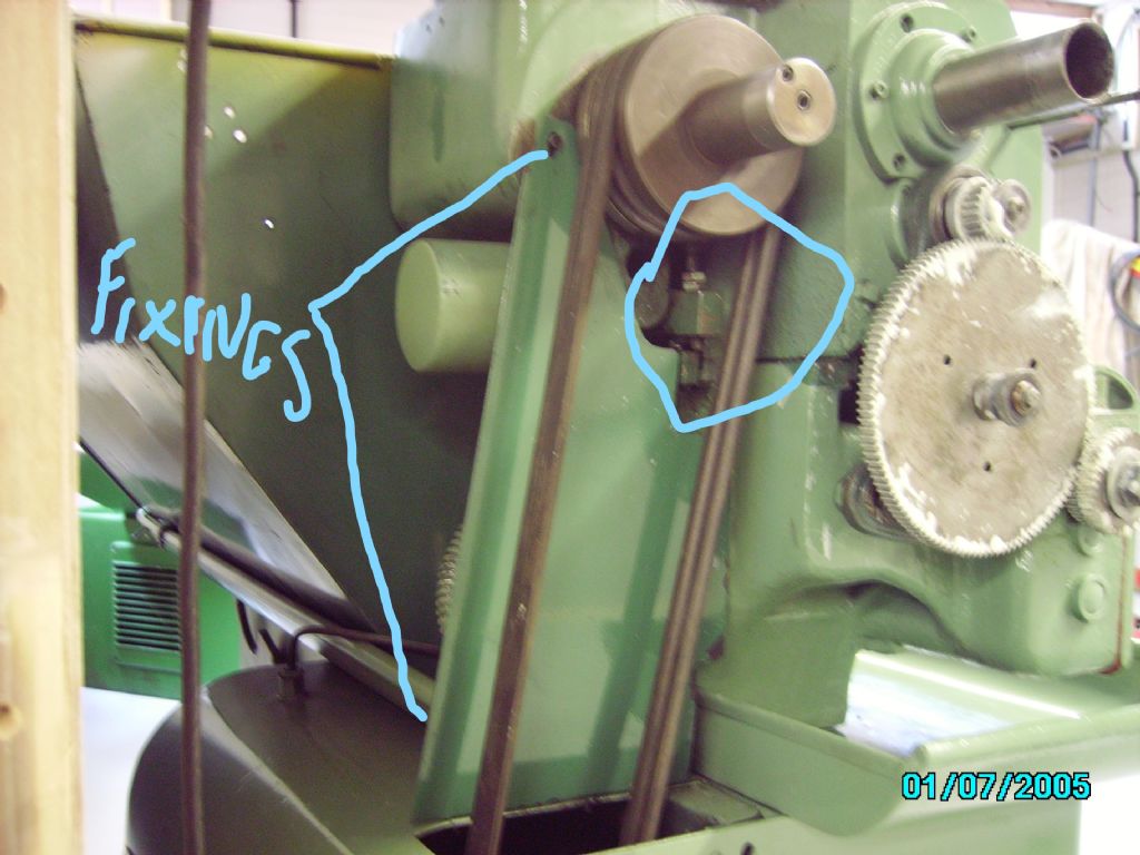

Take your point Simon, it is different, matrix clutch eh! real nice extra to have, is it single plahse or three phase? I will post these pics for reference anyway. I would take off the end cover, and the triangular plate, if you have one, and have a look in that end. It looks like whatever mechanism yours has hides behind it.
