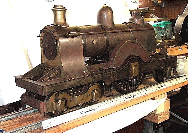

Bob Clare 101/05/2018 00:50:55
6 forum posts
4 photos
First attempt to add photo to posting. Did it work? if so I'll try sending the others i.s. the oscillating disc valve set up.
Hopper01/05/2018 01:09:00
avatar
7881 forum posts
397 photos
Yes, pic looks good. Looks like an interesting project.

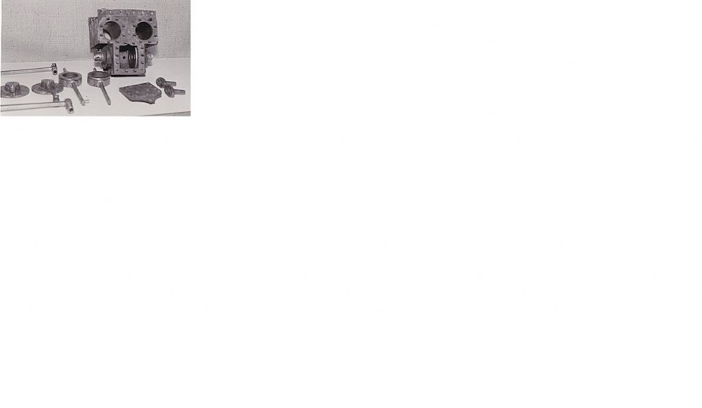

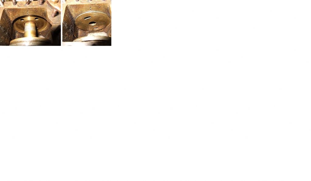

Bob Clare 101/05/2018 23:59:52
6 forum posts
4 photos
Here are 2 shots of the disc valve components (I hope!).eamus valves displayed.jpg
IanT02/05/2018 15:01:24
2147 forum posts
222 photos
A very interesting vintage locomotive Bob, so I thought I'd 'Bump' this thread back into visible space...
But some more photos of the engine would be useful too - an 'underneath' shot of the engine might help satisfy my curiosity as to how this actually worked!

Bob Clare 103/05/2018 00:41:12
6 forum posts
4 photos
Ian I'll need to mount the engine upside down in some sort of cradle to take the photos you suggest. I'll have a go tomorrow. In the meantime here's a shot of the dismantled steam chest with the valves beneath in place which might help a bit. Do you know whether one can upload video shots onto the forum? I've got some action clips of the early trials to see if the wheels would turn at all. They did under 40psi air both forwards and backwards.

Intriguing looking engine, though I can't quite figure how the first two pics relate to the last one you posted. Either way, never seen anything like it in my limited model loco experience.

It looks to me that the cylinders are actually conventional slide valves but the valves are round instead of rectangular. LBSC used round valves on his Ayesha. The last photo shows the round valves connected to the valve rods.
The round parts that I think you are thinking are the valves are actually the port faces and the ports are curved to match the circular valve. The large central hole is the exhaust port Are you sure that these rotate? It's possible that the port discs were made separately for ease of manufacture and remain stationary once in position. I can't see a reason at the moment why they would need to rotate. Are there grooves under the port face to connect the ports to the steam ports drilled in the cylinder?

John, essentially you are quite correct. The only "oscillation" occurs when the reversing gear in the cab is used; this rotates the discs so "oscillating " was the wrong term to use. Sorry about that but I'm only a simple microbiologist.
If you look and the coloured image in my 1st. May posting you can see the external part of the mechanism first with the fixed face in the block with the rotating disc removed and second with it in place. I failed to take appropriate shots of this and I've now reassembled the steam chest complete with pistons, valves etc. In the black & white shot the valves can be seen and these are recessed to take an inner circular component which is spring loaded from beneath to keep the face in contact with the disc.
This system avoids all the set-up problems and engineering requirements of Walschaerts, Baker etc. systems. It works OK on air but under steam? I don't yet know.
