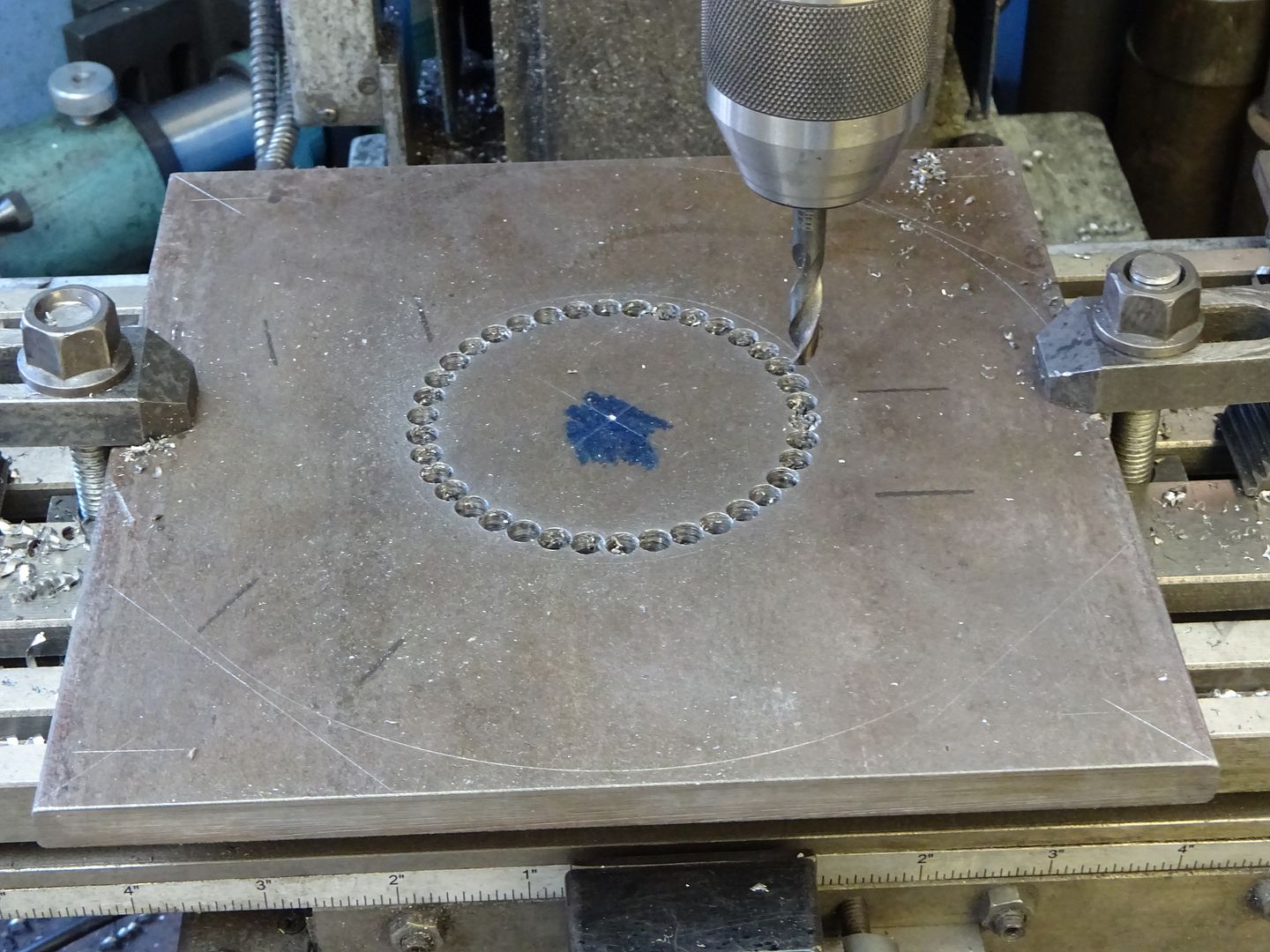

More than a bit odd, positively bizarre! On my DRO (Newall) a PCD is enter centre co-ords, enter diameter, enter number of holes and start angle. The next button push gives the location of the first hole and so on. It'd be a right royal PITA if you had to take into account the actual start and/or finish angles. If I want a large hole I often get rid of the waste by drilling a series of slighly overlapping holes just inside the final diameter. They are usually odd numbers in the range 30 to 40. So start/finish angles would be non-integer numbers.

As for odd angles when stitch drilling circles I just divide 360 by the number of holes and subtract the answer from 360 to get my ending angle or more often than not see what fits in Alibre and adjust the PCD slightly to suit a common drill size such as 6.0mm and can easily get the angle from that, easy to enter angle to 3 decimal places. Seems to work OK as all that is needed is a tap with a hammer and out drops the waste.

I have also used the PCD technique for drill-and-break-out hole-making, but it seems that there is also the option to use the arc ("R" option on the Easson) which automatically sorts out hole overlap, tool diameter, etc, although you might need to do the job using several arcs as I don't think it will quite manage a full circle. Something I'll try out next time I need to do this.
