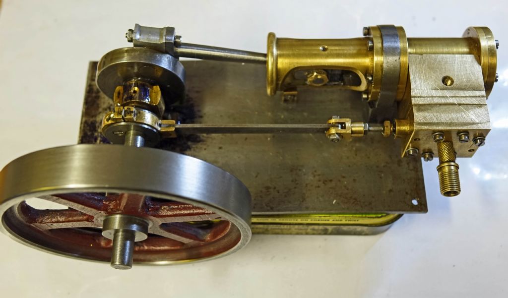

Apparently this may not be a record! Anyway I have now completed it and mechanically it works, but I'm trying to run it on compressed air and it will not turn. The slide valve timing via the eccentric strap has been adjusted so that when the piston is at the far end, the slide valve is at the far end, so that as the piston starts to go up the cylinder the valve will open the port to allow air into the end of the cylinder to complete the stroke. When I add the compressed air (No particular pressure) to the top of the steam chest, it comes straight out of the exhaust port! I have taken the end cylinder cover off and air does come out the port... At the right time?
Does the slide valve timing need to be advanced (like in a car engine)?
Any help would be appreciated.

Have a look at this link for starters : **LINK**

Hi Robbo, Thanks a lot - The original plans by Edgar T. Westbury showed the valve gear at 90 degrees - I thought it was a mistake! I'll have a play tomorrow and report back...

The Link was a great help and I have been able to adjust the eccentric strap to get the timing correct. I have tested with compressed air and it runs quite well...

I knew the Stuarts description was still about, you can read it here if you are still having problems.
Basically if you look at your engine from the flywheel side, have the crank pin nearest to the cylinder then the high (thickest) point of the eccentric should be at about 11 o'clock. This would be for anti- clockwise rotation.
Once this is done look at the valve as you turn the engine over and adjust the valve rod so you get equal movement each side of central.

Thanks again Jason. Yes I have it running now and after seeing your video, I'm trying to upload a short video, via YouTube...
I think the picture here is before I had adjusted the eccentric strap and added the two missing steam chest bolts!
Once I realized that the steam should be starting to be cut off half way on the stroke and be ported to the other end of the cylinder, adjustment became easier. Of course had I been using real steam, that would keep expanding within the cylinder, as the piston transited.
