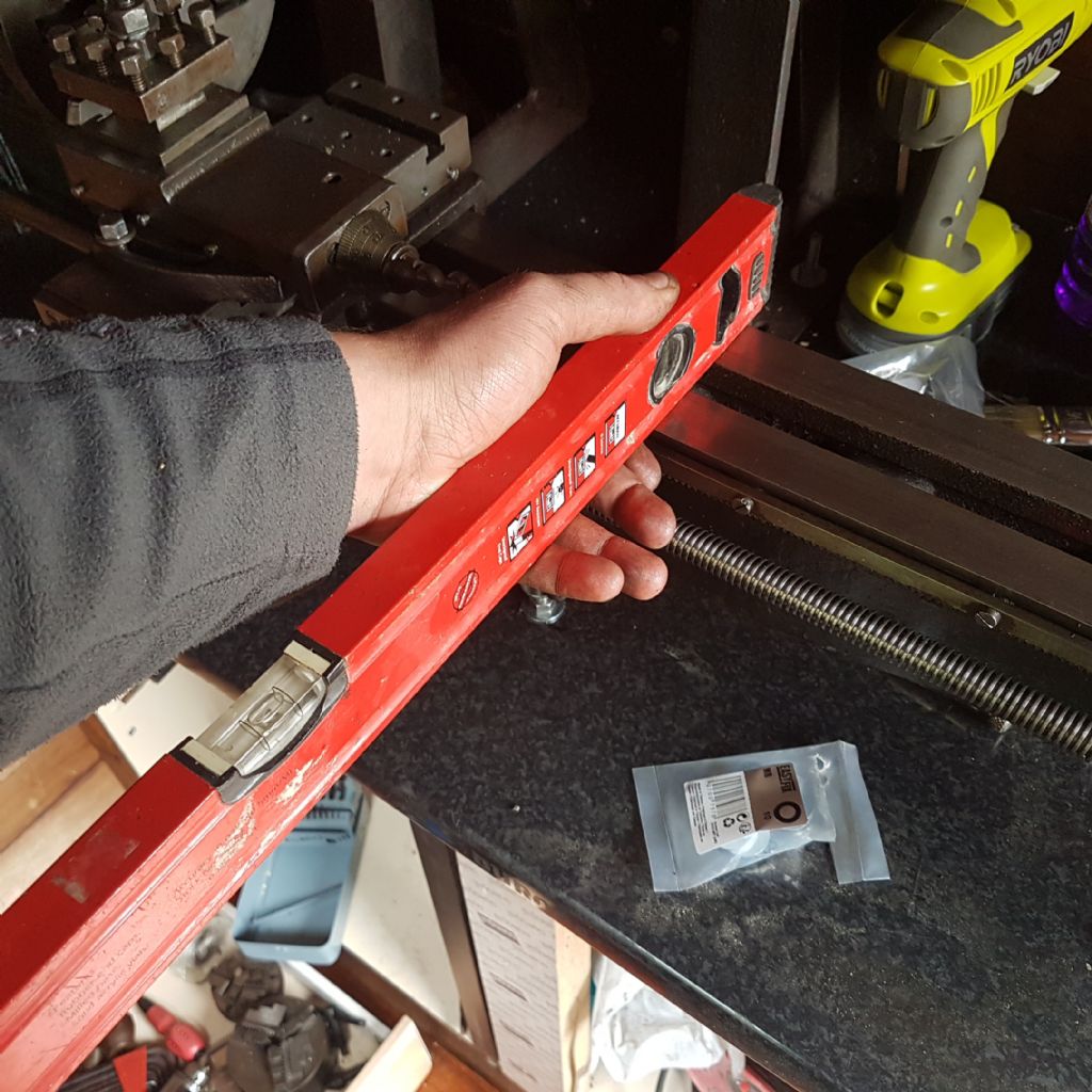

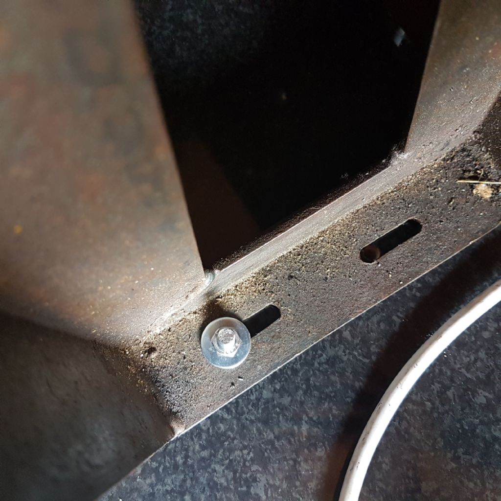

Jon Cameron23/09/2017 00:08:13
368 forum posts
122 photos
20170906_134458.jpg20170904_130924.jpg20170904_140952.jpg20170904_140946.jpg20170904_140937.jpg20170904_140932.jpg20170904_140912.jpg20170904_131051.jpg20170904_131009.jpg20170904_130956.jpgIt came time to set the lathe up and mount the motor and lathe on the 38mm chipboard worktop, and kitchen cabinet I got from freegal. Great place freegal for odd bits of money saving.
I first started with the motor using M8 threaded rod cut to length, and a nut backed onto another nut to form a good lock nut. The position of the motor was selected, with the lathe in situe. So I could gauge what room I'd need to be able to work around the lathe. Once finalised I marked the bolt openings from the motor frame onto the worktop with black market pen. These were then drilled using the cordless, and to the front edge of the markings enabling the motor bracket to move back and forth to allow tension to be set on the lathes belt.
Then once the bolts were passed through and bolted tight, I turned my attention to the position of the lathe, making sure with a long enough straight edge the pulleys were in line. Then again marked the position on the bench and drilled. What I should have done is put some silicone down the holes when putting the bolts through as this would stop oil ingress, and potentially expansion of the chipboard as it takes on oil. (Will come back to that).
The lathe was mounted on the studs (cut slightly longer than the studs for the motor mounting). To allow the lathe to be levelled, or more accurately trimmed for cutting concentric bars, drilling holes ect. Firstly a builders level was used length ways and at 90 ° to the bed, then diagonal from corner to corner of the bed. All the time watching the bubble and making small adjustments to the nuts. To get as close as I could with the level.
