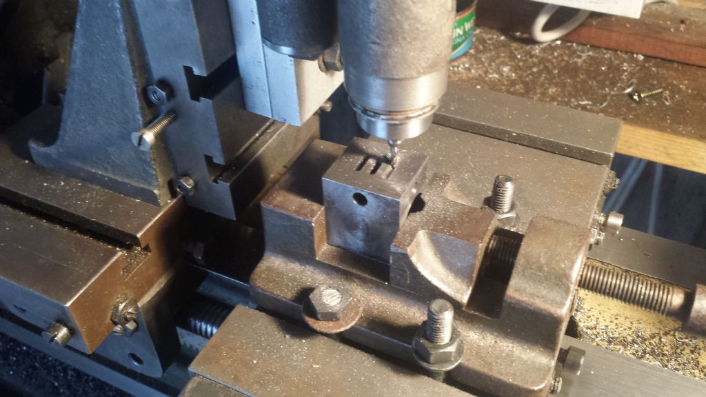

geoff walker 101/07/2017 10:15:53
521 forum posts
217 photos
Hi All,
I've decided I don't need a geared head, just turn the motor through 90 degrees and have a direct drive.
Think I'm on a winner with this, K.I.S.S. is sometimes the best way!!!
geoffpotts spindle with direct drive
