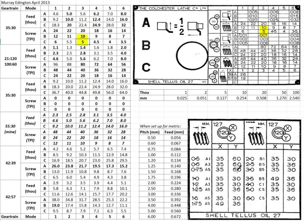

I have a Bantam 1600 but assuming they are very similar, it should be simple enough. Here's is the std range of threads for the imperial model. If you have the metric version, you need the 100/127 gears or similar and there is a different chart on the machine / in the manual.
Do you have the various operating and installation manuals? PM me if you don't. As I said, mine's the 1600 but unless I'm mistaken they are very similar under the skin.

Try this for size, copied out of the manual for my Bantam Mk2.
I saw some comments a few days ago about rotating the pictures, so I loaded this to see if I could rotate it after loading it. Fail. Sorry Neil, you haven;'t fixed it - or more likely I'm too incompetent to follow the instructions!!
HTH Simon

For the sake of clarity, the bit that got overwritten in this post as adjusted above was that the table of threads came from the handbook for my MK 2 Bantam, so it shows how to set up the change wheels for 5TPI as requested.
There does seem to be a little bit of confusion going round - if the lathe can cut everything down to 3.5 TPI as shown in the manufacturer's table, then all those finer threads (of which 5TPI is one) are available. Cutting coarser threads - numbers below 3.5 TPI - might be difficult and certainly needs extra care or a different approach. But a Mk 2 Bantam is a pretty robust beast, and I wouldn't expect to have too much difficulty doing 5TPI on it. Mind you it's a lot of thread to whittle out, it's going to take a bit of patience (and a lot of concentration) to make a reasonable job of it.
