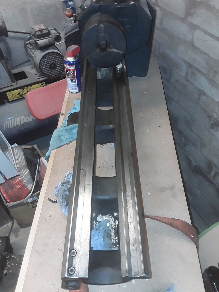

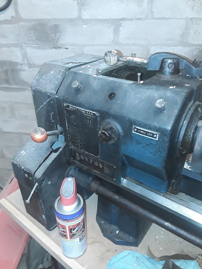

Here are some pictures of its current state. The bed came up well with some 600s and a rubbing block.
