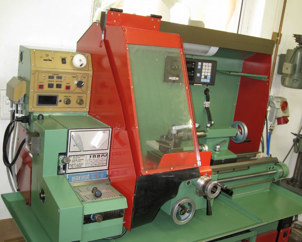

I previous posts I showed the Electronic leadscrew setup I developed for my V10P. My aim is now is to add decent swarf/splash guards to the V10 and my milling machines, and then strip the lathe down completely, re-paint, fit new carriage leadscrew/nut, new headstock bearings, and the reassemble like new! Ditto the FB2 Mill - redo the wiring and fit new X and Y leadscrews and nuts. These pics show the development of the Splash guards - decently sized, from 2mm Aluminium. The lathe is also fitted with a sliding, flip up Acrylic Operator guard.
A mix of Plywood and Ali templates were used to develop the shapes..
The lack of a Guillotine meant using a Plasma cutter, and a Radial arm saw..

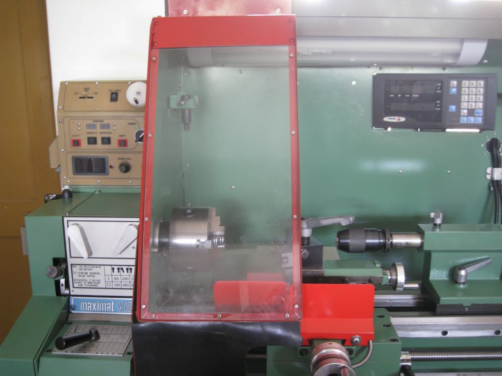

The lathe done, with flip down shield
Flip down shield from the front, slid to the right slightly
Oblique view
From left side - shows the drop side panel in raised position
drop side down to clear chuck key
Integral chuck key holder

Joseph Noci 102/06/2021 10:01:13
1323 forum posts
1431 photos
Goodness, those posts of mine are already 3 years old - downright frightening how time just flies.
Somewhere on this forum I did post the finished goods - all gets lost in time, so briefly again...
some replies to the comments:
Old Mart: That leadscrew on the lathe could do with some protection.
Many folk have complained that It seems I never use the machines - there is never any swarf in evidence...So most know I am sort of an*l about keeping the machine and area clean...any swarf on the lead screw is blasted off with the compressed air-gun before a traverse, each time, with a squirt of oil every other time...And those covers steal Z feed space near the chuck on the V10..
Lukas M : Lukas, by chip tray I presume you mean the tray the lathe is standing in/on? That is part of the stand that I got with the lathe when I purchased it, so no drawings I fear. I can measure it up for you if you want. It is 6mm sheet steel, lips bent up abt 45deg, each lip abt 45mm long. There is a 150x40x8mm U channel under which forms the stand's backbone. The channel is tack welded along the contact points with the tray underside. Ondet each lathe bed foot is 150mmx150mmx20mm steel block, welded to the tray. It appears that the surface of those blocks were then machined flat and co-planar - the bed sits on that with bolts through into the blocks.
Kiwi Bloke Thanks for the kind words - but I am just having fun.. sheet steel if not easily worked with my machines and tools - the bending brake can only do 1.5mm steel, and that is a bit floppy for say the rear panel on the lathe, or for the side covers on the mills - so I would have to fold lips all over, etc - more work! And if I could do 2mm steel, its is so heavy to manipulate, cannot cut with the radial arm saw, etc...I would love a guillotine, and managed to almost succumb to one a half dozen times, but I have no more space in the shops...
