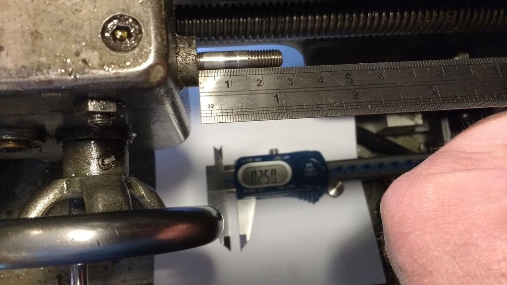

OK so if I am going to do this properly, and before the actual part arrives, could someone please measure how long the hole through the the tread gauge is, and also what the ID is, then I will make a stud with 1/4 BSF on one end, M6 on the other, and then a thumb wheel to match
Allan
Jon Gibbs16/03/2017 11:12:45
750 forum posts
Here's my stud in situ. The stud is exactly 0.250" in diameter (calipers below). You should be able to tell how deep the threaded hole is on your apron perhaps.
Jon

Posted by Jon Gibbs on 16/03/2017 11:12:45:
Link to original image here... **LINK**

Jon
Thank you for that, I now know what tonight's job is 😀
Allan
Jon Gibbs16/03/2017 11:18:20
750 forum posts
Happy turning! yes
Edit: When I think about it, it'd be really strange if the stud wasn't symmetrical end-for-end so that ought to give you everything you need.
