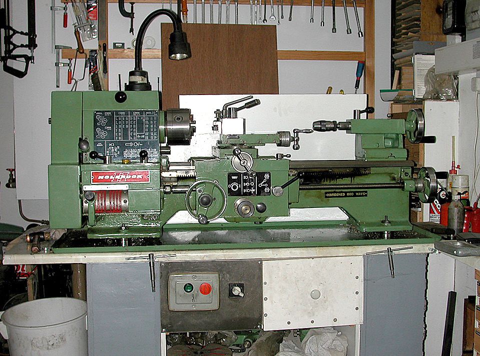

Bikepete11/03/2017 17:38:49
250 forum posts
34 photos
Hi Brian, many thanks for posting those! Very interesting indeed.
I've taken the liberty of embedding one of your pics here for the casual viewer (who might not click a link):
Looks reassuringly solid, as you might expect from Holbrook. Hope it serves you well!
Cheers! Peter
