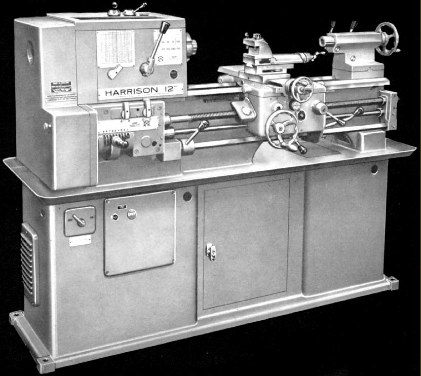

Just to add a bit more info about saddle stops,
This is a photo of my L6 with the standard saddle stop fitted to the bed just to the right of the saddle.
And this photo shows the micrometer saddle stop fitted to the bed also to the right of the saddle.
Both of the stops can be fitted either on the left or the right of the saddle. They butt up against the stops that are fitted to either side of the saddle.

ive got something else that came with it il take a photo of it tomoz.a 2"dia cylindical thing with a hole right through it roughly 4" long, and what looks like a slot milled down the side of it.it also has a smaller hole off centre from the main bore, which is countersunk.
looking at your second picture:10" below the '12' on 'harrison 12' on the bottom longitudinal shaft there is a handle with a black ball on it. i havent got this. i have got the metal cylindrical thing that the handle screw into, but with no handle, and no female thread to screw it into.

Thats the second clutch engagement lever, the first being on the right hand side of the saddle. Both operate in the same way. It just means you have to operate the clutch with your right hand, and dont have the option of left handed operation. I don't know if the left hand lever was an option or standard fit. Have you checked by feeling round the back of the round bush to see if it has maybe been fitted 180 degrees out of alignment and does have a threaded hole to receive a lever. A replacement lever should be easily made.
That round bush by the way has a grub screw which stops it from sliding along the square shaft. If that grub screw is loosened and the round bush does indeed slide away from the gearbox, then thats the location that the small ball bearing will fall out from so just be aware if you are fiddling in that area. The ball bearing is sprung and sits between the round bush and the gearbox. It rests in two small dimples machined in the gearbox output flange to provide a way of securing the clutch lever in the on or off position. If you pull the clutch lever up to engage drive and it doesnt stay fully up and the handle drops back down slightly it can cause the clutch to slip. Its a common problem and indicates that someone has taken it to bits and has forgotten to refit the ball bearing that fell out.
