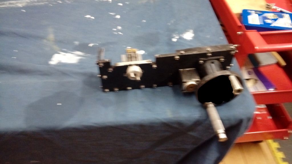

Down below you can see part of what formed the next problem, where the hell do you attach an apron to the lathe? I figured the easiest and strongest way to secure it would be to remove the cross slide, mark out drill and counter sink two M8 sunken socket screws into the apron, this was adequate because it meant that nothing in essence was truly damaged by my workings, and it could be removed if I I didn't want it anymore, my number one rule of modifications is don't do anything you can't undo to your equipment.
lathe cross slide adapt.1.jpgSo now we come to the exciting bit, what I actually made this apron out of. I used a 1/2" piece of T6 aluminium plate, some myford gears I deprived from a potentially caring and loving myford user on an ebay auction that nobody seemed interested in. (got a full set of myford change wheels). and some silver steel bar.
apron view.jpgAnd a close up of the workings.
apron inner workings1.jpgSo I hope the gear train is fairly self explanatory what happens, I took the handwheel from another machine spare I had. That sits on some bearings. The little block you can see to the left of the traverse handle is a brass bearing block, because my pre-prototype proved 1/2" of support for the pinion shaft wasn't enough.
To the far left you can see the disgrace of my build which was a kind of "wrench on" half nut that was truly awful to use. You can ignore that but there isn't a lot of space under there and things were getting dire at that point, the half nut is a slitting saw cut piece of a feed nut from Clarke spares, don't break too many of them as they are a little pricy.

The legacy of all this amounted to bugger all in the end, I've never continued it, why? because in practice it was a bit of a dog in the surface finish department. I found one big problem may have been the gearing was a little too fast, it probably was traversing at about 34mm per revolution. I should note as well that once you remove the feed nut all this table has to hold onto in a cut is the saddle gib, so it's probably swinging from left to right in a very slight rocking motion with every movement.
So what have I learned! It needed more support, a front fixing plate is no match for a full casting which is what most aprons have, the feed nut on the original helps to keep the movement of the lathe linear or straight, it acts as a guidance to give you nice even movement rather than jerking around under load. SO big thing I would do second time is to replace the feed nut with a slide fitting bush, which mimics the form of the original feed nut. This will do wonders for it's ability i'd imagine.
You're probably all thinking at this point how on earth you'll ever get hold of a decent rack and pinion, gawd you're gonna have to run down to the engineering works and get on their case about some cooked up scheme you have. Guess what, you don't need one after all! in essence, you already have a perfectly good rack sitting right infront of you, introducing the wormwheel (courtesy of Wikipedia)!
So You think about it your lead screw can carry a gear (sometimes two one above and one underneath). And advance at the steady pace of 0.6 pitch (you will need a different gear to the one shown so that it's radiused or bows slightly towards the centre of the worm wheel). Ok, it's not a complete gimme, but it's a start and i'm thinking this could forgo a rack altogether, obviously, I've still got one somewhere so that's what I might do if I have the courage to have a go again, but why not take the hint of a lifetime from ol' mike and save yourself some pain/ndrilling to your machine.(Theres a leadscrew clutch on the CL430 so it wont start moving every time you switch it on, should be noted that using a wormwheel would make it difficult to/ or atleast roundabout fashion to install a cross feed mechanism, so in that case a rack would work better, IF you wanted that. I was ever so simply suggesting a different approach to the same problem that could be considered)
So there it is, my dirty secret. I'd ignore the half nut as an act of desperation but there could be some life yet if I gave it another go? Who knows?

Impressive attempt Michael. Well worth trying and you deserved success. Thanks for explaining why it didn't work out; near misses are often far more educational than victories.

On min my Myford, it has rack and pinion for fast moves, but I never use it for cutting. The fine self act feed uses the leadscrew, not the rack. Why don't you just motorise the leadscrew if winding is too hard?

Couple of points. Taig's / Peatols have the rack teeth pointing upwards. The pinion needs to mesh pretty closely with the rack - fantastic swarf trap that can jam it all up. The pinion is carried on an eccentric bush to adjust the mesh. If driven by a gear that could run in one too. On well made lathes the bearings for these shafts are fairly long compared with their bore. I'd suggest 1 1/2 diameters or more. They could stick out of a thin apron and often do on most lathes especially the one on the hand wheel - way more than 1 1/2 diameters giving plenty of clearance for hands.
I can hand feed my Boxford. The saddle moves about 1 1/4 " per rev of the 4 1/2" dia hand wheel. Never measured it before but suspect bigger lathes I have used move further and have much bigger hand wheels. The reason I can probably do it down to being told that I couldn't use power feed for a while during training. It's a 2 handed job just as using the other hand wheels are. One hand is needed to maintain the feed while the other one repositions and so on. I have seen video's of people doing one hand facing etc and find it odd that both me and a number of others found 2 hands is the best way especially if the slides are adjusted correctly. On the saddle the handle is for moving it and the rim is for the feed. I tried hand feeding a mini lathe - couldn't on this model as the wheel was too small or maybe the feed rate was too great. I intended to fit a larger diameter handle.
Myford have used a gear on the lead screw for moving the saddle about for a long long time on some of their lathes as have others. On the ML10's it also serves as a screw cutting indicator. Might be one source of a suitable gear. It's too course a feed for hand feeding really but the handle could be enlarged and the drive to it geared down.
It's possible to make a gear if a suitable tap can be found. Make the blank, gash it at the thread helix angle and then cut the tooth form with the tap as people who make worm wheels do. Info is about on the web. Depending on the size of the tap it might pay to hollow out the periphery of the blank to suit the tap as it will then have more contact area even if the tap is smaller. Flank angles may be a problem but the lead screw thread is likely to be acme or trapezoidal.so if the tap is the same style the flank angles will match. When rack feed replacement gears were made out of mild steel people would often case harden them  for increased strength and greater wear resistance. I used on made out of ordinary mild steel for a while without any problems on my Raglan. The original had broken teeth that had been replaced with a couple of filed to shape pins. Somebody probably used the feed as a slotting attachment.
If you want a crazy idea to think through make a new leadscrew nut and rotate that via a 90 degree helical drive. You'll just need some sort of mechanism to lock it when the nut is needed for screw cutting or feeding.
If you want to use a rack buying a used one of another lathe is probably the best option but it's best mounted on the side of the bed teeth down and ideally tucked under the bed rails to keep swarf off it. Not totally sure but epoxy putty or similar may be strong enough to clamp it down to and get it aligned to the bed. I would have thought that decent sized oblong pads of it would be ok and the fixing screws would keep it in place. It can be tapped just like other materials. If you do this your on your own but it might just work out with a bit more thought.
blush Whoops to get the correct helix angle from a tap the size needs to match the leadscrew. Silly me trying to solve some one else's problems. In my case where I use the tap for a worm wheel it does match. You could make one yourself, hardened silver steel. It wont need many teeth as it will only contact the worm gear over a short distance. They can be gashed and relieved with a hand file leaving a very small "flat" at the cutting edge or milled like that.

I'm sure having seen a lot of lathes you can tell a lot of my ideas are based in myford's designs, precisely because it's a very straightforward system for the same class of lathes. It was too hard to break down the thought process mechanically from a bigger lathe.
I think a new apron could be redesigned using either black steel/or cast bars of iron. It definitely lacks a certain amount of durability and iron seems to make all the mechanisms more stable and smoother to run on, from it's great heftiness. I've changed from aluminium pulleys on my lathe to cast iron and the difference in noise is startling!
It was like as though I was just about getting there with the project and I fell at the final hurdles when it was almost workable! Writing about it certainly does encourage me to rethink it. The gearing just needed to be that much little slower, 15-20mm per revolution would've been fine. And a little more stability around the fixings could've gone a long way to making a clear path to success.
I definitely agree about the rack needing to be upside down too, you're always fighting the offset force of the thing (and the swarf annoyance) otherwise. I would also consider making a pinion mesh that was truly adjustable too rather than totally fixed.
