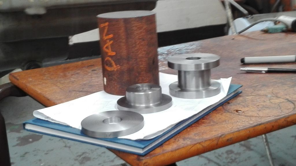

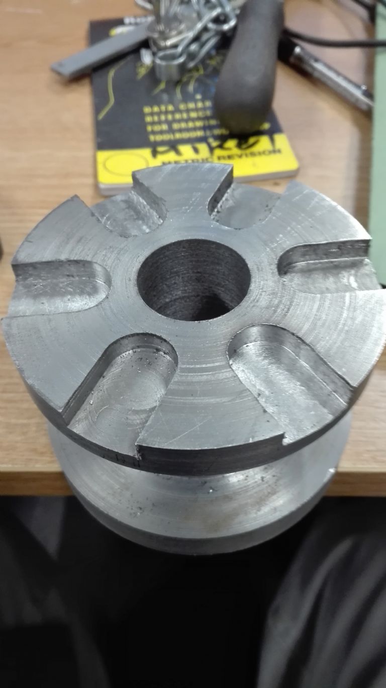

img_20161003_181115.jpgHi just a couple of pics to show I've not been idle. One shows my front hub and covers that have been made from one piece of round 100mm such as the one in the picture. I have since made another one of each from this piece of steel. Another pic shows a hub after I've machinex the slots for my spokes.img_20160918_171606.jpg

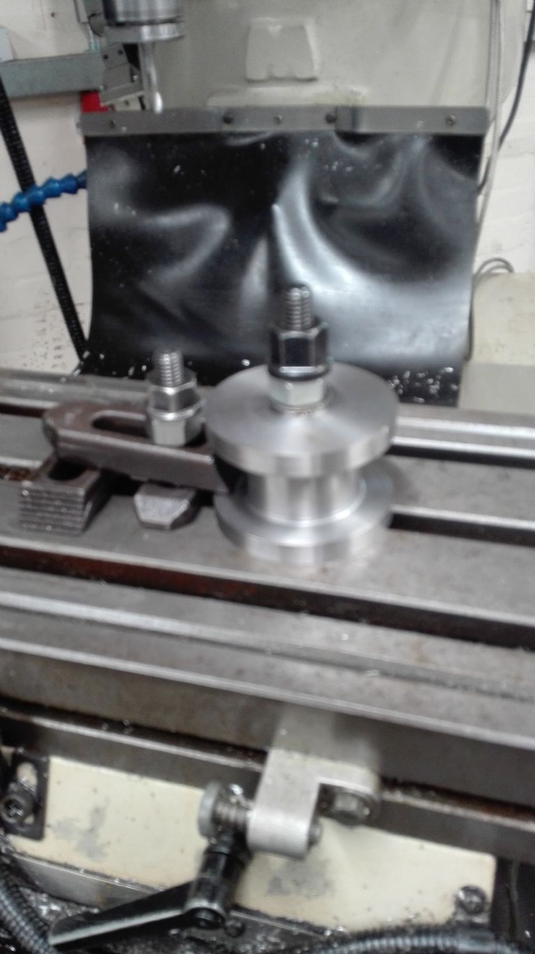

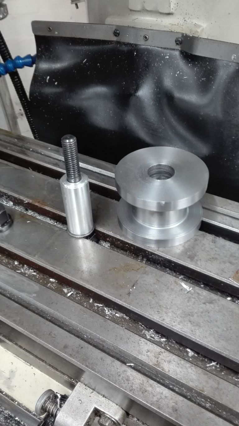

img_20161001_151732.jpgWhen I came to mill the slots for my spokes I needed to rotate the work. Whilst I had access to a rotating table I wanted to try something new. So I turned a dummy axle that fitted the inside of my hub and after drilling its middle out I T slotted it to the bed of the mill. After fitting the hub over it I could rotate the hub through 360° and clamp it in place for machining.

Hi thanks for the replies. I'm aware that most use castings but as personal preferance im going to scratch build as much as I can. As mentioned previously the drawings tend to be aimed at those cleaning up castings so some measurements are missing. As for putting a radius on the edges the 3 parts in 1 picture are 1 complete hub assembly. Obviously the spokes go in the slots of the main hub and then the top hat shaped item is solid and fits on the inside of the hub I have put a radius on the part of this that sits up against the axle. The slim 8mm wide biscuit shaped cover goes on the outside of the hub covering the spokes. Since once the whole assembly is in place and held in situ via a collar it is then covered with a hollow usually brass cover to finish it off. Since the 3 items made so far all mate together I didnt think it'd look right with the hub having rounded corners being mated to other items with the same. Instead all 3 parts were turned at the same time to exactly the same diameter so when they are together it will be practically seamless joins throughout out the whole assembly. Obviously this is personal preference

Mike, it was not the mating faces that I was saying should be rounded, as you say when they are assembled with your favorite epoxy the joints should not be visible under a coat of paint so you need those as crisp as possible.

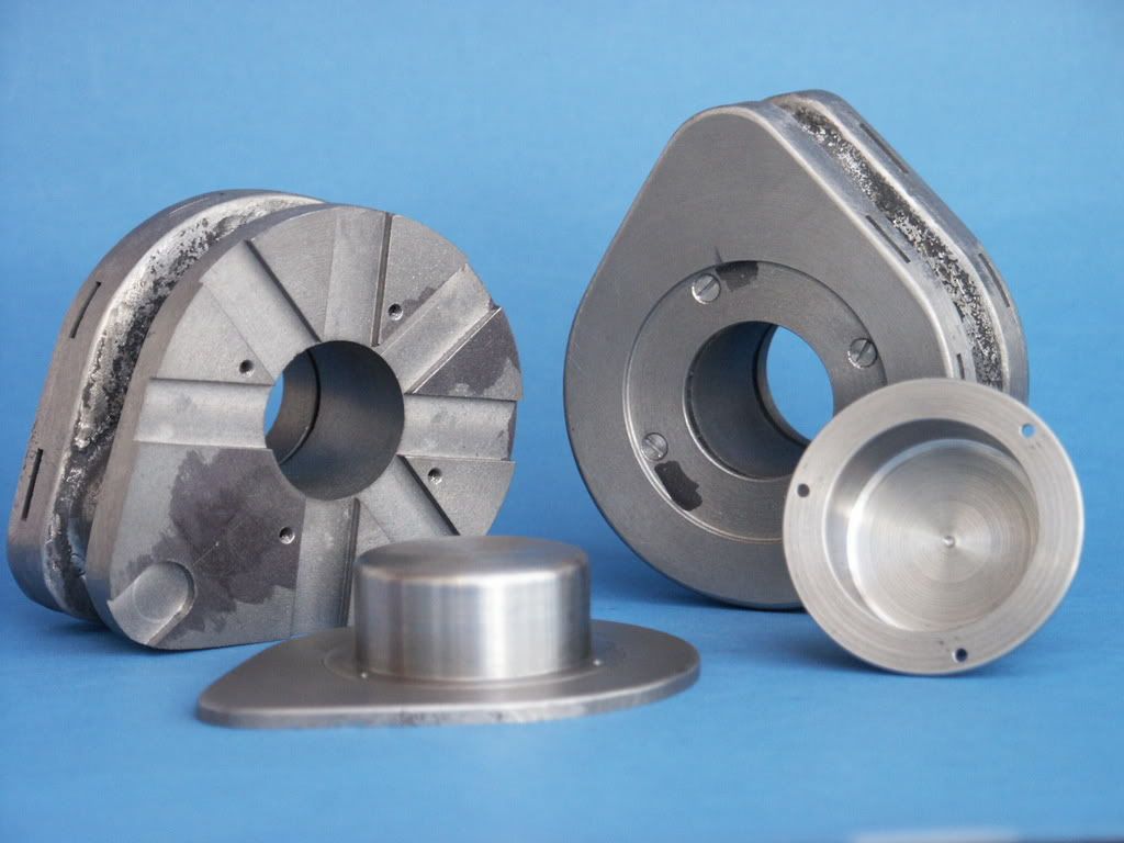

It is the two inner faces and the outer faces of the inner and outer cover plates, Don't have a good close up photo of the front hobs on my Fowler only this part assembled wheel which were also cut from solid but if you look at this one of Paul's you can see the mating faces are square edged but the other external corners all rounded this can either be as cast on teh model hubs or if cutting from solid added with a simple form tool.
