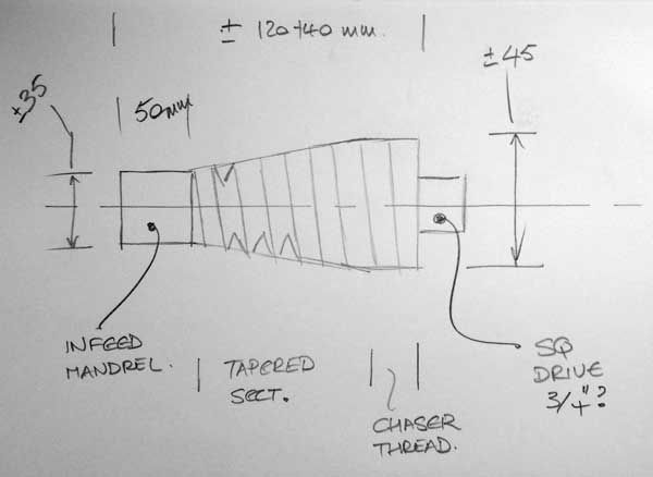

Thanks Martin C - I can sketch this and take a pic, but how do I upload a pic? (do I need some min no of posts?). I have to start with 2 diameters (min and major) as I must buy Forstner bits in std sizes. According to what I have at the moment and some rough sums, I think a 35mm minor diameter and 45mm major may do it. So tap hole is 35mm, die blank (turned hardwood dowel) is 45mm.
I took a 4.6TPI as a guess of what would be good, my current is 4TPI but I think a tads finer would be good - in a vice obviously speed and clamping force are traded. So if 4.6tpi, then my reckoning is 9.77mm diameter difference at 60 degree vee form. I can get 35mm and 45mm, and grind a 45 down to about 44.7 so that would be easy.

I should be able to manage this on my big Colchester. It can go as course as 6mm or 4 TPI. If the tap is for wood what sort of thread form is used? also what material would you be looking to make it from? i.e is it just a high grade steel or does it need heat treatment etc.
Regards Max

Hi Jimmy and Max - i need to draw it properly, will do that tomorow and send or attach here, I see a pic upload button now.
The thread form is not very critical but 60 degree seems good compromise as wood has grain of course and failure will tend to be along the grain. Also it's common to have a small flat on internal and external - the extreme tips of vee do nothing and on the male they just fall off anyway (wood again!)
Re material, a really nice option would be to case harden but all the ones I have used new and old have just been decent steel, not hardened. I'd need to mill flutes on along axis but I can do that (mate with a good milling m/c)
SO, sketch to follow - thanks all for the help, advice etc

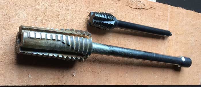

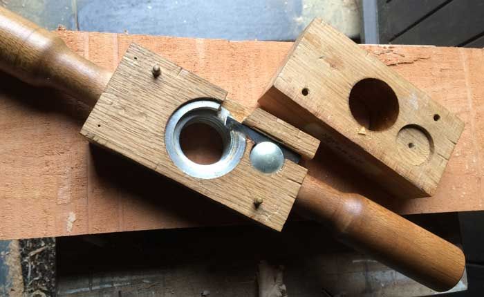

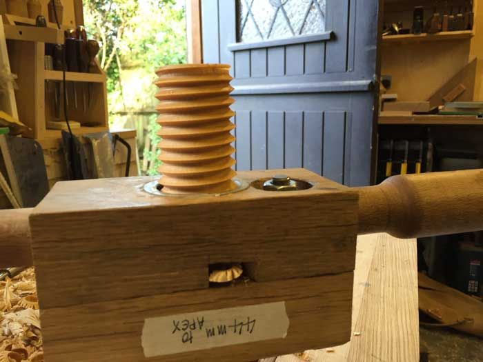

Thanks Hopper - let's try this... resized small in P'shop. Top pic is my custom tap 42mm 4tpi, second tap is a commercial 1" 6tpi that works very well, next pic is the shop-made thread box with ali outfeed and O1 vee cutter. Last pic is box at work into oiled beech. I'm working out the drawing but realised it isn't so simple, if I want small flats (or rads) at the apexes the geometry becomes a bit more complex - to me anyway... drawing soon

here's a rough sketch minus the calcs for precise diameters and pitch
