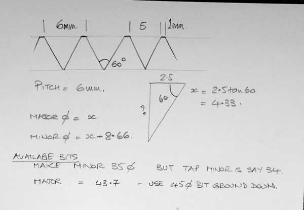

New sums, I checked the current tap which is not exactly 4tpi. I've done a re-calculatiojn as I seem to get strange answers to the 2 diameters. If I set pitch at 6mm but with 1mm flat, the triangle is 5mm, so perpendicular is 4.33. According to that the I/D and O/D differ by 8.66 mm?? I can get a 35mm Forstner for the nut blank, and a 45mm for the vice guide which I can grind down to about 43.7 say. Which bits of this are wrong !!?tap2.jpg

Thanks for all the knowledge and interest - various bits of feedback as far as I know them:
- relief - I didn't make the current tap or guide (I did make the cutter and box) but in these things the cutter depth is adjusted so the screw runs smooth but not sloppy (in the wood nut). I suppoose this has the effect of giving some axial clearance, but it's a bit more crude - pretty much everything is as we are dealing with wood, grain, atmos movement etc.
- the angle is definitely 60 degrees, pic is not very good, but I know from making the cutter
- my sums were rubbish, the current 4tpi uses a 35mm bit for female blank, and a 41mm approx dowel that the screw is cut from. I need to check the tpi, do we talk points or whole teeth?
- optimal tpi - from playing with many different wood screws for vices, I am sure on this one that my 4tpi is a tads steep, 6 is too fine, but best guess would be I'd like about 4.5 - 4.8.
- bad drawing, the thread is cut on axis, the taper creates progressive flats towards the leading end.
- rads and flats - my guess would be make the tap to apex points on the thread, then nick the tops off anyhow. Make the die / thread box so a small flat exists between threads (maybe a mm) - the tip of the screw has no strength and does no useful work.

02/05/2016 09:01:29
here's a rough sketch minus the calcs for precise diameters and pitch

Thanks Martin C - I can sketch this and take a pic, but how do I upload a pic? (do I need some min no of posts?). I have to start with 2 diameters (min and major) as I must buy Forstner bits in std sizes. According to what I have at the moment and some rough sums, I think a 35mm minor diameter and 45mm major may do it. So tap hole is 35mm, die blank (turned hardwood dowel) is 45mm.
I took a 4.6TPI as a guess of what would be good, my current is 4TPI but I think a tads finer would be good - in a vice obviously speed and clamping force are traded. So if 4.6tpi, then my reckoning is 9.77mm diameter difference at 60 degree vee form. I can get 35mm and 45mm, and grind a 45 down to about 44.7 so that would be easy.
