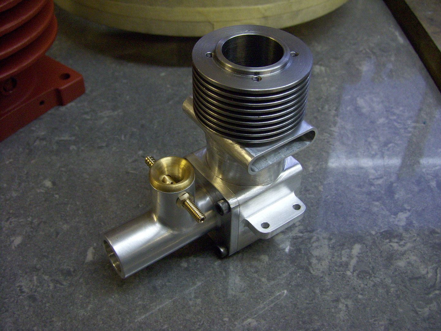

Yes rotary table will be your best bet, take the majority off with a standard milling cutter and then finish with a ball or radius corner cutter. You will have to do some of it in stepps and then finally blend by filing.
Put all the holes in first while its easy to hold and mark out on a rectangular block.
It can be done, for example these two lumps
Became these

MartynThanks Jacob. Beautiful pump. Hope I can get a result half as good.
