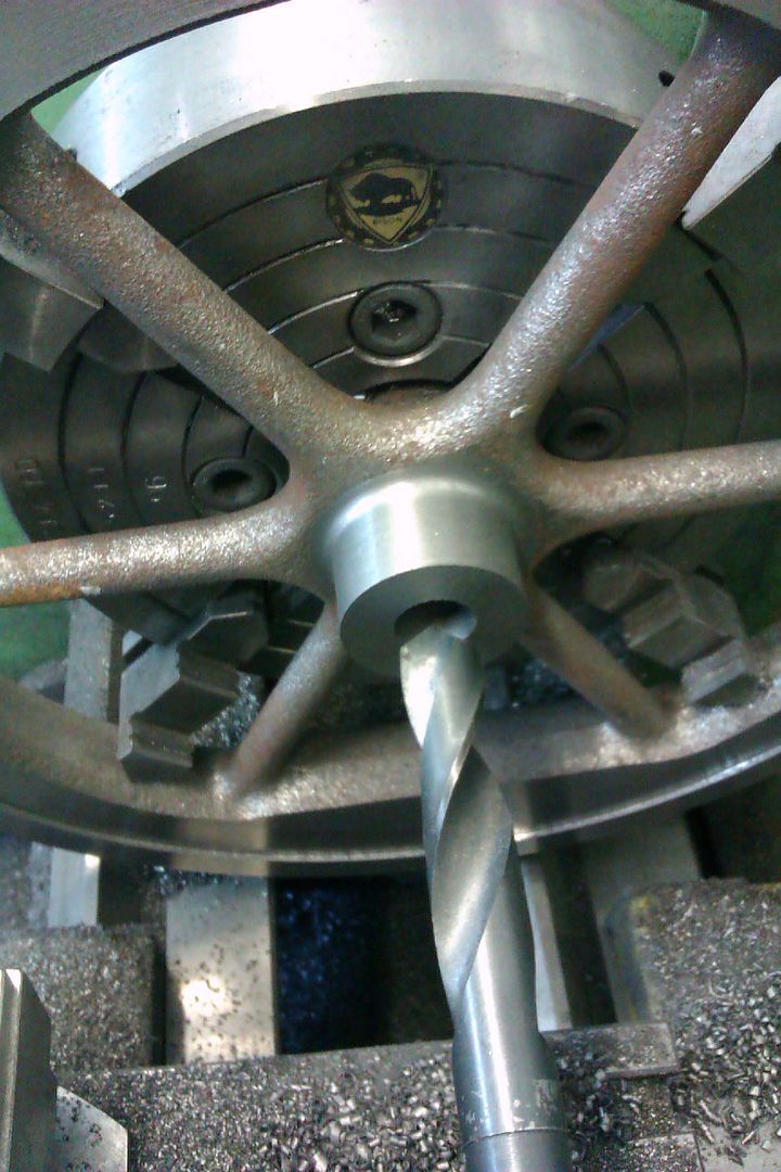

On the Warco lathes the maximum swing diameter is either 180 or 240mm, is that figure actually achievable in practice or is it an unrealistic quote ?
To make flywheels I could envisage needing a full 180mm diameter on occasions but can't imagine myself ever needing to turn anything larger than 240mm.

Speaking from using my 280 which the same will apply to the 180 & 240
As you get near to the maximum swing the two legs of the carrage will get in the way so you have to have a bit more tool hanging out the toolholder than is ideal.
As an example this is a 270mm flywheel, if you look just to the right of the drill you can see it is very close the the rear "V" of the bed and the 5mm clearance would take it upto the 280mm max. Although covered in cast iron swarf you can also see the two legs of the carrage that if taken much closer would hit the flywheel.
This also means that to turn the outsidee diameter you have to have the tool a long way out and the topslide fully extended
So yes they can turn to their max quoted dia but best to treat it as 20-25mm less. having said that its usually only once on an engine you need a big flywheel so not a great hardship, bit different if you were working to the max capacity every day.
