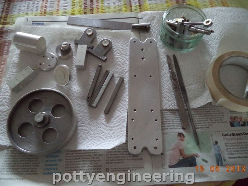

Dullnote28/10/2017 17:38:31
avatar
94 forum posts
29 photos
Hi hope this is the correct thread for this, couple of photos of my attempt to construct this engine, I have never used a lathe from leaving school and I plan on retiring in two years so you can work out the sums.
This is the start of my further education, the engine is still to be completed and is in rough stages, the threaded bar to be cut to correct length, washers added.
May not be to the same high standard I see on this forum, but I am pleasantly please with me efforts, when I get it completed and running I will then spend time making it look good
Best thing about it is, I have had a great time leaning new skills.
Just thought I would share

Dullnote27/01/2018 20:06:04
avatar
94 forum posts
29 photos
img_0788.jpgimg_0789.jpgJust thought I would update, slow but getting there
Jim Nic27/01/2018 20:56:46
avatar
406 forum posts
235 photos
That's looking very tidy Jim. Do she run yet?
Jim
Dullnote27/01/2018 22:57:14
avatar
94 forum posts
29 photos
Not yet still got eccentric to fit. The flywheel does turn the crank around and everything does what it should do but feel unit is tight, think I will need to tweak it a bit to get smooth movement but plan to do that when everything is fitted, hope to get some workshop time tomorrow

Hi Jim
That,s looking good too, best way to shake out the tight spots is to loosen all the screws, then tighten them up one by one any screw that causes it to bind needs investigating and the cause fixing.
Look forward to seeing the completed engines and a video if posible

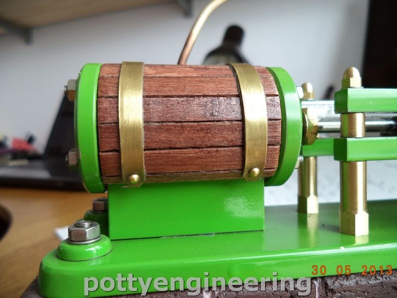

Hopper28/01/2018 11:50:00
avatar
7881 forum posts
397 photos
Posted by Stewart Hart on 16/03/2015 08:08:04:
Stewart, on the brass bands around the wooden lagging strips on the cylinder, are those brass rivets' holes drilled into the metal cylinder, or are they just into the wood?
Also, where's a good place to buy the graphite packing for the piston ring and glands?

Stewart Hart28/01/2018 13:02:06
avatar
674 forum posts
357 photos
Posted by Hopper on 28/01/2018 11:50:00:
The method I used on the brass banding wasn't one of my better ideas I used two way sticky tape the rivets are just dummy, but the darn stuff starts to peal off and I have to press it back down, for the follow on engine I drilled through the banding into the cylinder and used some small M2 dome headed cap screws to fasten it down, you can get the screws from model fixings http://www.modelfixings.co.uk/
I had terrible trouble the first time I tried to clad a cylinder then someone told the trick of first gluing the batons with copydex to a piece of cotton material then cut to shape and fix the whole lot to the cylinder, the batons are coffee sterers.
You can get the graphite from Macc Models or Blackgates but you could use ptfe thread tape that you get from plumbers merchants just twist it into a string and use a graphite packing works just as well.

Hopper28/01/2018 13:08:28
avatar
7881 forum posts
397 photos
Posted by Stewart Hart on 28/01/2018 13:02:06:
Thanks. LOL, trust me to ask the awkward question!
I've used the rolled thread tape dodge I don't know how many times on full-sized steam plant years ago, glad to see at least some of my skills transfer across to the smaller scale stuff. At least it was a step forward from my old boilerhouse foreman's dodge of pulling a string off the floor mop and using it to pack a leaky gland with.  laugh
