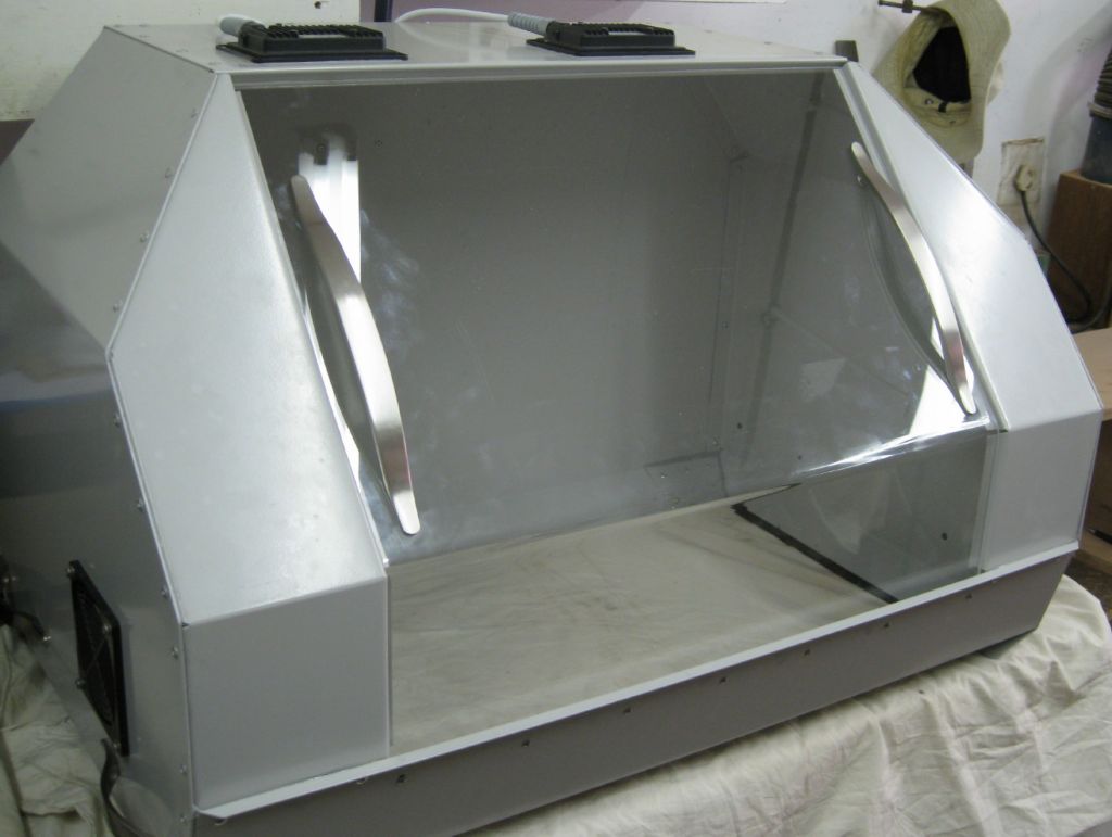

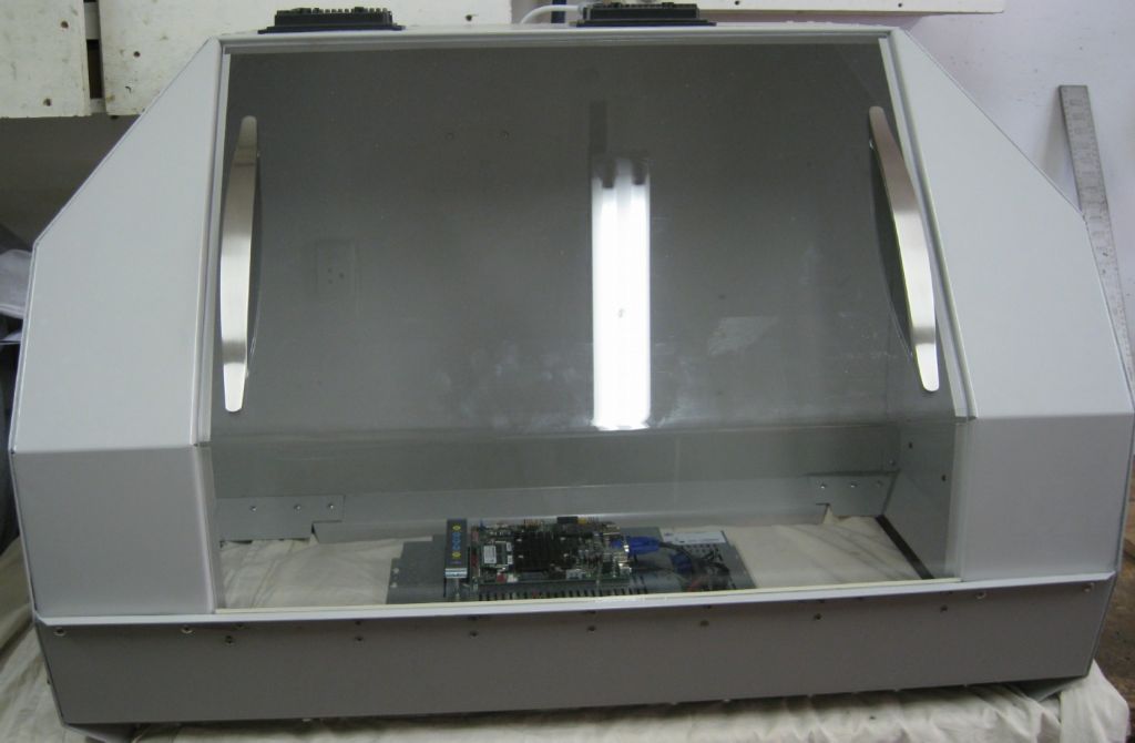

Progress on the lathe enclosure was somewhat hindered by the holidays - Powder coaters , Perspex suppliers, FESTO piping/stopcock suppliers, LocLine suppliers, etc, all insisted on closing for the holidays...
Some have opened, some have supplied and so some progress has been made. Getting close now...

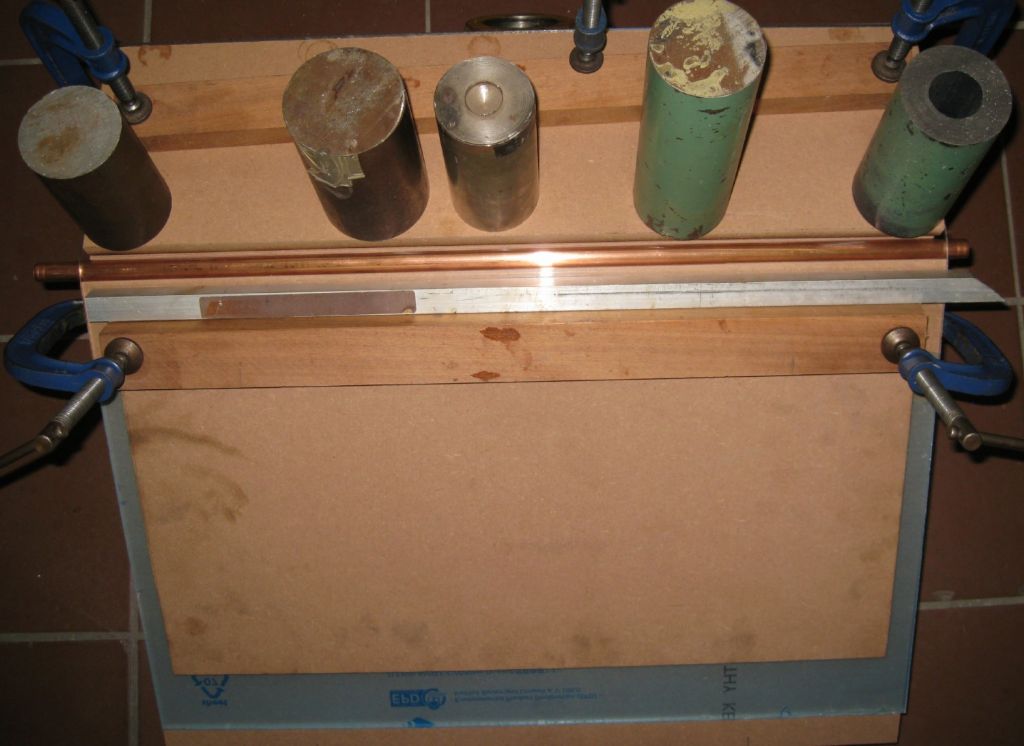

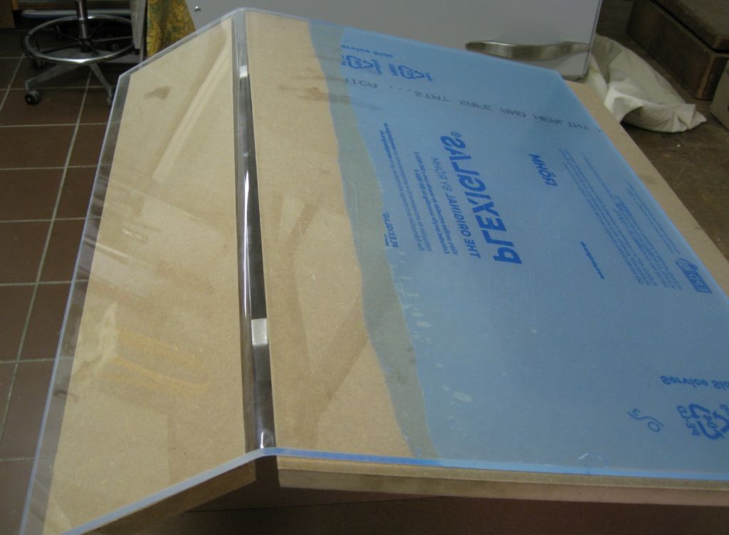

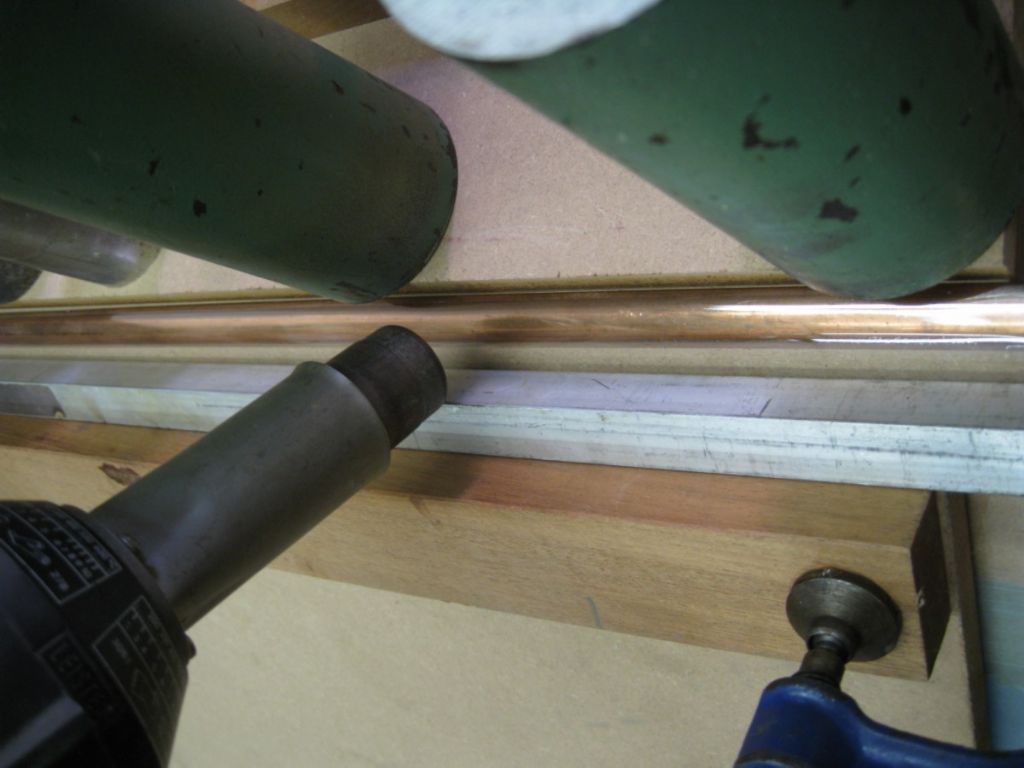

The Splash.Swarf enclosure is complete. All the Metalwork is done, painted and together. I used 6mm perpsex for the window ( no sanely priced 'flexicrylic - the non-shatter stuff - available in Southern Africa - R4700.00 for 2.4Mx1.2M, the smallest available)
This required a 38degree bend in it, so I mad a supawood jig and heat-bent the perspex with a heat gun. That worked very well.
Heat gun heater..
The bent sheet.
Handles fitted and cover located on Enclosure window.
