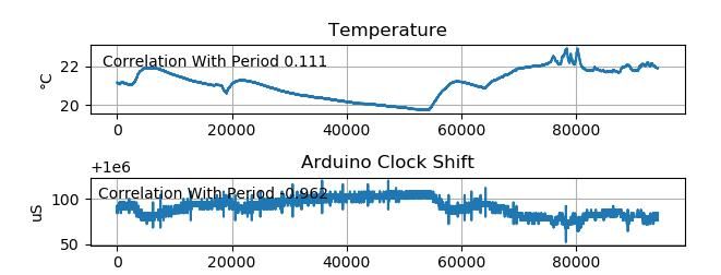

More progress. Running the clock shielded eliminated nastiness caused by the rising sun, and improved amplitude control much reduces bob jitter. (The algorithm allows amplitude to settle naturally at whatever level requires least change: the bob isn't forced to maintain a particular amplitude.)
Although the graphs show turbulence when the heating comes on and people crash about in the morning, the effect on period is much lower than when the IR sensor was being lit up by the sun too.
Sunshine eliminated, there is detectable negative correlation between air pressure and period, and a much stronger negative correlation between temperature and period. Temperature correlation was a disappointment until I realised the link may be due to the Arduino's uncompensated crystal oscillator rather than the carbon fibre pendulum rod. Another point to be proved.
Looking at the stats:
The pendulum is 6.7 seconds fast over 15 hours compared with a DS3621 Real Time Clock, which claims ±2ppm accuracy over my test temperature range.
The Arduino reports ticks averaging 865248µS, whereas to match the RTC they should be 865144µS. This error could be due to the uncalibrated Arduino. (Another proof required!)
The spikes at tick 9000 and those after tick 58000 are due to me wobbling the dining table. The pendulum's sensitivity to vibration is a serious flaw.
Now the clock is running reliably next job is to measure Q. At last. Bet it's low.

One way to get a more precise calibration is to get the Arduino to do a println(something) on each swing and log this with the serial monitor on a PC which has its internal clock slaved to NTP. For example my Ubuntu laptop (which I don't mind dedicating to the task) gives a high resolution timestamp on each record, which you can copy/paste into Excel (or other) for analysis. (This is easier if you switch off autoscroll.)

Latest report. I measured Q. Between 80 and 140, which is dreadful! The implication is my carbon fibre pendulum is a spring, and not a good one either. As the problem is almost certainly the matrix rather than the fibre, I experimented with removing it. No luck with chemicals but a blowlamp does the job. Although carbon might be expected to catch fire, it glows white hot in a reducing flame and survives.
The Mk3 clock will suspend the rod by clamping the fibres at one end, allowing the pendulum to swing on a short length of them. Fingers crossed, removing spring from the rod at the suspension point should improve Q.
I was able to get a feel for the stability of the Arduino's clock relative to accurate seconds from a GPS module by using micros() to measure the time taken between the rising edges of GPS second pulses. One Arduino Nano measures the second as about 1001400 microseconds, the Nano in my pendulum clock is closer - it averages 1 second as 1000090.4 microseconds. Nanos are clocked by Ceramic Resonators, only about ±0.5% accurate and temperature sensitive.
The rig makes it easy to test for correlation between frequency and temperature. The graphs clearly show the relationship with mirror image curves and the Pearson Correlation is -0.962, where 1 is identical.
Would be a result except there's no correlation between Period and Temperature!
Also been looking into Allan Deviation and Variation. Thick fog ahead!

Having made the suggestion, I find that I can get strange results! I thought I had an odd phenomenon where every few seconds the period was significantly slower, but I think this is actually because at the time I had a couple of extra apps open on the Linux PC, one being a web browser (for uploading files to Google Drive) - I thing this was inserting occasional delays into the reported timestamp. Just monitoring time on the dial and comparing with "real" time there's no trace of this. I've used the technique before and found it fine (including on a Pi) so the lesson is to have the only the bare minimum running concurrently.
I think you need a lot more bob mass! Q is omega x M / k where k is the resistance factor. k goes up as bob size squared roughly, M as size cubed.

No comfort from Joe, I have all the symptoms of TimeNut Syndrome albeit on a smaller scale!
My set-up at the moment is this:
Supported with a Frequency Counter, oscilloscope and computer with an extensive scientific maths capability doing the statistics and graphs. Chief flaw is me, because the gap between what I'm doing and understanding it is much larger than expected. As you say 'the more I learn the more I realise that mostly I learn how little I know' : exactly!
Made some progress with Allan though. I've found a Python software module that does the hard work provided I can understand it! I was able to graph white noise and brownian motion.
I understand White Noise to represent a perfect pendulum, one influenced only by truly random variations due to natural noise at the atomic level. The ideal slope is a nice straight diagonal line falling 45° to the right, shown in Blue.
Real oscillators suffer other effects. For example, Invar alloy is unstable over time in that microscopic structural changes cause tiny increases and decreases of rod length. These movements alter the period of each swing causing the clock to go on a random walk that frequency modulates the period, oh dear. The orange line demonstrates Brownian motion which is characteristic of random walk error. Compared with white noise the slope and shape is different.
This and other defects can be detected by taking many samples from the test clock and comparing them statistically with a better one. A promising technique, except toddlers need to learn to walk properly before trying to sprint! At the moment my pendulum has more serious defects.
One thing Joe or another expert might know the answer to? In so far as I understand it, Allan requires me to generate a list of phase differences between the test clock and its reference. The Allan examples assume test and reference are both outputting 1 pulse per second (so calculating small phase differences is easy). Unfortunately my GPS reference is 1 pulse per second while the pendulum is about 0.883 pulses per second. How do I normalise the data-sets?

No, Allan compares the test clock with itself. If you use the TimeLab package you just give it a big file list of successive period readings and it does the rest (IIRC).
Here is an Adev plot of my "Arduinome" clock I just generated to remind myself.
It takes the whole file of which only the first column are period measurements and ignores the rest. So far I haven't really worked out what it means but generally the trend is sort of diagonally downwards though with some flattening off. What the little wiggles result from I don't know. Good explanation here. If you explore that site you can read about Tom's adventures testing General Relativity on a camping trip.

The comparison to a reference is already done by measuring the period. AV is a measure of how the period varies with time.
Agreed, but somewhere in there is an accurate 'clock' is required - and that is the clock that is used to measure the period. THAT clock has to be stable, accurate, etc. So there is the accurate reference...You cannot get away from that - the comparison is not with the clock itself, it is the variation of the clock period against an accurate reference - the timebase used to measure the period.
