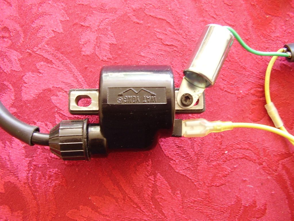

Norman Vant10/08/2012 14:05:30
50 forum posts
6 photos
Hello again,
Back at last! Work and an unruly garden have impeded progress on the Rina greatly. However, some advances have been made and the beasty is ready (at leat mechanically) for a test run - not painted or properly mounted - but ready to try. I still think I need some advice from the sparks gurus, though.
I have sourced some ignition components and the points are fitted to the engine. Unfortunately, there is no room there for the condenser. I am assuming that it amounts to the same thing if I connect said condenser across the coil LT terminals on the coil (they are only at the other end of the wires, after all!?!).
If I can manage to add the pictures to this post you will see my attempt to test the system "in hand" so to speak. The coil is off a small Honda bike and the lugs either side are what I assume to be the mountings and earth terminal combined, since there is only one LT wire. These lugs are sort of laminated metal. Is my assumption about them being the earth correct? The white battery box contains 4 x AA Duracels.
The reason for my doubts is that I only seem to get a rather weak spark at the plug and a much brighter one at the +ve terminal when I break the circuit by hand. That doesn't sound good.
I'd like to get this sorted out off the motor so that I will know that it's one less reason for the thing not to run. I anyone can confirm that this set-up is correct -or tell me why it's no, I'd be very grateful.

Norman Vant10/08/2012 14:12:12

The central bar is a common negative of both the primary and secondary coils, as the chassis of teh bike/car would be negative grouind you can say its the earth.

Jeff Dayman10/08/2012 16:15:09
2356 forum posts
47 photos
Hi Norman,
Good to hear from you again. A few comments re your setup in the pics.
1. The 4 AA batteries may not have enough current to operate it. I would start with a power supply able to supply at least 1 amp. Last year we discussed using wall wart power supplies with at least 1 amp rating at 12 VDC.
2. The plug wire and cap look like the suppressor type which have high internal resistance.The wire may also be a resistor type. Both these items will increase the need for higher drive current. If you can, substitute copper core plug wire, plain metal plug cap terminal and a non resistor plug (ie like a Champion CJ-8 for example) and try the circuit again. Before attempting to remove the plug wire from the coil, pull back the rubber boot and look for mould flash or sealant around the wire. If there is none, chances are the wire is screwed in onto a terminal which is just like a wood screw, down in the coil socket. The screw is intended to make contact with the plug wire core. At least that was the way these coild used to be connected to the wires. Some however used sealant or were moulded in place and these wires can not be removed without damaging the coil, so use caution. As I said if there is no mould flash or sealant, the wire can probably be screwed out easily.
Before altering anything though I would try driving the circuit as-is with more current.
Good luck JD
jason udall10/08/2012 17:21:26
2032 forum posts
41 photos
Err. whats completing the "earth" between the chassy connection of the coil and the plug?
I know the engin will in normal use but in the photos above ???...
Just a thought.
jason udall10/08/2012 17:25:33
2032 forum posts
41 photos
Oh and the AA batteries if ALKALINE might suprise you as to how low their internal resistance is .. so 1 amp might be possible....but maybe not for long.wink
JasonB10/08/2012 17:29:41
avatar
25215 forum posts
3105 photos
1 articles
Jason I suspect the black wire is being touched against the plug body to test the circuit.
J
jason udall10/08/2012 17:39:11
2032 forum posts
41 photos
Batteries might do 1 amp but have douts over battery box ....

Hi Norman,
It is good to see you back again and to know that you are close to having a working engine.
I agree with the other posts: the wires from the battery box look a bit skinny for the current required and you do need an earth return from the plug to the earth on the coil.
The coil is probably designed to work off 12 volts so connecting the setup to your car battery should produce a healthy spark. Then you could compare that spark with the one from the 6 volt battery box.

Norman Vant11/08/2012 14:56:01
50 forum posts
6 photos
Thanks for the responsed.
To clarify a pew points about my quick and dirty set-up: the plug lead is copper - a bit of a surprise in this day and age. The plug is a CM6 which seems to be recommended for this type of engine and others have success with them. Anyway, the rather unusual 10mm thread is already cut in the head, so I'm stuck with it. The plug cap is the one supplied with it and similarly is recommended elsewhere.
To test, using all three hands, the plug body was held against the mounting lug on the coil and the black wire from the battery pack was used to make and break the contact, again to the coil's mounting lug. I certainly got a spark at the electrodes but not as fat as I would have liked. I was assured that the coil was 6V when I bought it - but who knows?
The thing I was unsure about was whether the condenser was connected to the right things and in the correct orientation. I can't fit it at the points for lack of space. Worryingly, I was getting a far bigger LT spark, on make and break, than the HT one.
Like most people, I have drawers full of mains chargers for various, long-forgotten, appliances. However, not one of them is rated above 7.5 V and 150mA. So, not much help there. I may have to use jump leads from the lawnmower, which has a 12V battery and shares the workshop!
What is exercising my mind, looking forward a bit, is the I would like the whole thing to be self-sufficient as a unit (within battery capacity) and a 12V lead/acid battery is going to be completely out of scale and impossible to conceal without mounting the engine on a disproportionately large box, rather than the skid that I had planned. What on earth do other people do?
I had a look a the buzz-coil thread. Loads of references to these on the internet but all written in terms that make my eyes glaze over.

Norman Vant12/08/2012 13:21:06
50 forum posts
6 photos
Jason,
Well, that's that ordered! Should have bought their coil really but it's fiendishly expensive for what it is.
Can you confirm that it's OK to fit the condenser anywhere in the LT circuit between the +ve and ground? I'm out of my comfort zone here.
Regards,
Norman.
Norman Vant12/08/2012 13:55:17
50 forum posts
6 photos
Jason,
I've just had another go with the setup "in hand" using jump leads from a 12V lead/acid battery. Something is seriously wrong! -ve clip on the mounting lug. Yellow+ve feed touched against the +ve croc clip. With the plug held against the earth lug, on breaking the circuit I'm not getting a spark at the plug, I do get a jolt that I can detect with my fingers but not enough to make me jump about. I'm getting a truly massive LT spark from the contact I'm breaking and the earth lugs are getting too hot to touch.
I'm no electrics expert but I have wired a car, from scratch, with no problems (just a headache) and I never came across this sort of thing .
The coil was new and unused from a motorcycle electrics dealer so I have to assume that it is in working condition but what's going on!!!???!!!
Don't really waht to spend £50-odd (with VAT and postage) for a purpose-made one.
Help!
Norman.
JasonB12/08/2012 16:30:04
avatar
25215 forum posts
3105 photos
1 articles
I would go +ve battery terminal to +ve primary , thats the tab on the coil.
center bar of coil to wire of capacitor and to one side of points
Ground capacitor body and other side of points
-ve of battery to ground
